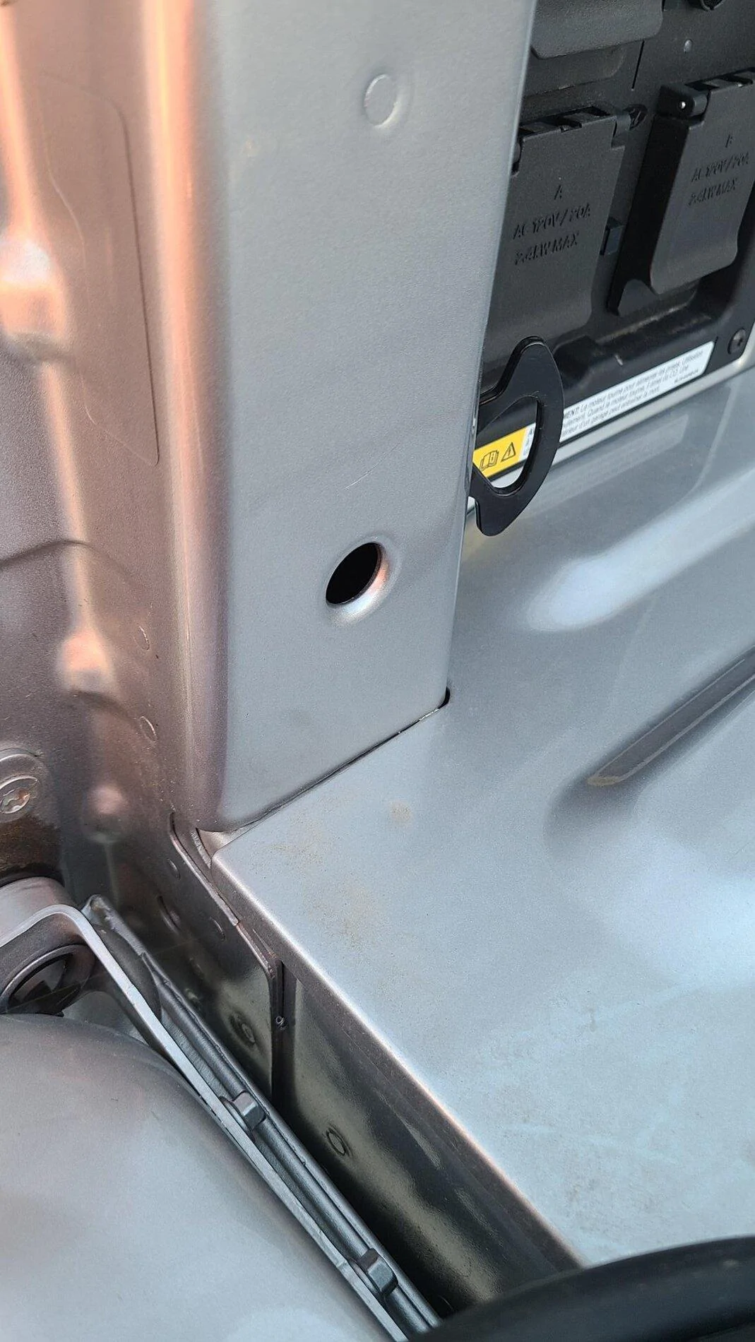

Hello,
I am at the point where I need to mount the waterproof female plug near the hitch on my truck.
It looks like you used big zip ties and secured it around the hitch bar??
Has this held up well for you? I'm trying to figure out a good way to secure it, without having to drill holes on anything.
I converted to stainless steel clamps. Seems to hold it just fine.
Great thank you!! That's what I was thinking of doing instead of zip ties so glad to know it's holding up.
