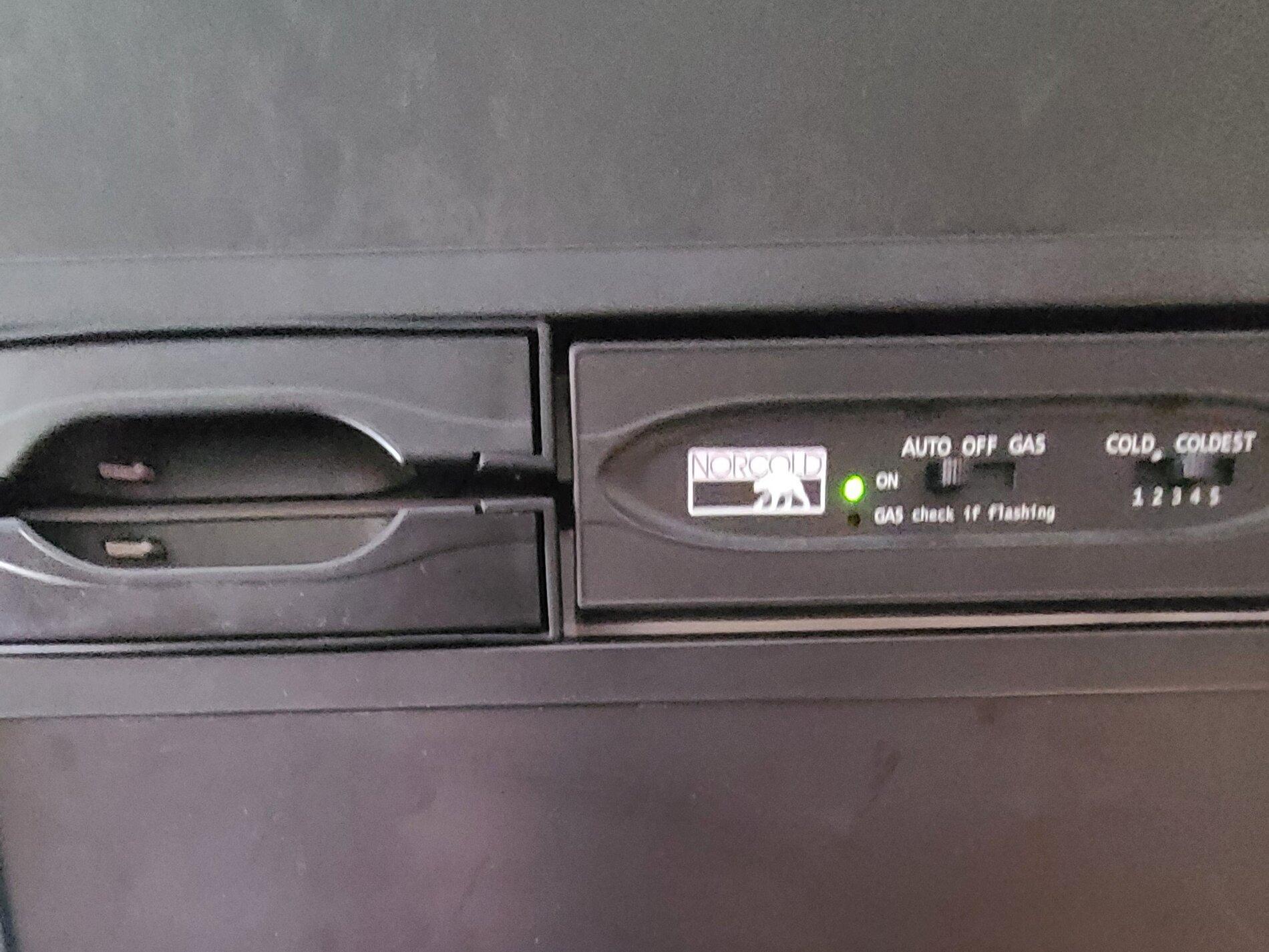

This allows the refrigerator to run without propane, and for an AC battery charger to feed nearly 60 Amps into the lithium batteries I upgraded to earlier this summer! Our batteries were always fully charged when we arrived at our next destination.

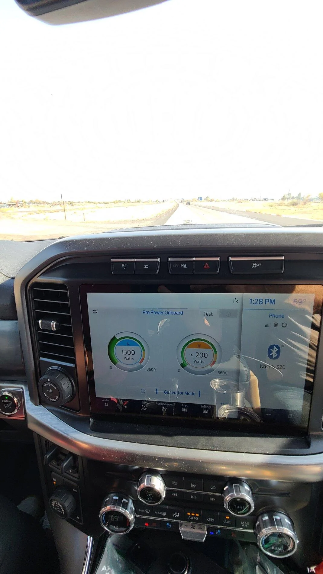

Here's 1300 Watts being fed to the trailer while we are moving down the road:
