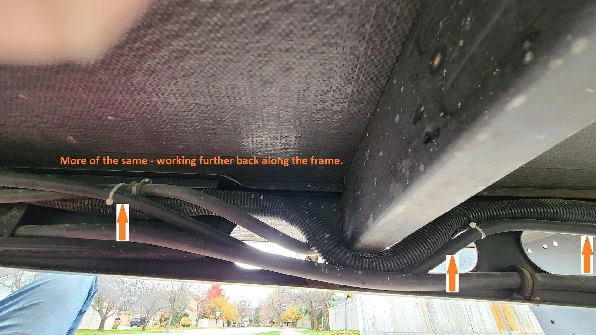

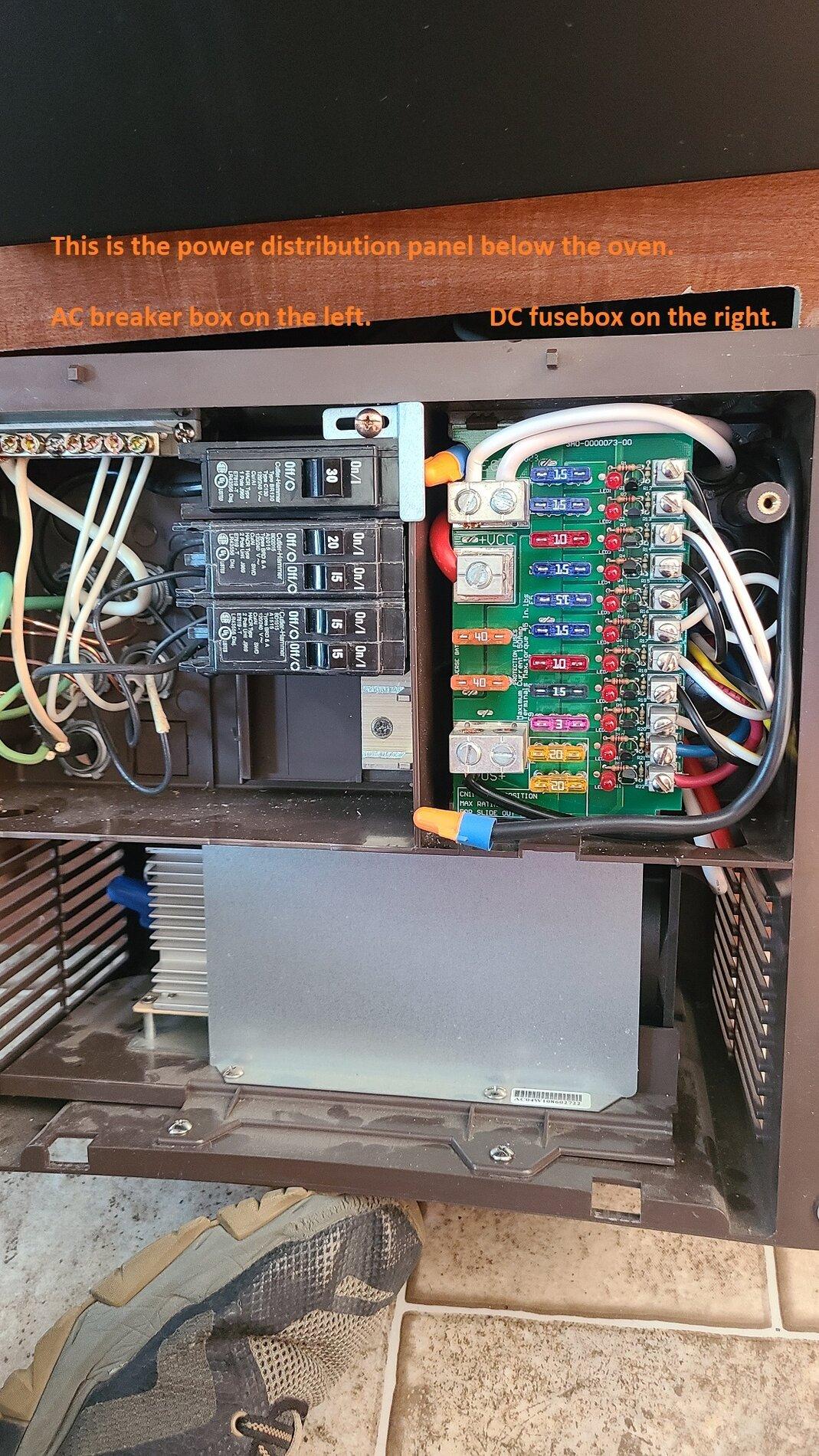

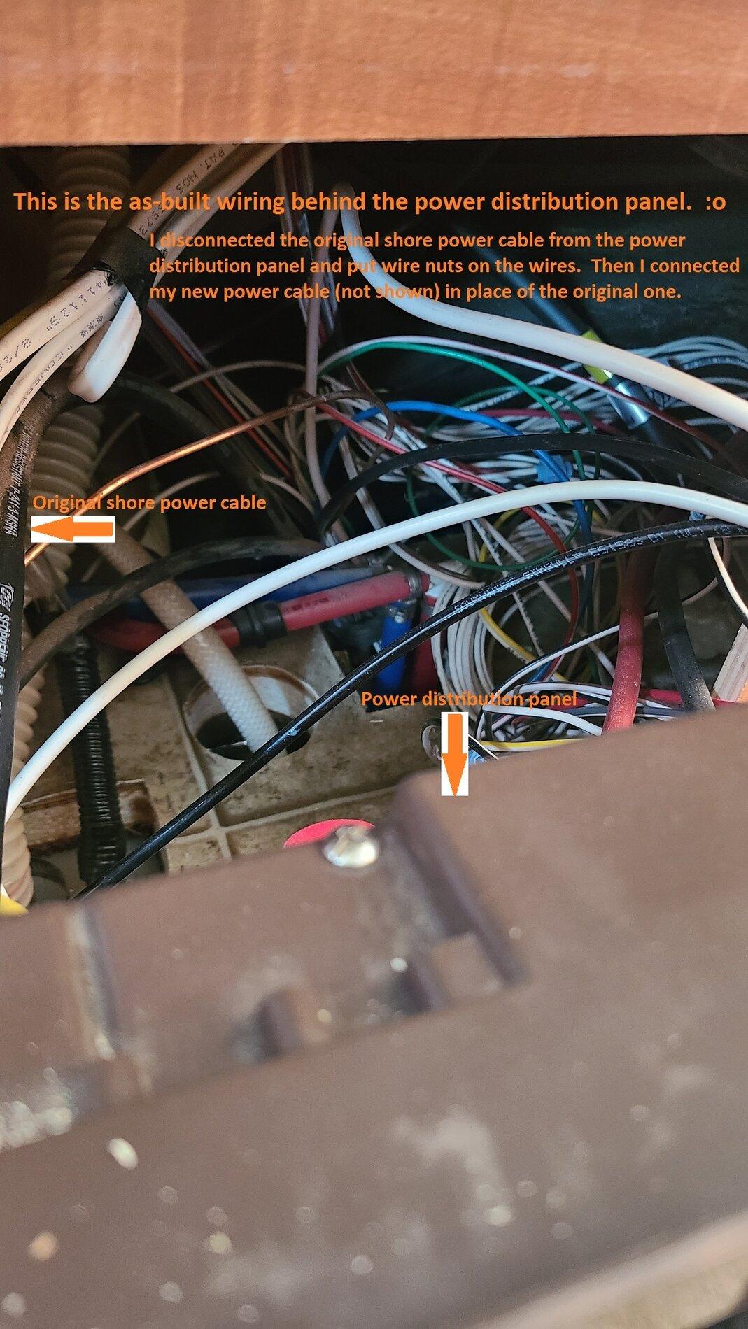

OK, per request here is what I did to get the 120V 30A power inside the trailer.
It was easier than I had expected.
Ford F-150 Pro Power Onboard Generator 7.2K Powering a Trailer While Driving -- IT WORKS! 20211105_170834
Ford F-150 Pro Power Onboard Generator 7.2K Powering a Trailer While Driving -- IT WORKS! 20211105_171625
Ford F-150 Pro Power Onboard Generator 7.2K Powering a Trailer While Driving -- IT WORKS! 20211105_171701

Actually, my early design iterations included a transfer switch - and I even bought (and returned) one. Then the light bulb went on and I realized I was making things harder than necessary. Shore power from a RV park pedestal can simply connect to my new power cord's connector up on the tongue.
Now all 120V power now comes to the trailer from the front, be it PPoB, RV park shore power, or even an extension cord from my house. Our RV's original shore power inlet is (as explained in the pictures) is disconnected from the trailer's AC breaker box and is no longer used.
For that first trip I used the same shore power cable that we have always used. I just connected to the new connector on the tongue instead of original one on the side of the trailer. For next spring I will make a longer shore power cord (say 40 feet) using another of the watertight connectors.
Stay tuned, I'll also post a Bill of Materials.
Hope all this makes sense!
-Eric
