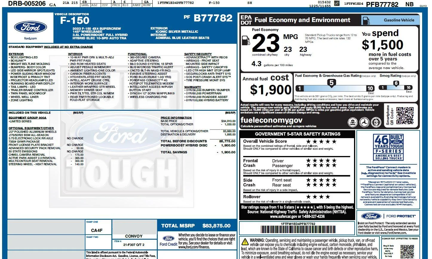

I was about to make a purchase of a 23 Limited, but I didn't want one with CCD since I am probably going to do a lift and tires, and the CCD limits what can be done. Looking at the suspension it appears that it is CCD, but the window sticker does not list it and there have been multiple threads that said it is something you select as an option and not just standard. I also looked at the Limited 900A options group and it doesn't show to come with that either. Also I thought it was odd that is says there were a few things that were removed that are pretty standard like heated steering wheel and multicontour seat removal (but don't even know what that is)

That is indeed the CCD . My 21 Limited doesn’t have it as it came out later in 21 or early 22

The multi contour seats would normally have a massage feature but none of the new trucks have those either as of now.Heated wheel seems to be hit or miss. That’s one reason I like my 21 as it has nothing missing

2023 was the first year heated steering wheel and multi contour sets were not available due to the chip shortage. 2024 will have them

Agree on the heated steering wheel. I have a 2022 with the Multicontour seats deleted.

The 23MY limited comes with CCD standard. If you go to the “view details“ under the build and price for the limited it shows it as included under the handling section

Yes, CCD is standard on the 23 Limited. I would imagine you can still lift the truck. In doing so you'd probably get new shocks anyway.
