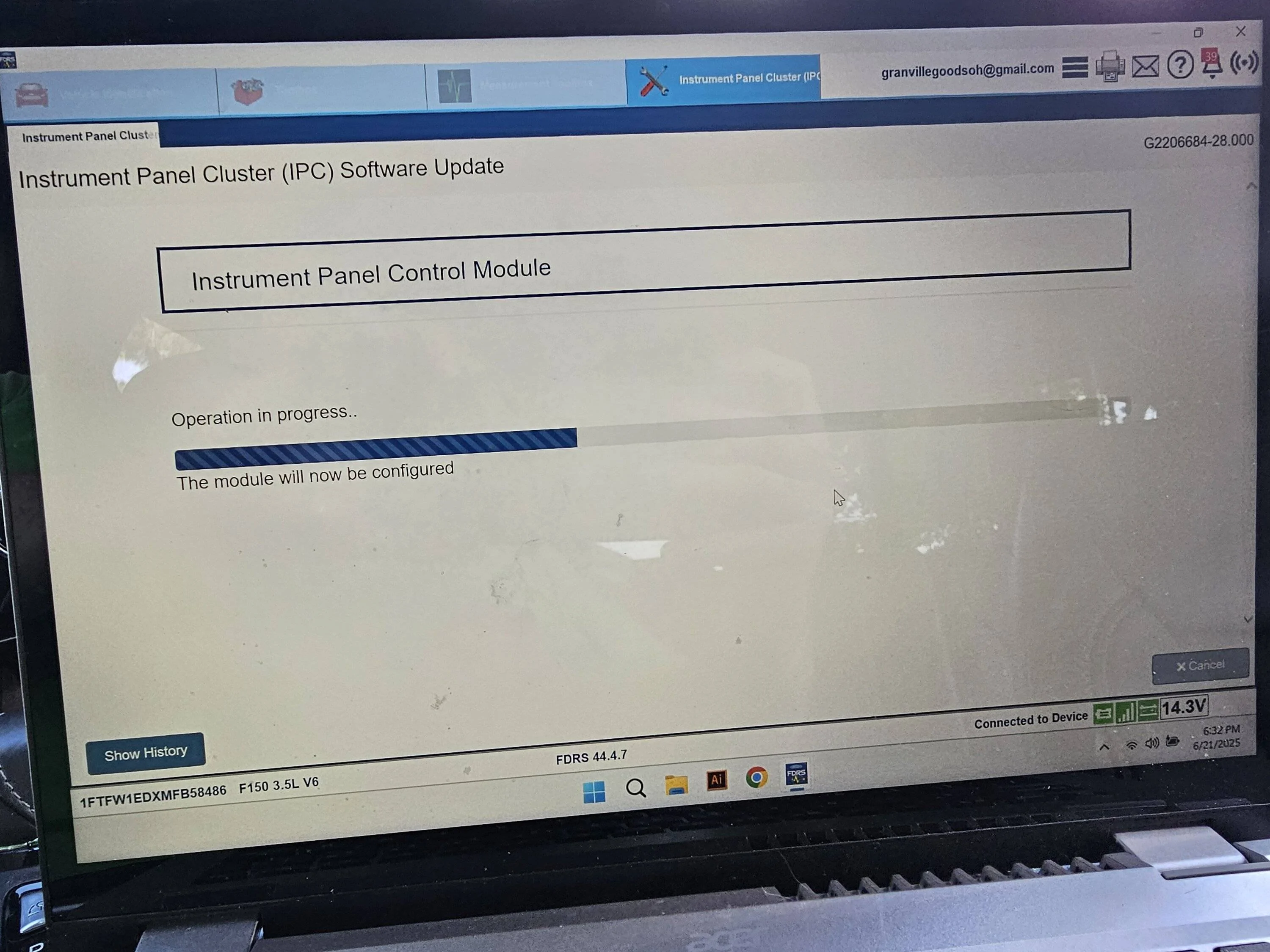

I updated tons of modules on my 21 Powerboost with FDRS with zero issues. IPC would not update with USB so I did CAN. It completed and said pass, but when it went to configuration it's been stuck on "the module will now be configured" for 30+ minutes. What do I do? What should be my next steps? Do I wait for failure message, do I click x at top of Forscan and do something after that? I'm worried I screwed my truck up because the update isn't configuring. Any tips appreciated.

Sometimes software will hang up. Restart FDRS and see if module is green after a scan, which it probably will be, then everything is fine. Install next update for it if available in list.

I did, it got updated and we are good. Thanks

Forgive my ignorance, but method is "I did CAN."
If USB update fails on IPC module, it says you can use the CAN update method, but it takes 6+ hours. It did, just the download/update was 6 hours and then it stuck on programming module for 2 hours, I stopped it and tried again, and it immediately completed and updated. It just uses the Mongoose vs the USB for this specific update which is much slower I guess?
