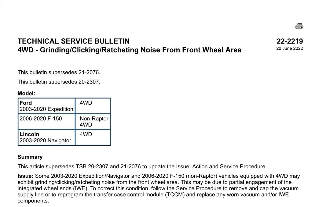

Found the TSB
Get this..... It's for 14 straight year models of F150 with the TOD (4A) Transfer Case.
If 4A equipped, check out what Ford decided to do after messing with the repairs for nearly 18 years
I've attached the whole TSB.
