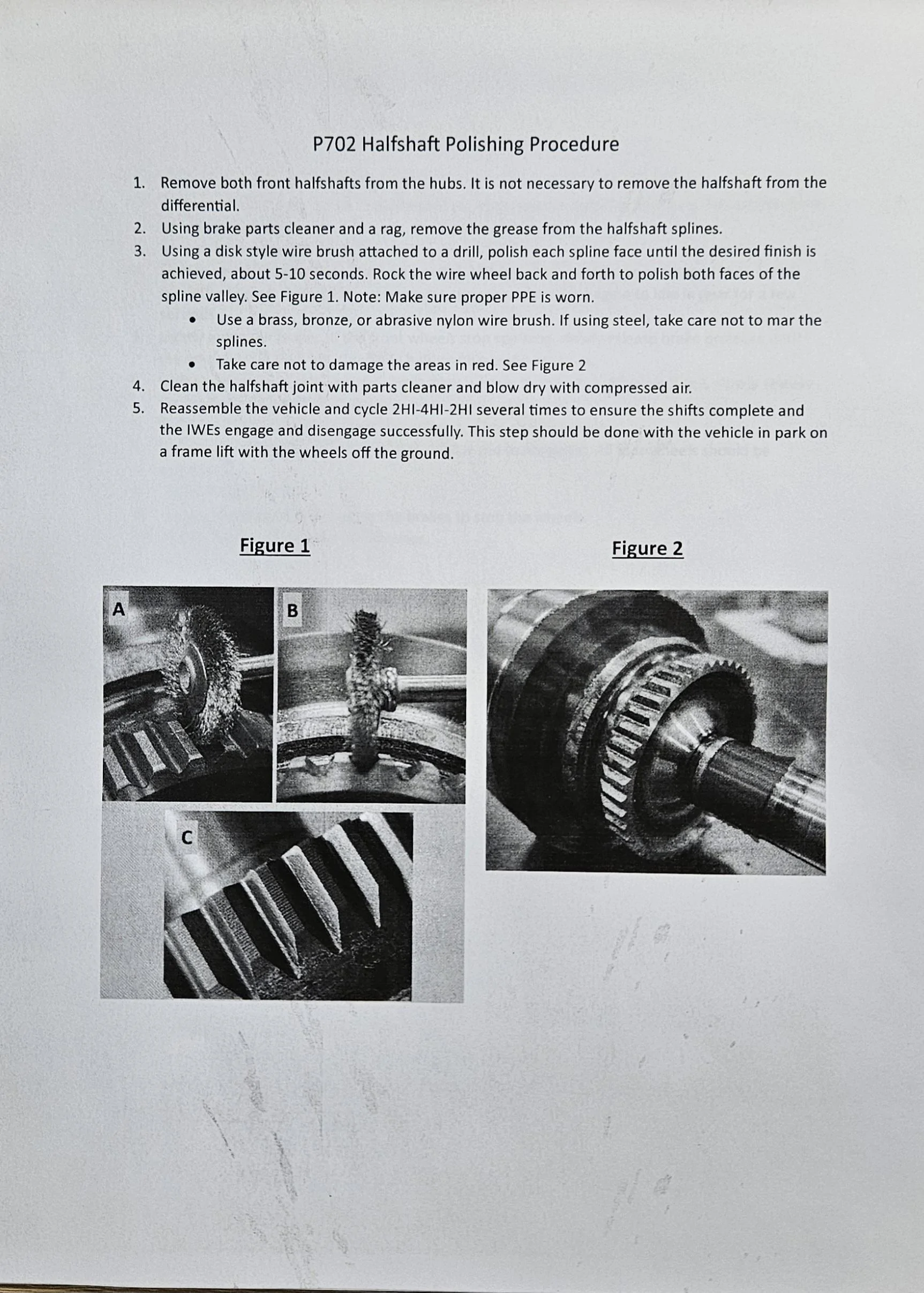

Hi Folks, my truck has been back from the dealer for a week now and the noise is gone. They said mine was the first truck that they've done this procedure on, but they're optimistic that it'll work. Apparently the hotline had run out of suggestions, and this one came from engineering. Hopefully it helps you, because I for one am tired of going back and forth to the dealer for this
This is promising
Interesting! Going to bring this up to dealer! Be great to get an update from you after a month or two!
Thanks for sharing!

After taking mine to dealer, they said they couldn’t replicate the issue. They said it did sound like EIWE from the problem description. They replaced both actuators under warranty. It was mentioned that the teeth on old actuators had been damaged. Have had it back for a few days now with no issues. Dealer said they couldn’t guarantee this would fix the issue as they have replaced full front ends on trucks not being able to fix. They said Ford is certainly aware of it and just a matter of time until there is a fix.
