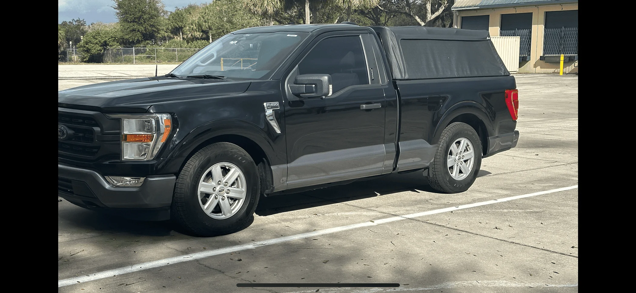

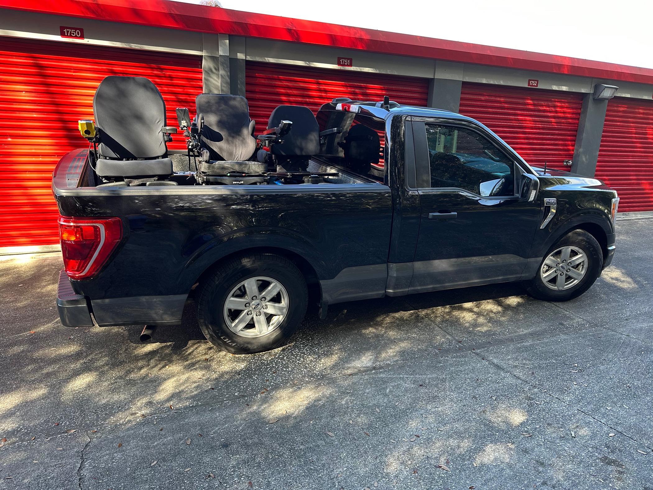

This was my 22 4x4 with the 3/6 (used stock shackle). I did have the airbag kit installed. Second pic is 1300lbs of wheelchairs in the bed. Never bottomed out or hit the Tcase. I did not like the IHC kit so my next one will be different. I imagine the weight of the supercharger dropped my front a little as well.
IHC has two different kits they offer for the 4x4, but they're both listed as a 3x5 kit. For the 4x2 they have the 4/6 kit. That may be why you didn't have bottoming out issues compared to my truck besides just having the air bags in back. I think the 4/6 kit was fine for the price, but the Ridetech kit is infinitely nicer.
Yea it was the 3/5 using the stock shackle made it 3/6. Ridetech is the kit I’m doing next as it uses the stock lower control arm which is way better than the IHC one as it uses the ball joint from like a 2000s Chevy. Has major issues with the nut galling on the threads and they don’t have replacements. Had to fab one myself.
I too did not really like the control arm setup on the IHC kit. I understand the idea was to try and keep the ride stock by using the stock spring and shock, but the way it relocated the suspension geometry I don't think was ideal at all. I also didn't like that they needed to use a sleeve insert to take up the slack in the control arm hole for the ball joint, or the fact the nut engagement was so short either. The Ridetech components are MUCH more quality, I can definitely say that, they just don't go as low as the 4/6 kit.
