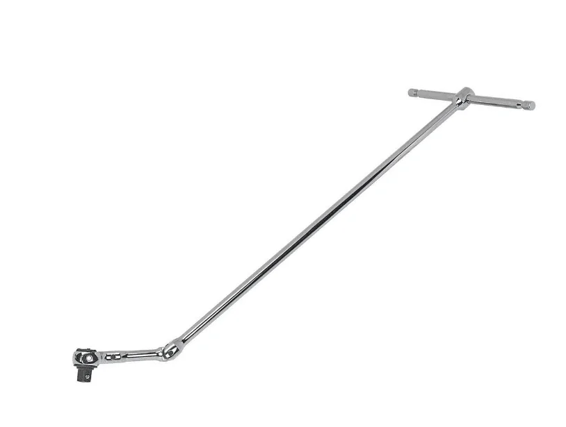

If you've changed your own oil on the 3.5L engine you know how much of a PITA it is to get to the oil filter and spin it off. The worst part is that it's a two-hand operation since the filter is tucked so far back there, so you're on your back and craning your neck to get your arms back in there to loosen the filter. Ugh.
Well, no more. I found the perfect tool to make this a one-hand operation.
I found it at Harbor Freight; it's a "3/8" drive flexible ratcheting t-bar" about 18" long. When it used it with a 76/14 oil wrench cap, it was super-easy (well, comparatively!) and the filter was off in seconds.
Seventeen bones. Worth it.

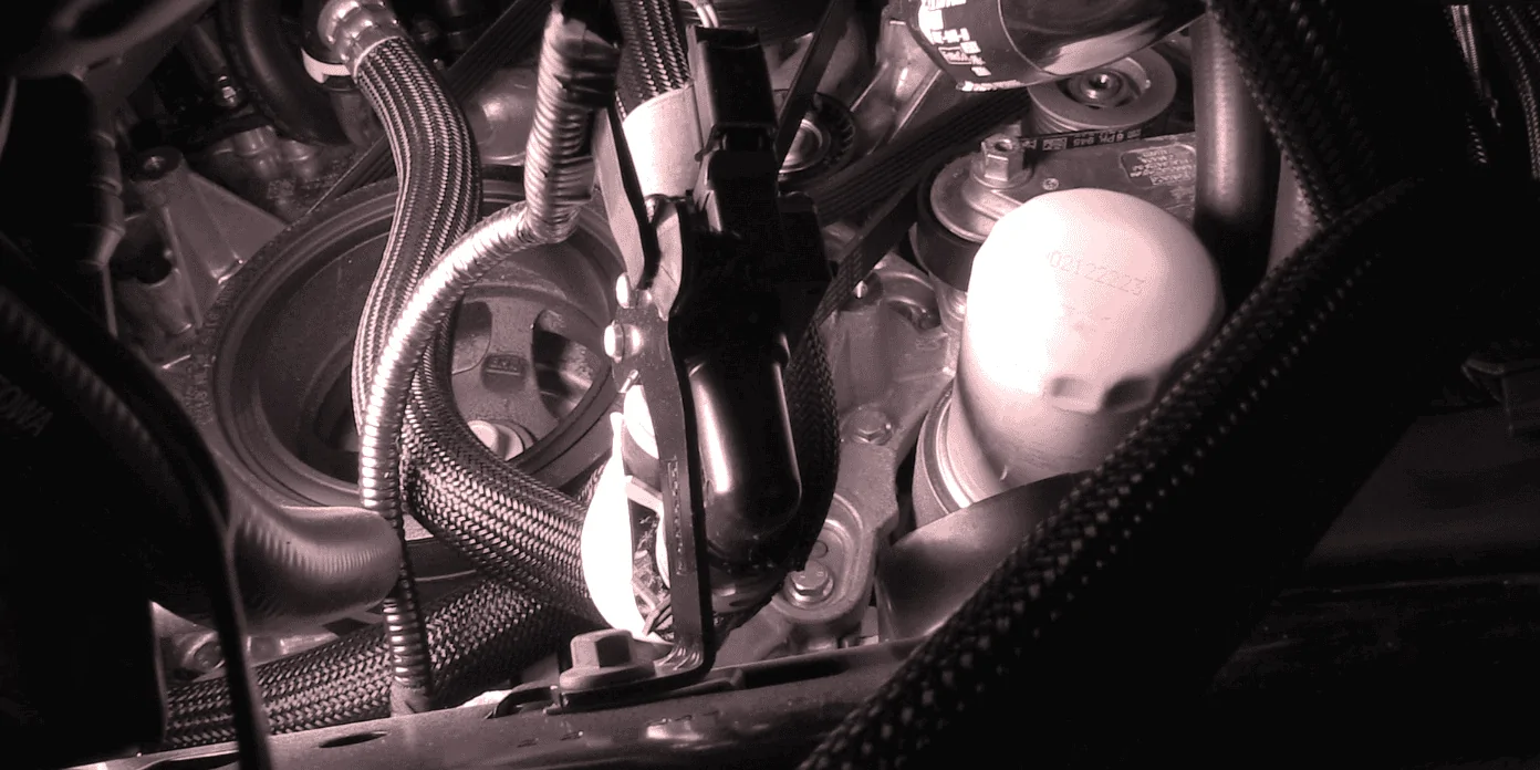

Sounds like there's a bunch of junk in front of the filter on the PB?
yeah it looks like a scene from the Aliens movie. It's a bitch to get in there, requires both hands with tools I've used before.
