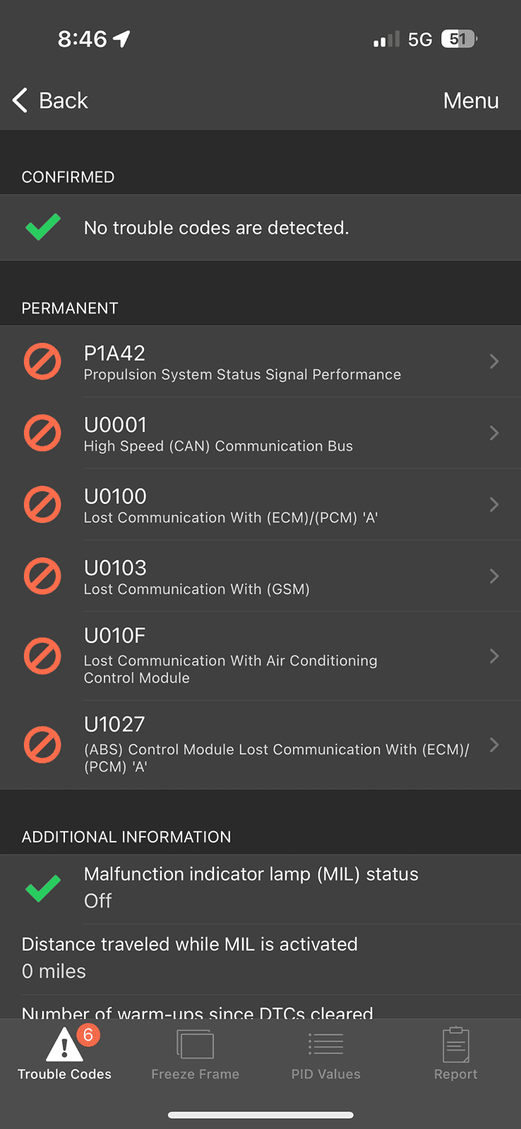

So yeah, maybe there's a bit more going on than I thought. I'm seeing these 'permanent' codes in OBDlink, even after a reset (including from MyCalibrator).. No light on the dashboard though.
Ford F-150 I pooped a little bit tonight.. IMG_3743
I'll call in a few favors.. :D Any ideas @Jesse-Infotainment @HammaMan
It runs and drives fine, however. ?‍♂ Maybe it'll just go away on its own after a few miles?

They all look like communication errors. After clearing they returned?

Yup. They stayed after clearing codes and KAM. From what little I can tell from the internets, it may take a few drive cycles to clear the 'permanent' codes.
Lesson learned - don't turn on your truck with the ECU disconnected..
I would reflash it back to stock. I can load it a different way. May have been a bad file loaded.
I can send you the file if youre able to load it into the programmer you have

I would lean towards these being "oh $hit" errors from the ECU being unplugged when you tried to power up. Hopefully they clear.

I took a 30 mile drive or so earlier today and nothing seems off. I'm going to give it a few drive cycles to see if the codes self-clear. If not, I'll try Jesse's suggestion.
