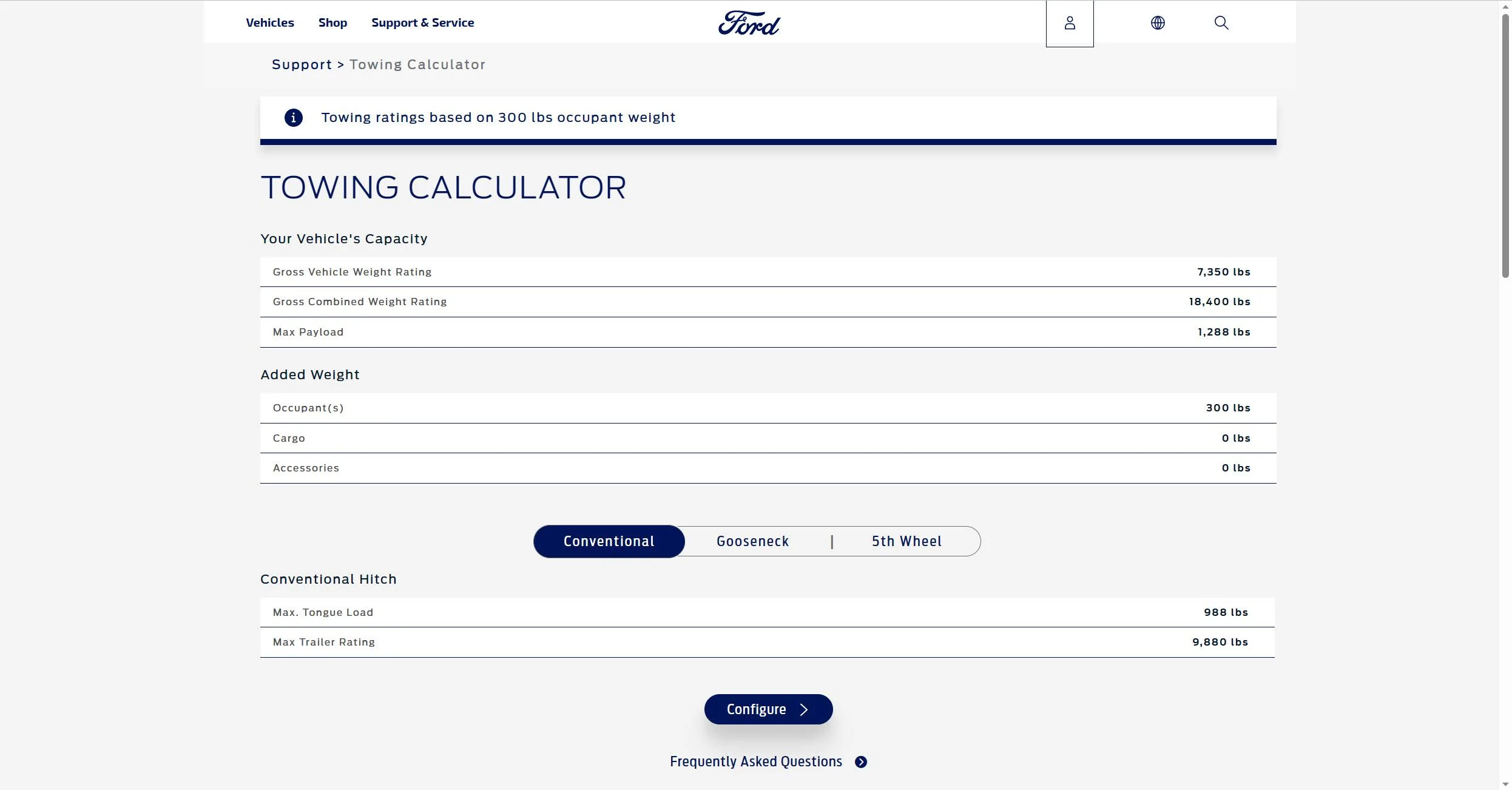

I actually do have a ford.com account and those numbers are for my VIN.
But just to check how I got there, I log into my account and go to vehicle dashboard. From there, I scroll down to Towing Calculator and I get this:
I am a newbie on this topic, but trying to learn from all the folks here myself. You are seeing that you have your wife and yourself weighing in at only 300# right? and nothing for luggage, items in bed, hitch, etc., etc.? Here's mine, and it drastically changes the math from yours...One question for anyone - how does a weight distribution hitch change anything here? or does it? I thought with one I could have a much higher tongue weight?

Check your payload. Powerboosts have lower payloads despite being the most powerfull. I got over 1800lbs on my Lariat despite limited to 7,000lbs towing. I can do a 6-7k lbs trailer with 800lbs wdh , 4 family members, luggage, and have leftover payload.

I think you'll be close. Your payload is 1300lbs and you can estimate up to 800lb of tongue weight with 13% of 6000. That leaves ~500lbs for humans, pets, and anything else you added or want to carry in the truck. I would feel confident in this if it was a weekend camping rig. But if you're wanting to full time or travel for weeks at a time, carry water, etc., I'd verify on the CAT scales and personal comfort levels and then decide if it is worth upgrading to a super duty.

I hesitate to jump in here as everyone has an opinion and most will make valid points. The following is just my opinion and it is no more valid than anyone else's on this forum and probably less valid than some.
Towing capacity isn't a problem for these trucks at all. The issue is payload as @bgalakazam highlights. This is where you need to focus.
If yours is 1288lb as indicated above then with the data provided
Trailer wt = 13% x 6000 lbs = 780lbs *
Wt dist hitch = 100lbs
Passengers = 300lbs
*Don't use trailer estimate. For stability it is recommended you try to get about 13% of trailer wt on your truck distributed properly front to back.
Total is then 1180 lbs which is under your max by 100 lbs. So as long as you don't have anything in the truck or accessories added after build you will are under max.
Most will say you can go a bit over and still be fine (I am not one of those but will say before I understood this I was over on my old truck by a fair bit and I had no trouble - I was careful in my new truck to max the payload). If you aren't going far, you can run with half full gas tank as payload limits assume full tanks. Powerboosts have lower payload but on flip side the truck is heavier which helps with stability and many of the components that are in the MaX tow option for non powerboosts trucks come std in your truck.

My neighbor, who has decades of trailer towing experience, tows his 27’ DFOX with a 1-ton V8 diesel (non-Ford). He said that allows him to tow it anywhere, especially to maintain high speeds up severe upgrades.
I mentioned that my wife and I are looking to travel once retirement hits in 3 years and that we have looked at Airstreams (her dream) and have probably settled on a 24 ft. Flying Cloud.
He looked at my 2022 F-150 PowerBoost and said “yeah, it’ll tow it and everyone and all the data sheets say it will, but it won’t be very good at it, especially on hills where you could really strain the engine.”
Now, I didn’t go into the fact that the Gen 14’s are different from what he thinks of an F-150, and I didn’t go into the Max Tow Package, PB engine, etc., but seeing that we bought this truck on the assumption it could tow a fairly small trailer, am I missing something here? Are we going to have a problem with towing efficiently with the numbers below?
Here's the hard data for my VIN and also the Flying Cloud 24’.
  • Vehicle Capacity: F-150 PB 6.5 ft Bed w/Max Tow Package:
  • GVWR: 7,350 lbs.
  • GCWR (F-150, Trailer and payload) 18,400 lbs.
  • Airstream GVWR: 6,000 lbs.
  • Tongue weight: 500 lbs.
  • GCWR of F-150 + Airstream Flying Cloud 24’ + Added Payload weight of occupants, etc.: 14, 350 lbs.
18,400 lbs. max GCWR minus actual GCWR of 14,350 lbs. = 4,050 lbs.
I come in under the max weight by over 4,000 lbs.
Am I missing anything? Anyone with real-world towing experience who can shed some light, especially with an Airstream?
Thanks in advance!

Excellent, thats exactly where I was hoping you'd go.
See where it says you have a max payload of 1200lbs?
In that number, you have to fit people, baggage, truck accessories, tools and gear, your hitch AND the tongue weight.
None of the other numbers in the tow guides matter, because payload is the one you run out of first.
