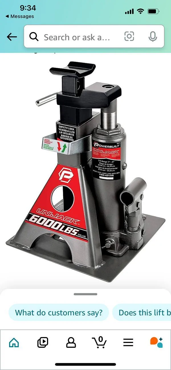

In every vehicle I had owned for the past 3 decades I've always carried a small hydraulic jack and 4-way lug wrench of my own. I am curious if anyone else carries a jack in their F-150 and what the range of lift and weight rating should be. Should it be a bottle jack, or a small trolley jack.
I was under my truck yesterday and measured the distance from the rear agle to the garage floor to be 13 inches. I also measured the height on the inflated tires to be 5 inches. Of course with a deflated tire, or on an irregular surface it would be different.
I carry a small cheap floor jack and a bottle jack. I also carry a Dewalt cordless 1/2" impact wrench, and a set of sockets for changing tires, the sockets are a different size on each end. There are 3 sockets that will fit 6 different size lug nuts. I bought these sockets on Amazon. They were inexpensive. I also carry a torque wrench to torque the nuts when I change a flat. I bought the socket set so that I could help other people, if I need to.
