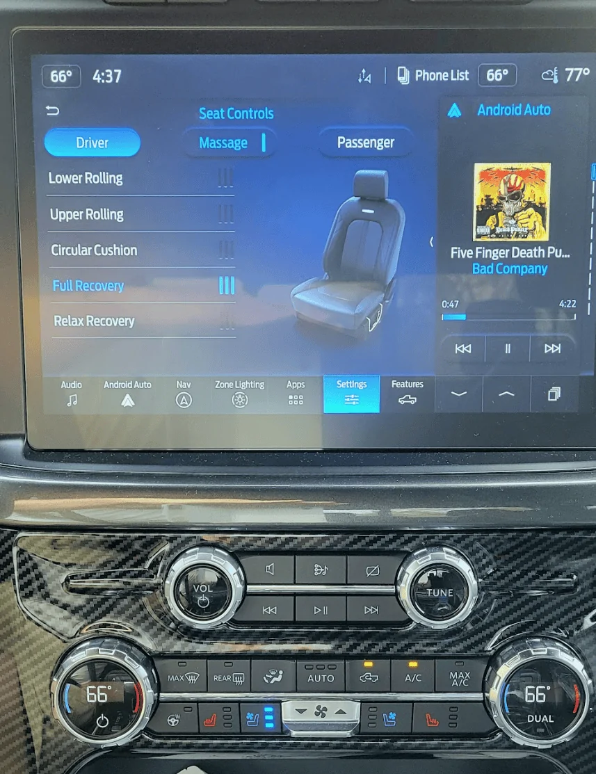

You can't do a PMI on a module that is not supposed to be in the truck. If the part number is not in the inventory for your truck the PMI will fail.
I PMI'd this into my XLT, which doesn't come with it. Upon installing the H/C seats I then had to change it over to DSM control instead of integrated. Truck is 22 and this is a 21 part number.

The pmi isnt the issue. The ones that have heated and cooled buttons arent physically capable of running the heated only setup because the internal circuitry isn’t setup for it. Same reason why you couldn’t ad the auto bezel on last gen and keep heated only seats.

I've got 3 different units for the H/C seats and the PMI did in-fact turn on the heated seats that rely on the feed that gets fed from the HVAC unit. There's probably a few part numbers and can't be sure exactly which one did work with the factory HVAC fed heated seats.

thats surprising as no one could get it to work at all for 13th gen. All a pmi does is load the as built to it and reset it no different then using forscan to load them. it would be reliant on the firmware on each one. It’s similar to the massage function having a 20 minute limit on factory equipped vehicles but ones bought separately having unlimited run time.

I ended up going back to old hvac control. For anyone looking, if you coded your truck as a 250 to get the button for the heated steering wheel, you need undo that before activating the unreal theme and the soft hvac buttons and on screen climate bar
