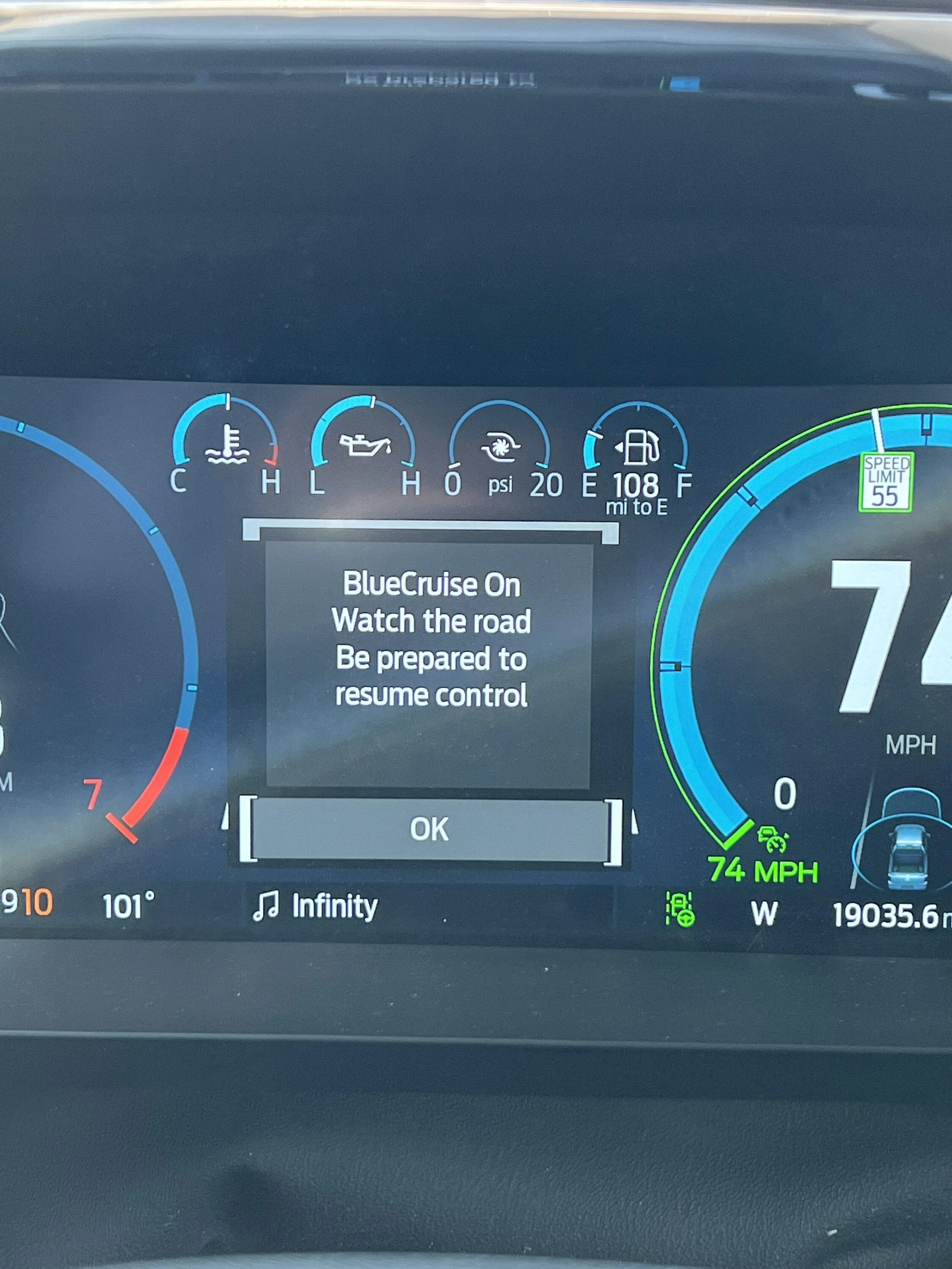

Been getting this notification every time I set the cruse control. I’m on update 2.8.1. Does anyone els get this pop up? Still normal adaptive cruse control no blue cruse yet.
I get the same as I just updated to 2.8.1. You need one more update to 2.8.2 to fully enable BlueCruise. I'm still waiting for mine.

2.8.2! Job 1 truck ordered Nov '20, paid for and delivered Feb '21. Finally got BC activated. To be honest the hold up for me was never bad APIM, low battery, dealer can't figure it out, bad WIFI, bad cellular, etc. I got everything OTA. The only thing holding things back was you, Ford, not sending it out to me.

Got 2.8.2 update today. Finally have BlueCruise. Works really well.

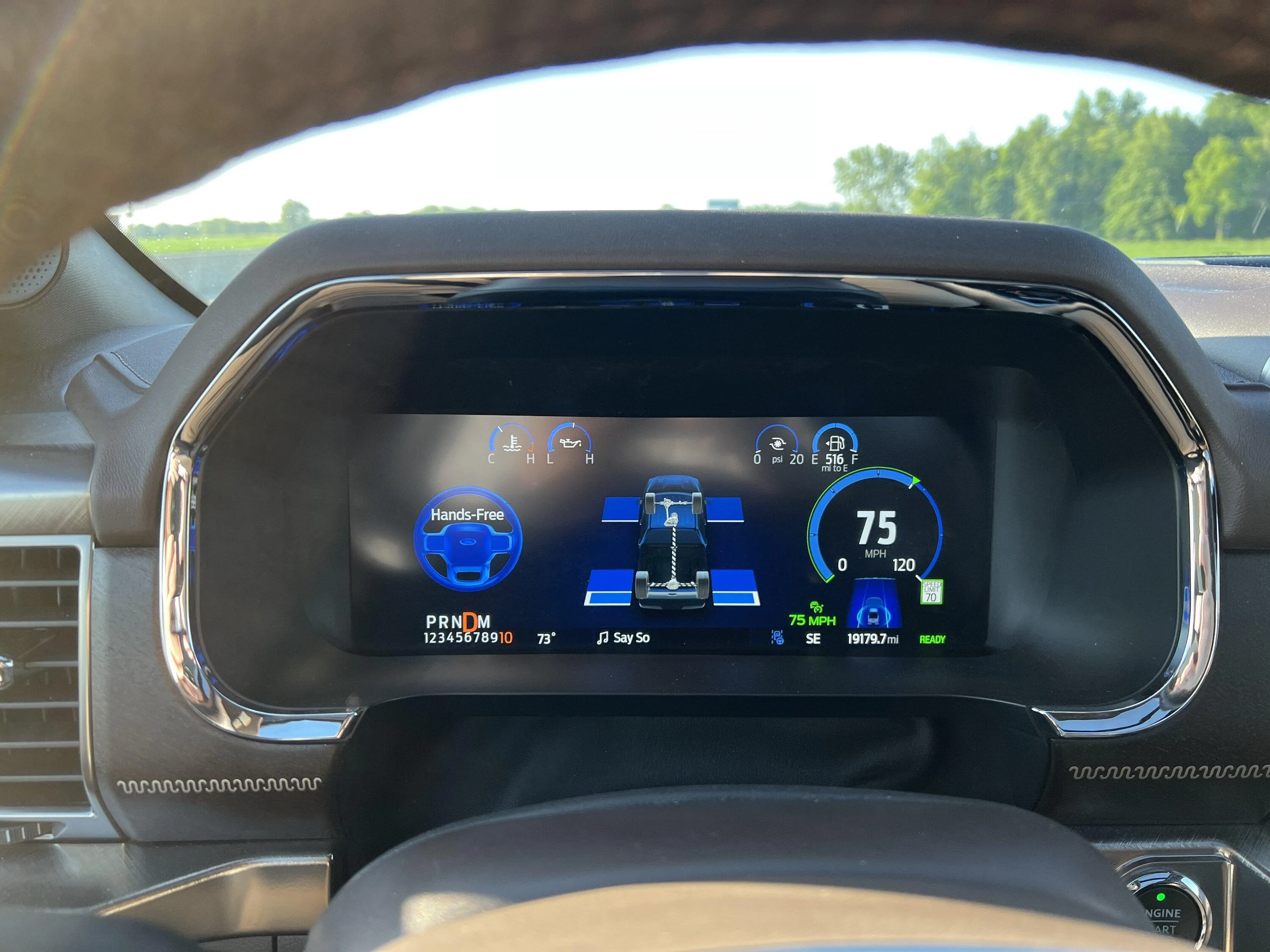

Got my update also. Headed to work on I65 here in Indiana (which is where I took the picture of the alert from my previous post) and Blue Cruse started working right away.

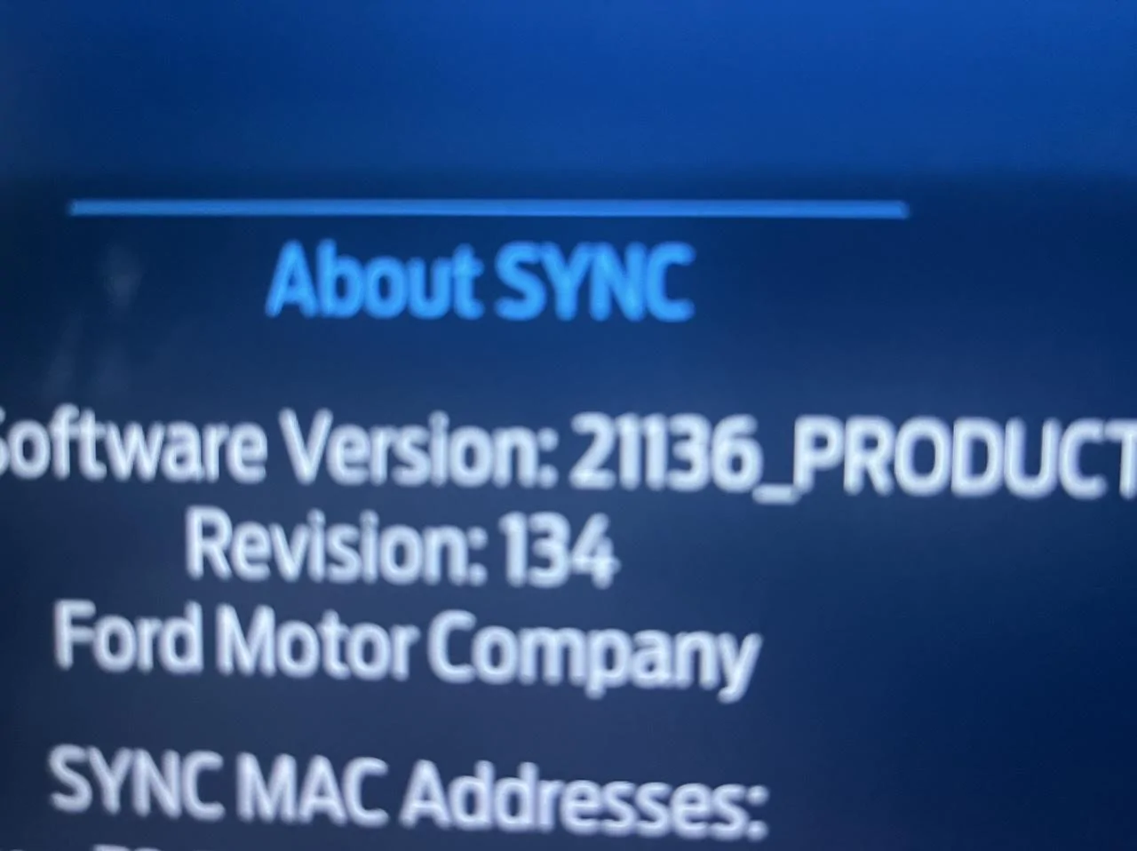

Ford F-150 How to never miss a OTA software update! [Instructions] 2E7C12F5-DD18-445F-86D9-F577FCF981ED
Ford F-150 How to never miss a OTA software update! [Instructions] B614050A-B14A-4484-9463-96C038954F30
Ford F-150 How to never miss a OTA software update! [Instructions] 772529FD-E884-4FB8-9E22-BE80578D88A2
