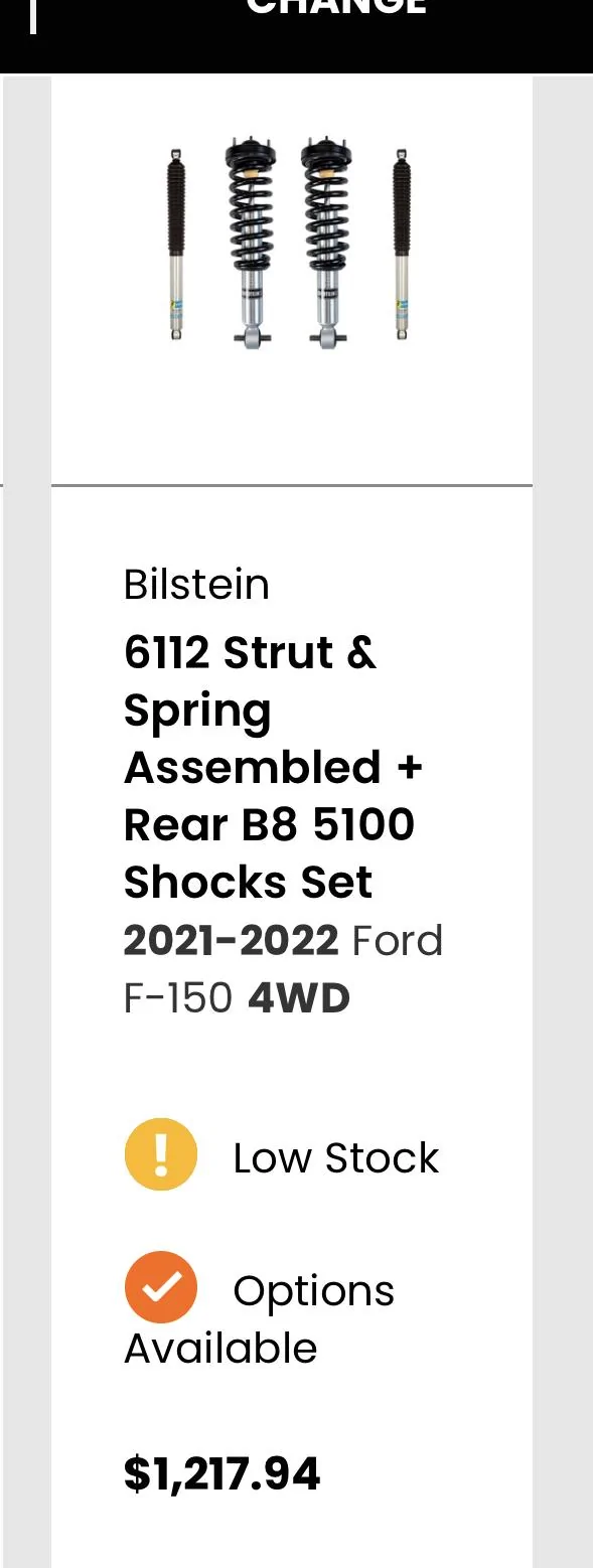

Drop down to a bilstien 5100 or 6112 in the front and then a 5100 or 5160 in the rear then drop tire size. Either a 275/70R18 or a 295/70R18. Like I said previously and stated by the above owner you are either in eco or boost. You are pushing heavy tires using boost. Making your mileage terrible.
So like this set would would work good? Also if I added this could I still add some type of A/T tire since I do have the FX 4 package
Ford F-150 How much does 3" inch lift with 35's affect PowerBoost's performance and MPG? 57A178BA-F4EA-4A3D-B4A8-BDDF66ACB974
