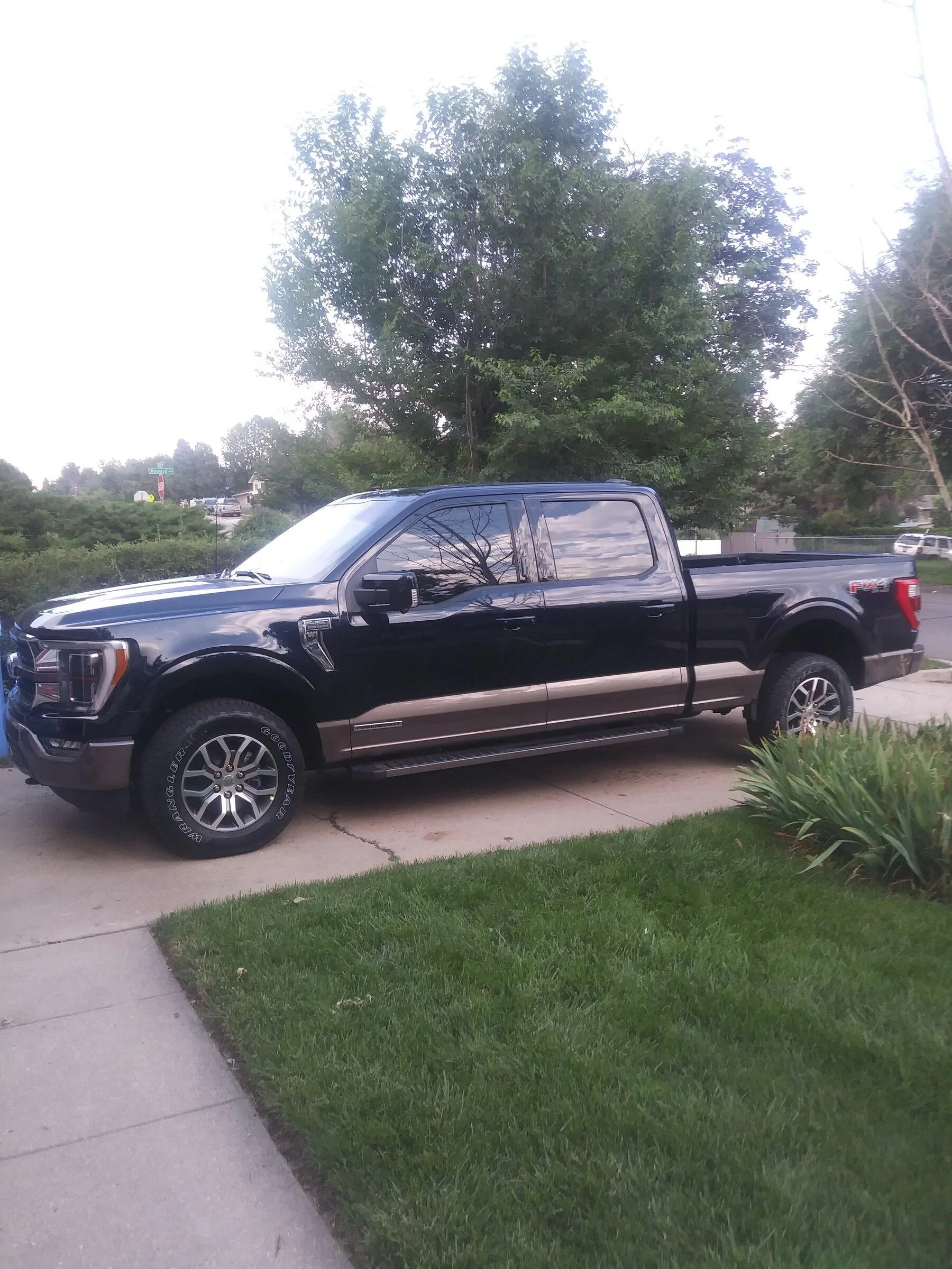

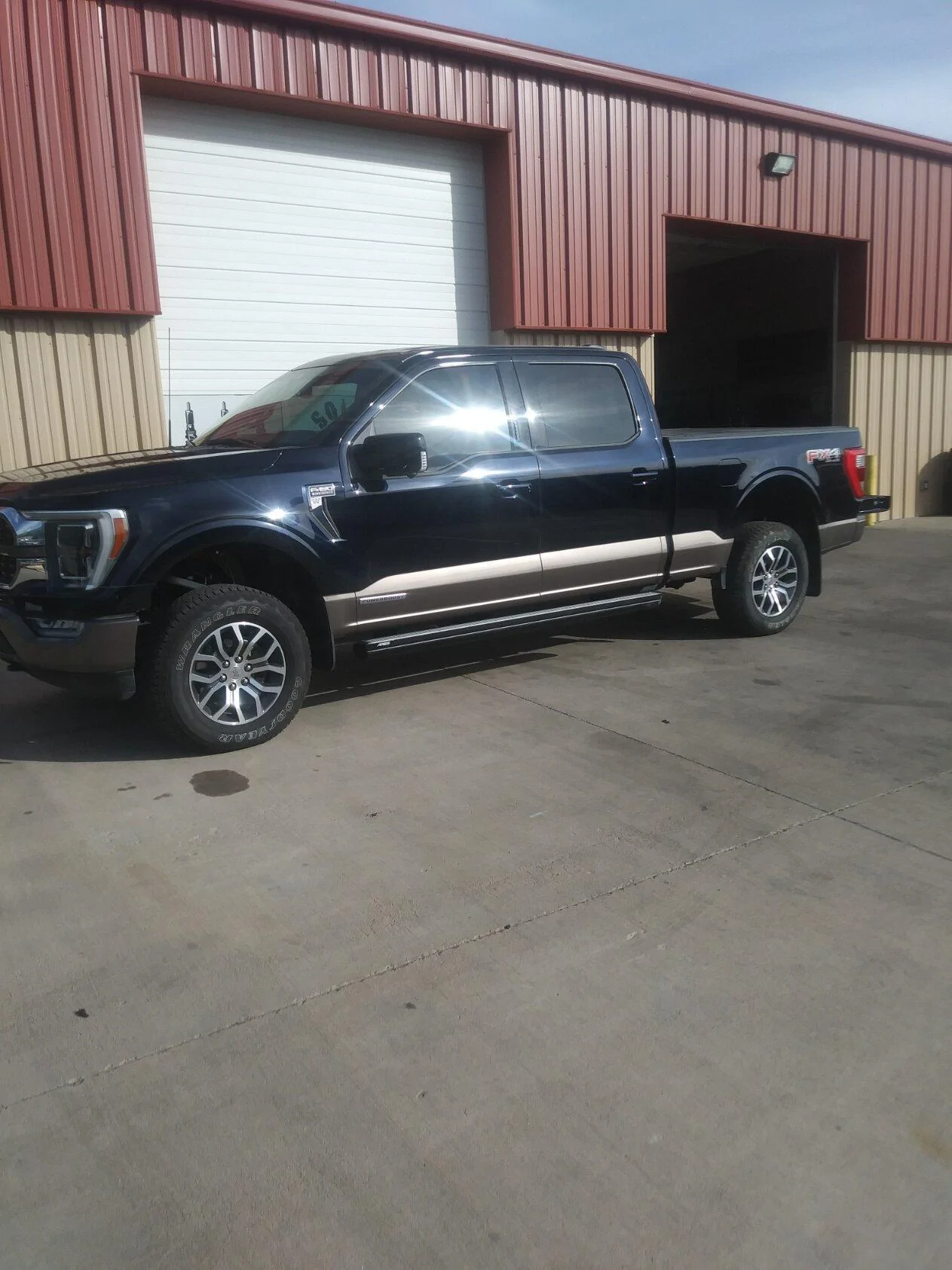

Here it is. 3" RC lift in the front and 1" rear with Vertex adjustable shocks. I also added the Aries Powerboards. They are the only Powerboards that fit the Powerboost without modification. Measurements went from 36.25" front to 39.5". 39.5" to 40.5" in the rear. I only have about 8 miles on it in town, but the ride seems just a touch stiffer than stock with the shocks set on #4. I'll have to play with that a little to see what setting I prefer. Now for tires once it gets closer to hunting season.

Thanks. I haven't driven enough to form a true opinion yet. So far a little stiffer than stock, just enough to notice. I'll know more after tomorrow. I'm headed out for a little mellow off road. The adjustments are very easy, a dial knob on each reservoir. 1-8 adjustment, it's on 4 right now.

General impressions after a couple weeks and finally getting to some moderate off road driving.
1. MPG loss with the stock tires isn't enough to notice. No change with how the lane centering works, headlight aim is still good.
2. I'm set on 4 right now (adjustable 1-8, 1 is softest). Small bumps on the highway are more noticeable. Off road it was smoother and handle the harsher bumps much better than stock.
3. Body roll wasn't bad stock but is almost nonexistent with the vertex shocks. It stays planted on the corners better than stock.
I'll be moving the setting to 3 and maybe 2 for my highway driving to get closer to stock feel. Off road I'll be sticking with the 4 setting for now.

It measures out between 76" and 77" at the antenna on the back of the roof. That is with the stock tires and rims.

The RC lift only raises the rear by 1", the front by 3". I have a Leer 650 installed that is fairly heavy. The fact I also have the Powerboost that is a bit heavier doesn't surprise me that it is at 77". Since the highest point is at the very back of the cab close to the rear axle the 1" rear lift is the only real effect on overall height with the amount of rake in these trucks
