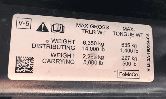

The 5,000lb limit is the spec on the receiver hitch, anything over 5,000 needs a WDB hitch.
The hitch on my Lariat with max tow is rated:
5,000 lbs max trailer weight with a max tongue weight of 500 lbs
14,000 lbs max trailer weight with a max tongue weight of 1,400 lbs with weight distributing hitch.
Right and yours is very close, so not as much as an issue, but others need to understand the Hitch rating printed on the label on your Hitch is NOT your Max Tow rating. It is the rating of the Hitch which is used on many variations of the F150.
In your case your actual vehicle Max Tow Rating is 13,800 not 14,000.
For others their Max Tow Rating might be 9,300lbs even though the hitch sticker says 14,000.
Yeah, I also got lost with these numbers on my hitch.
Yeah, that's where you can get into trouble if you're not careful. Those ratings are for the receiver hitch itself, not the vehicle it is bolted too. I'm sure Ford specs them out to be just over the max rating on the truck so that the hitch isn't the 'weak point'. It all comes down to liability, and that's where it ultimately ends up in your hands to make sure you are loaded correctly, and that your equipment is properly maintained in order to safely transport your stuff.
OK, so what's the difference between the two numbers? Am I understanding this correctly that even though your truck is capable of towing 14,000 Lbs, you can only do so with WDH, and if you don't use WDH you can only tow up to 5000 Lbs? Or am I reading this wrong?
Correct. The only difference between the two numbers is the style of hitch you use.
Standard hitch = 5000 lb max
Weight Distribution Hitch = 13,800 for my truck.
Comes down to how the weight is distributed between the truck and trailer, for stability at highway speeds.
Well to be precise the 14k number on the hitch frame is speaking ONLY to the hitch frame capability (with a WDH), does NOT mean your truck is capable of 14k.... as we were just calculating in the other posts.
For an assembly (the whole truck) to have a Max spec ALL the parts that go into the assembly have to have specs for their function better than the total result (e.g. weakest link in the chain phenomenon).
So you will find the sum of the max spec for the front and rear axle will be more than the GVWR. Also you will find the sum of the 2 wheels/rims on each of the axles will be more than the Axle rating. And the tire weight rating will be more than the wheel/rim rating. And so on....
