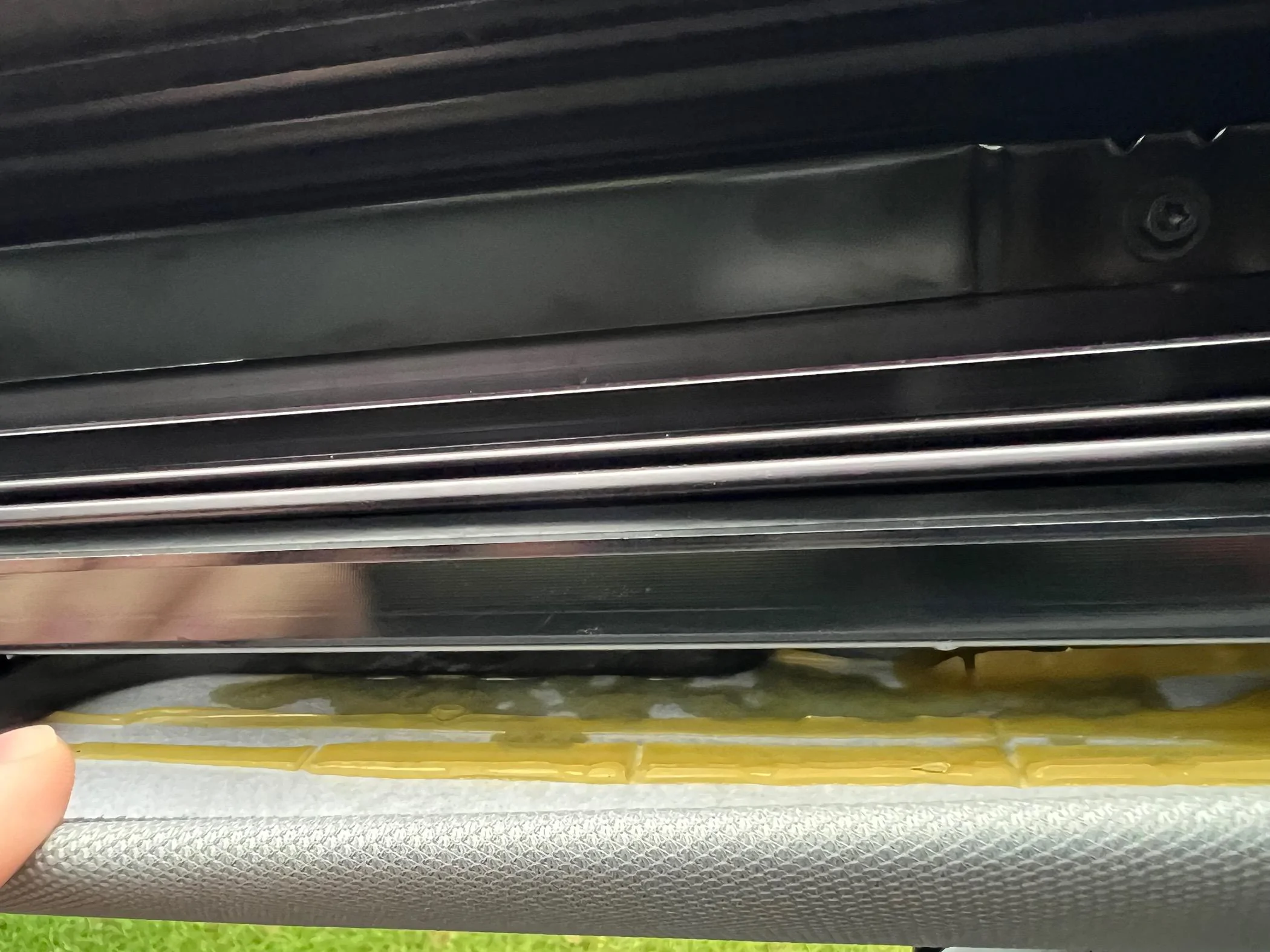

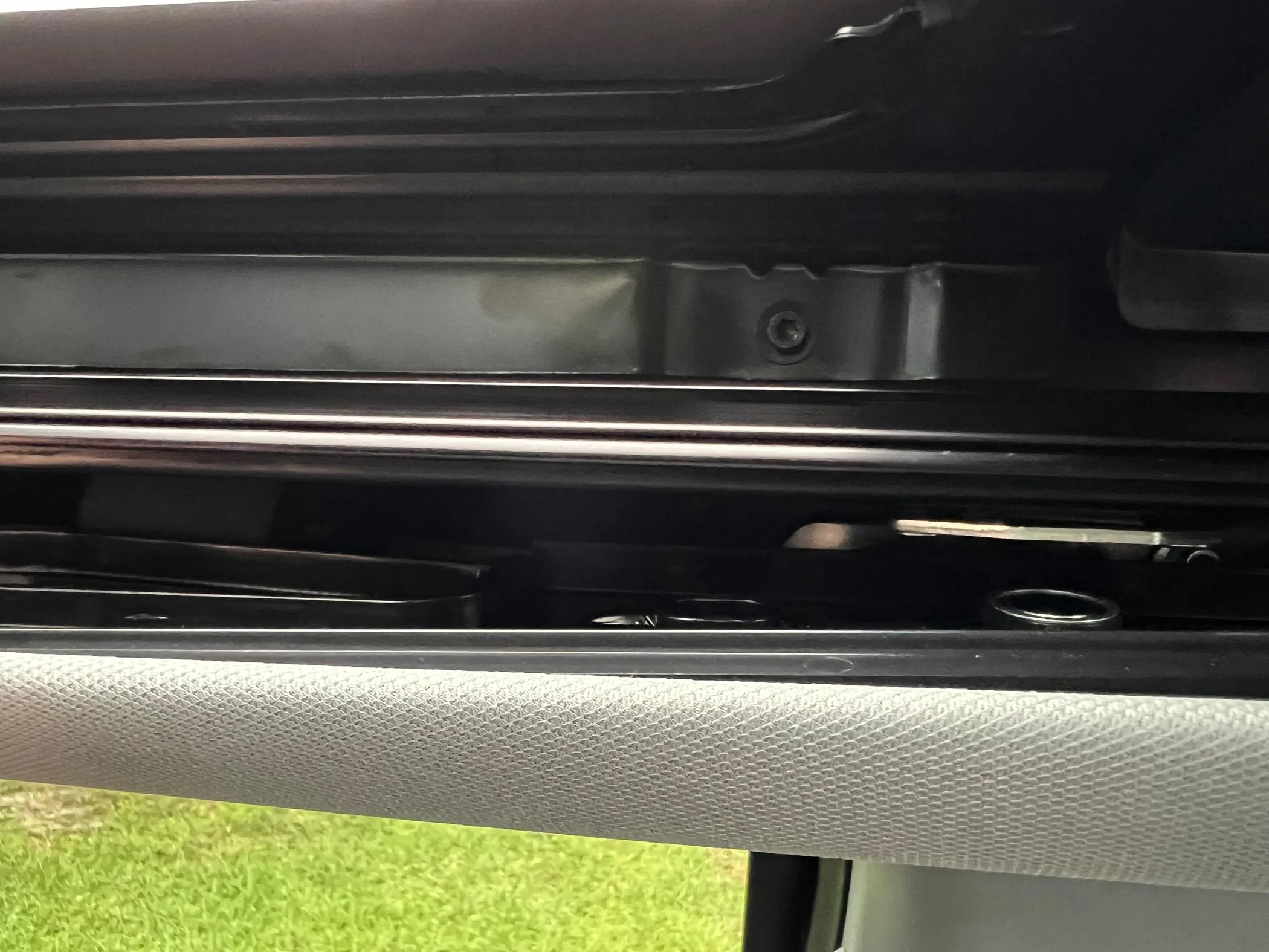

Do you mind making a video showing exactly where you placed the products? Super please?!? I’m on the verge on selling my truck that rattle noise or so annoying
Idk if I can do a video since it’s fixed since I that loctite epoxy. These are the best before pictures I have. I can try to take a video if these aren’t enough.

I would 100% appreciate a video because mine has been at the dealer for two weeks and they keep saying, we can’t do anything about it. They even went as far to say it’s normal. Even went on drives with them but they refuse to admit it

It’ll either be tomorrow or this weekend, but I’ll take a video and do my best to explain what I did.

I’d greatly appreciate it but this is my last resort before I sell the truck. I’ll follow up sometime next week if you forget.

If you’re near Jacksonville Florida I’ll even help you fix it

Here’s your video! Recorded in 4K so if you give it some time to process you’ll have a crystal clear video.
