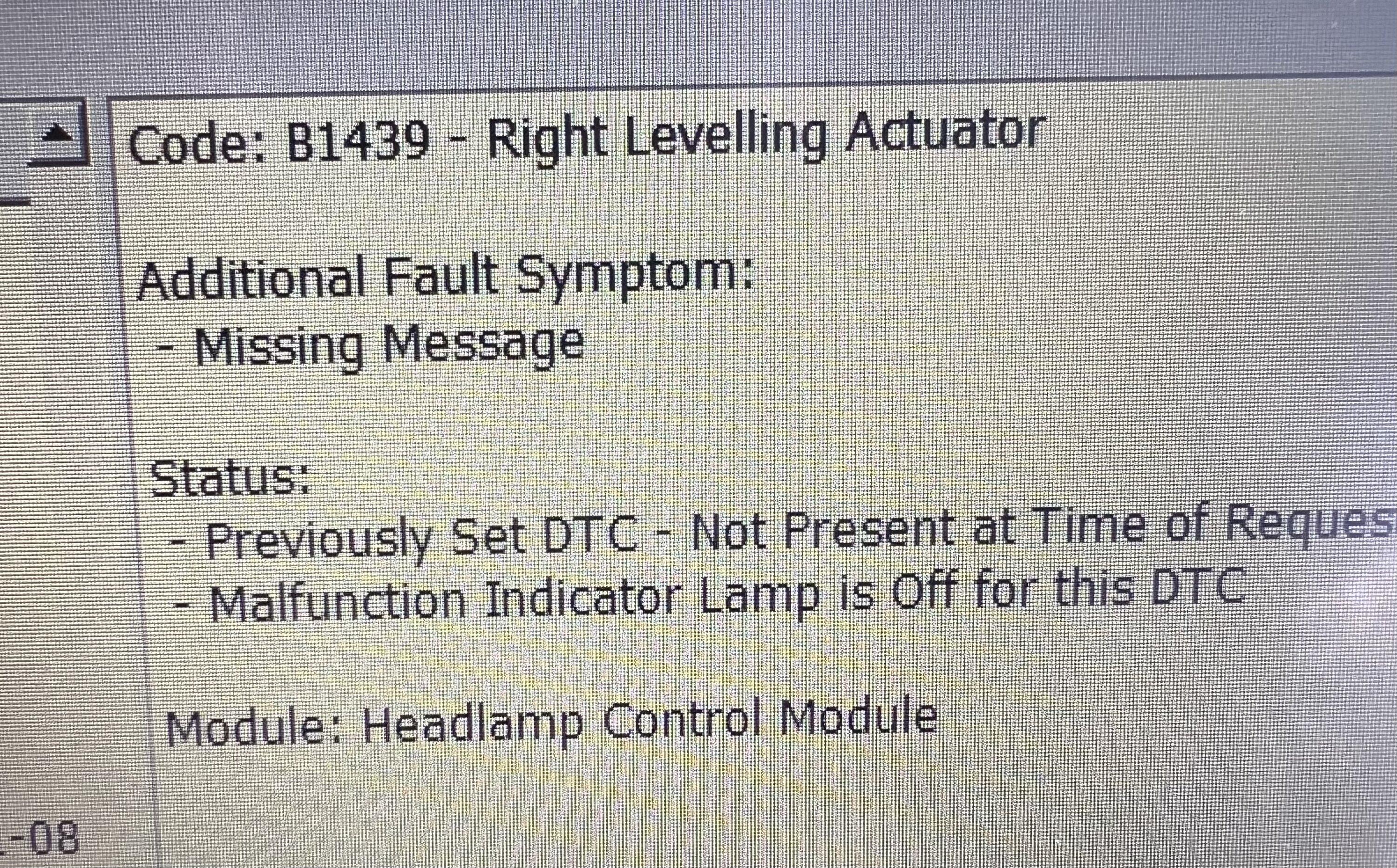

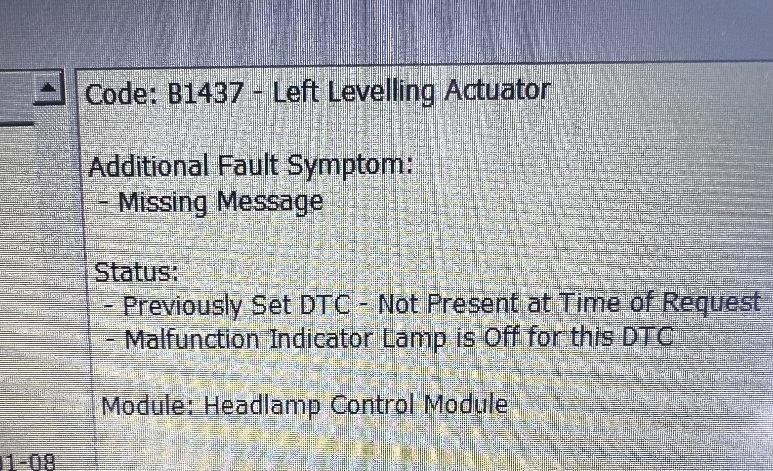

I did get the codes and they point to something software related because both headlights can't have the exact same problem yet act perfectly normal if the truck is not remote started.
Ford F-150 Headlight Control Module IMG_2066
Ford F-150 Headlight Control Module IMG_2065
Ford F-150 Headlight Control Module IMG_2064
Ford F-150 Headlight Control Module IMG_2063
