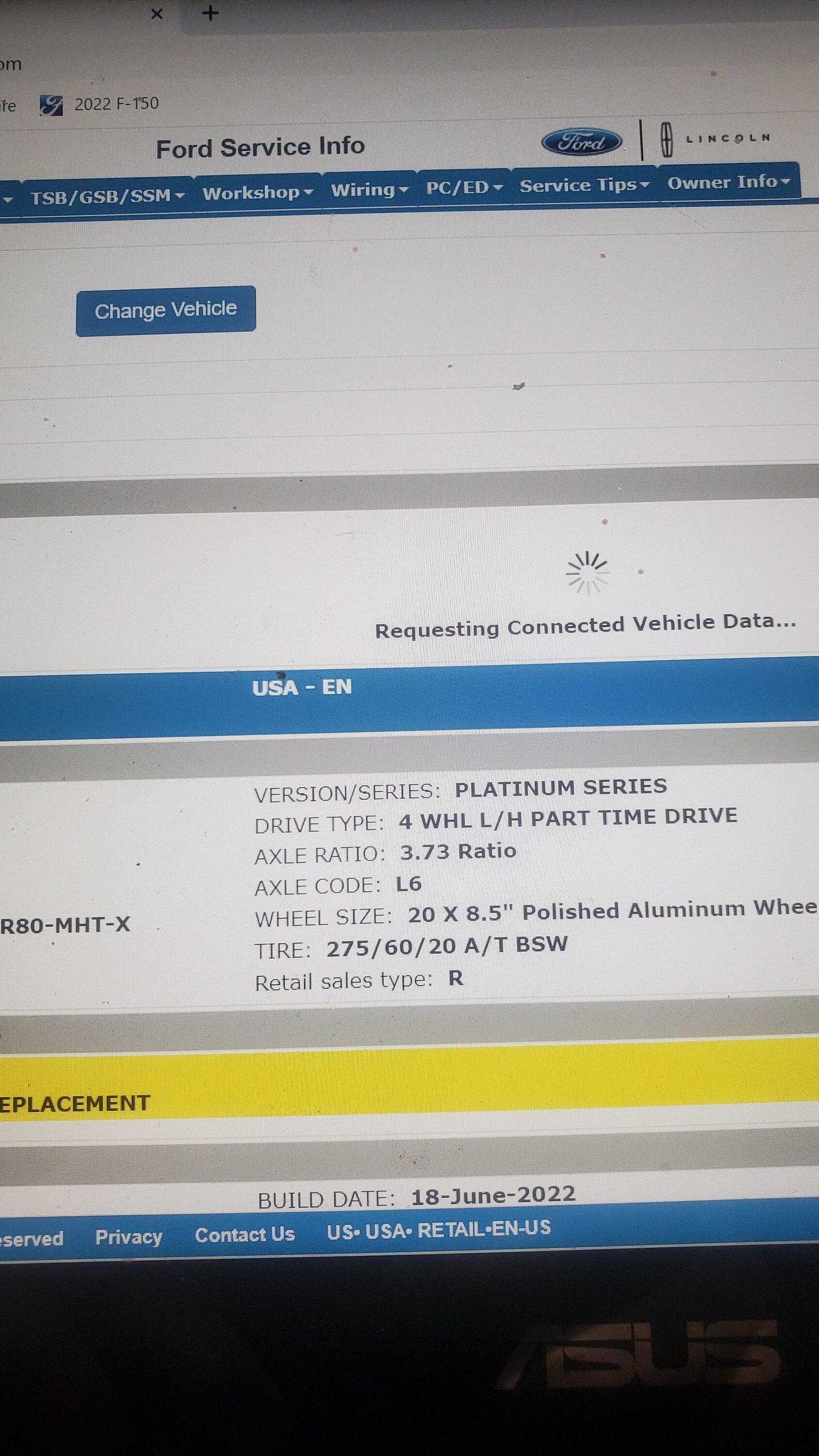

I finally got a sub to ford service info.
I am having issues with the vehicle ID tab. Do I need this to check on things? I get spinning wheel. Everything else works but I feel that without this data there is no way to check status of updates or know any past history?
This is what I see when I bring up the site. If you're looking for OTA information it can be found under connected vehicle.

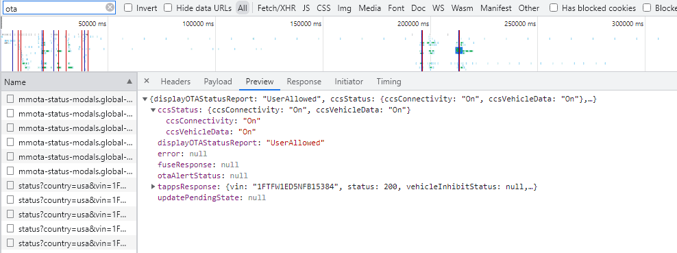

Mine says this - no option to expand the fuseresponse
Mine is showing this exact same thing.
I'm guessing that just means that we are red-headed step children and aren't getting a spot in line.
Been waiting since getting 3.5.2 on September 20.
