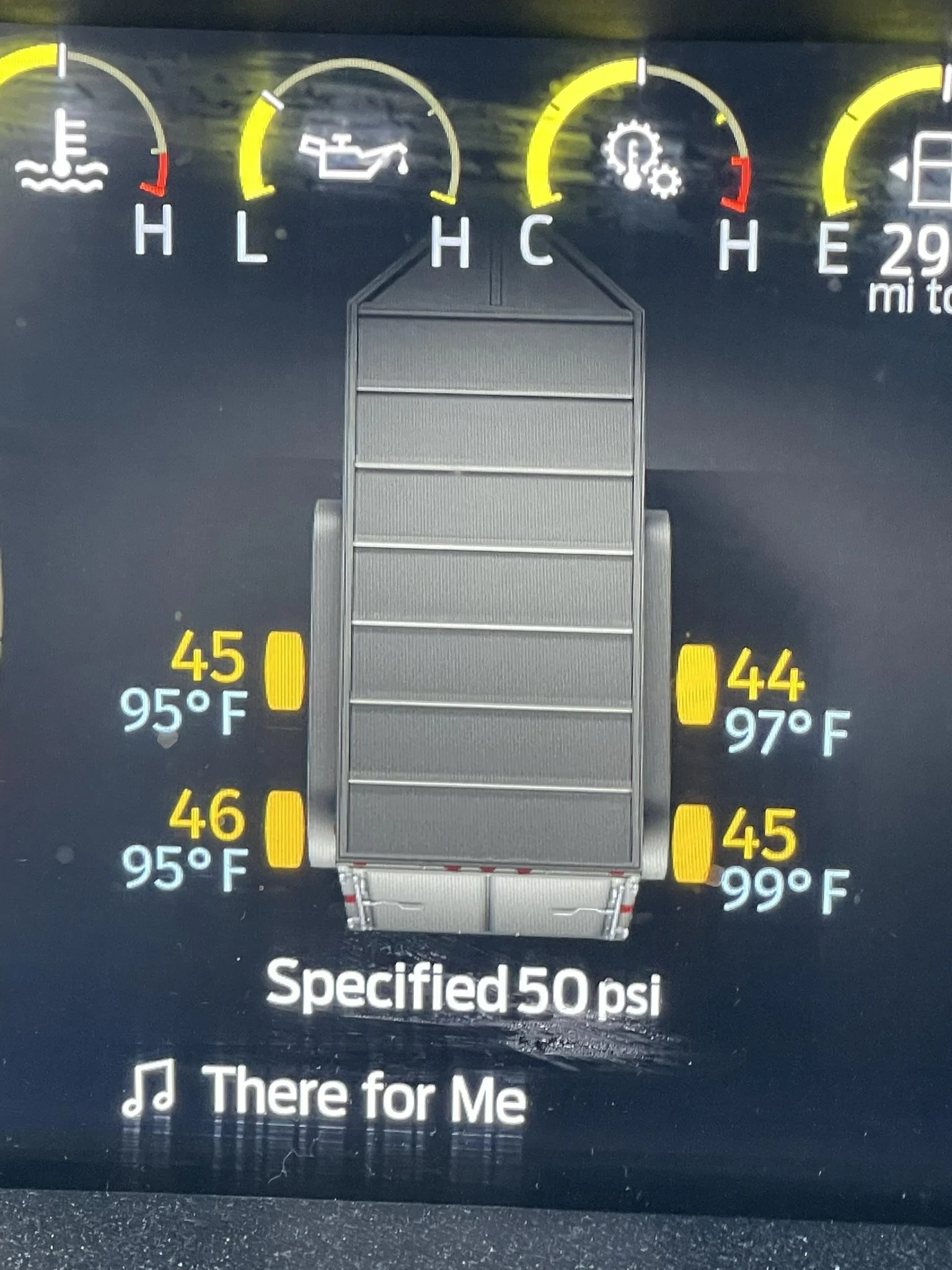

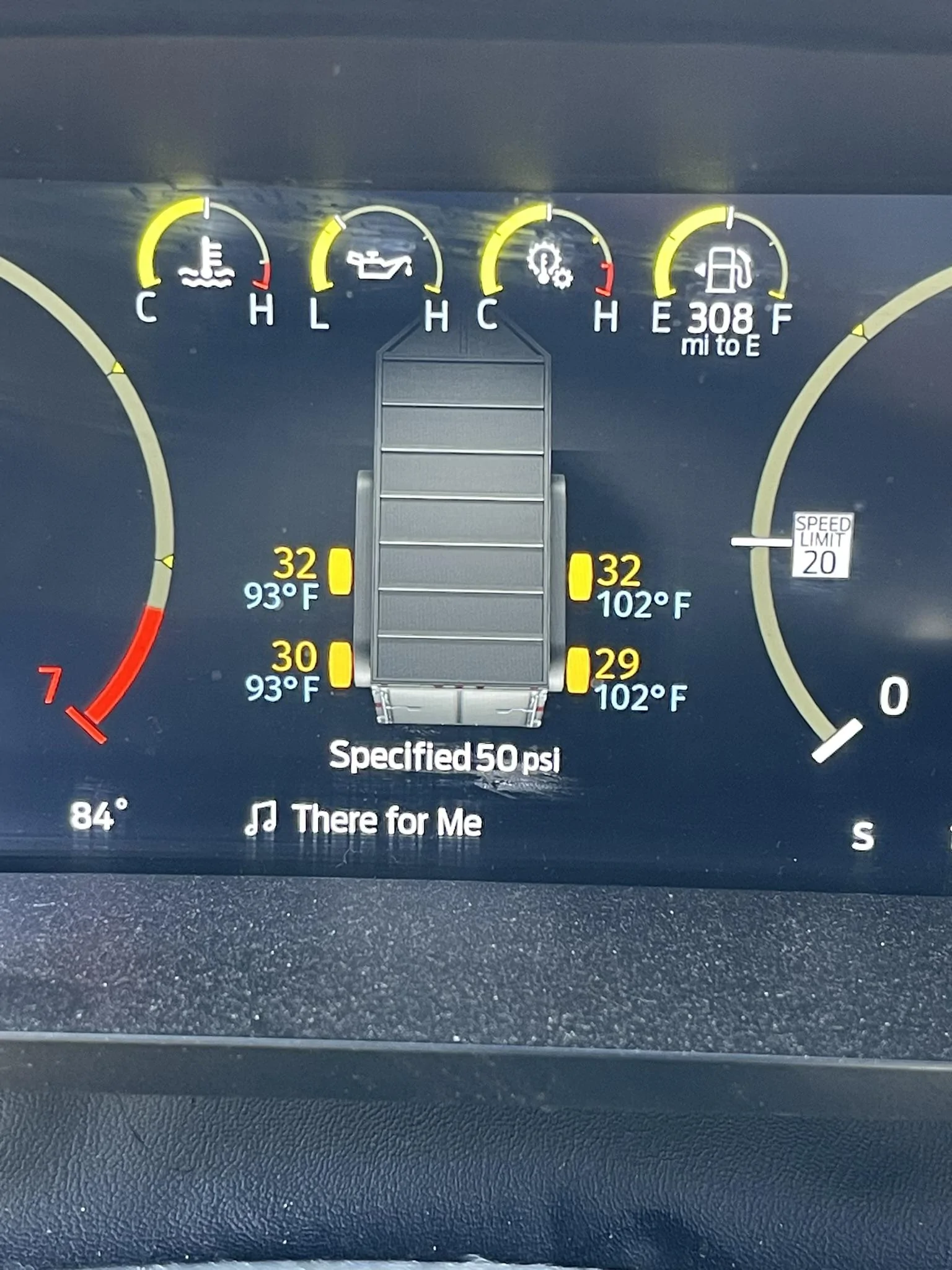

Today after 1-2 years of reading and software updates from ford using FDRS it works!!! Have this installed on my car hauler that I use for my Polaris Utv.

That is a nice addition. Is it only available for Lariat and above? Do you need FDRS to make it happen? Is this a Ford TPMS ? Or is it 3rd party?

I have a tremor and software was there in truck just not updated, do I used ford diagnostic repair software (FDRS) and also with the help of the trailer kit/tpms , if you can select tow in the display of the dash then you have the software, I'm guessing you don't?If not then you would have to update the software and also get the rear end harness for the truck to hook up to the 7 way
