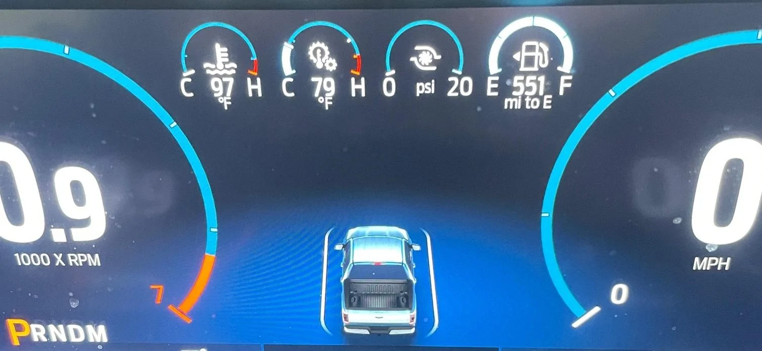

Got a big tow coming up and between the heat the country is having now and the mountains we'll be crossing, wondering about gauge choice.
Currently, oil pressure, coolant temp, turbos and fuel.
I like the turbos showing, so I can try to stay out of them but thinking trans temp should go there this time.

I would turn Oil Pressure into Trans temp. If the oil pressure is above, I think 10 or 15 PSI or so, the gauge sits in the middle. These trucks have a 2 stage oil pump. The oil pressure can get as high as 95 PSI, I believe. Your gauge would still be in the middle. The truck will alarm if your oil pressure drops. Trans temp I can watch it start climbing and do something before it gets too hot.

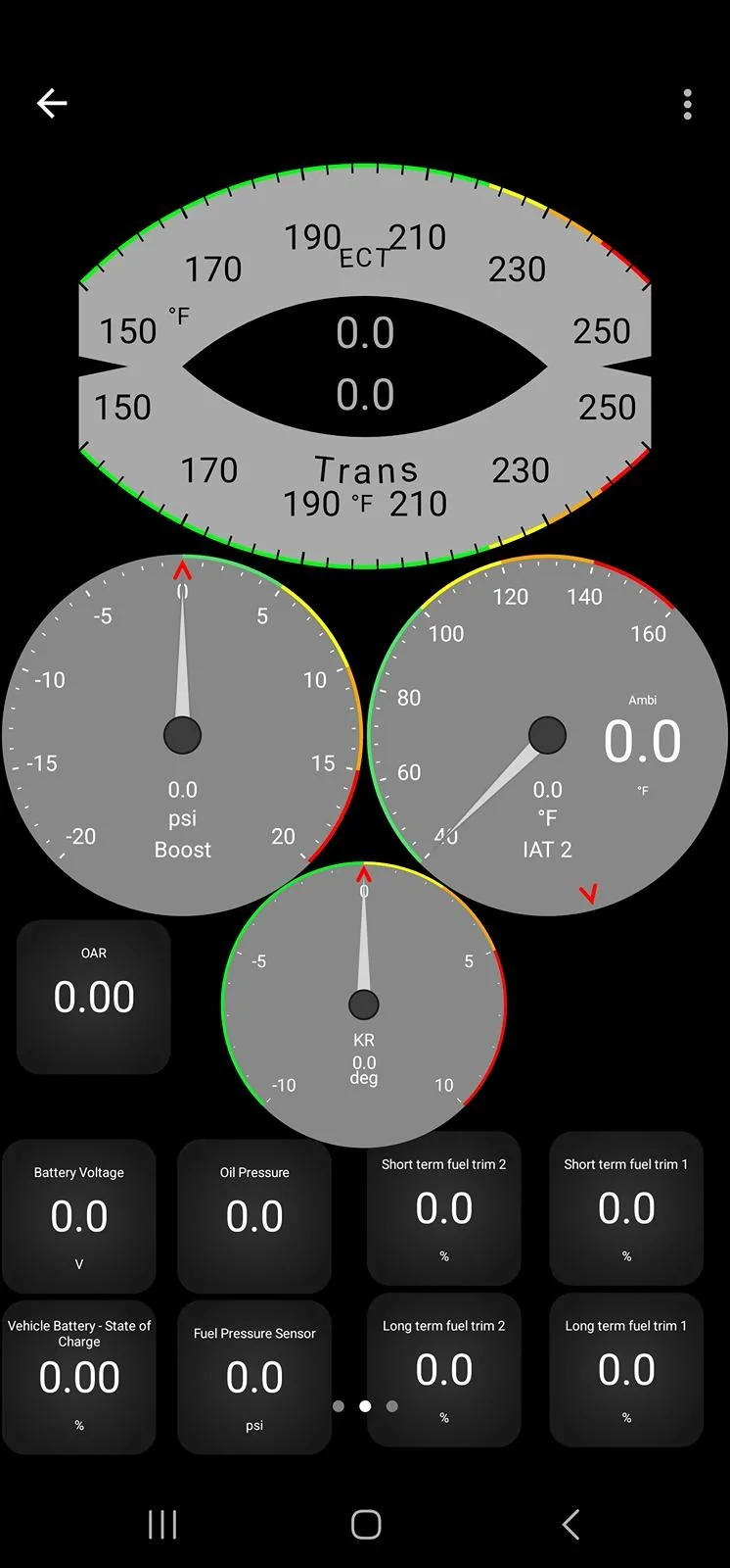

I would go with obdlink MX+ and use your phone. Pardon the somewhat unfinished look on the gauges (I'm in the middle of playing with how I want it to look). You can see actual temps, not just what the dummy gauge shows you. (Unless you use FORScan to enable engine and trans temp on the 12" display)
