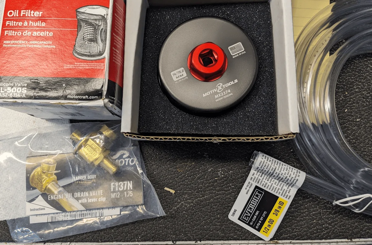

Have been using the standard fumoto valves for well over a decade on various vehicles.
Just installed one with the longer port early last month on the F150. Went with some cheap clear 1/2 x 3/8 tubing from Home Depot to make it less messy going forward.
