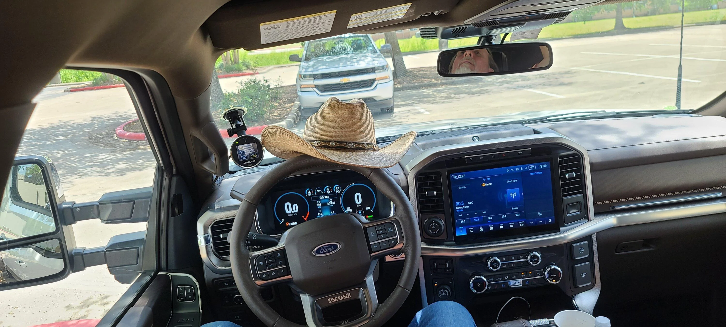

I'm currently napping in the shade of the hospital parking lot. If you zoom, it's 100F outside, yet 66F inside, and ZERO rpms. :)

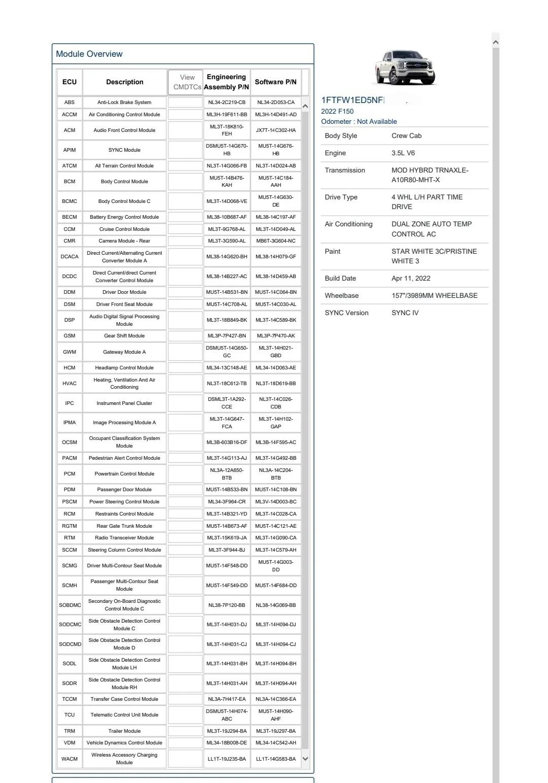

Yours is first. (39 modules listed)
Mine is second (41 listed)
Any idea what SODCMC module is? It is on mine but not yours, while you have three that are not on mine (SCMG, SCMH, VDM). Sounds like Side Obstacle Detection Control Module C could have something to do with park Assist..

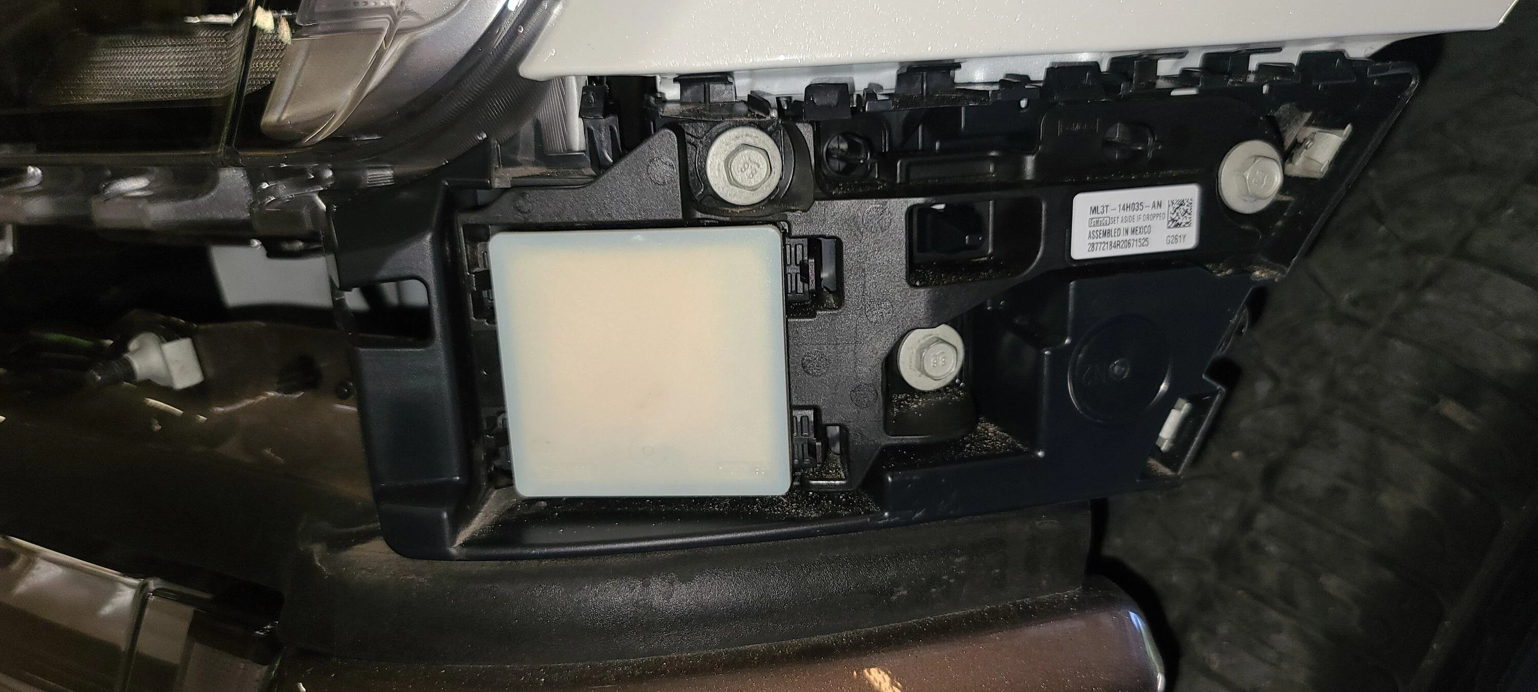

I do have the side obstacle detection sensors. You can see them underneath the trim that I removed to pull my grill. But if I'm missing the module itself? You could have just figured it out!
Ford F-150 Front parking sensors. 20220512_124200
Ford F-150 Front parking sensors. 20220512_124222

I agree you have the sensors, but you do not have that particular SODCMC module and what ever functions that module performs, according to your listing. I think we may have discovered what module Ford ran out of that forced the deletion of Park Assist.
From another forum:
SCMG controls driver massaging seats, SCMH controls Passenger massaging seats
SODCMC - Side Obstacle Detection Control Module C
Part number: ML3T-14H031-DH
Calibration level: ML3T-14H031-DH
Strategy : ML3T-14H094-DH
Not sure why the screenshot above didn't show the SODCMC?
Below is my FDRS full module list and it is present in the list.
SCMG & SCMH are multicontour seat control modules
Well, that shot down my theory...:D
In FDRS, the list of up to date modules doesn’t always populate fully the first time. Click the ”All“ tab and then reclick the “SW Updates” tab and the list should refresh. Might have to do this more than once.
Napping with eyes wide open. Nice if you can do that. ?
Good point. :)
The back story, short version......
Family reunion weekend. My 90 year old dad drove 200 miles to get here. 5 minutes after arriving he falls and breaks his leg. Mom's in a wheelchair. Sister (lives with them) is sick.
So me, 64 year old, ain't exactly a spring chicken. I'm at everyone's beck & call fetching this and that, giving rides, answering 1000 questions.
I'm tuckered out and was trying to recharge my batteries for a while in my luxury yacht on wheels. :)

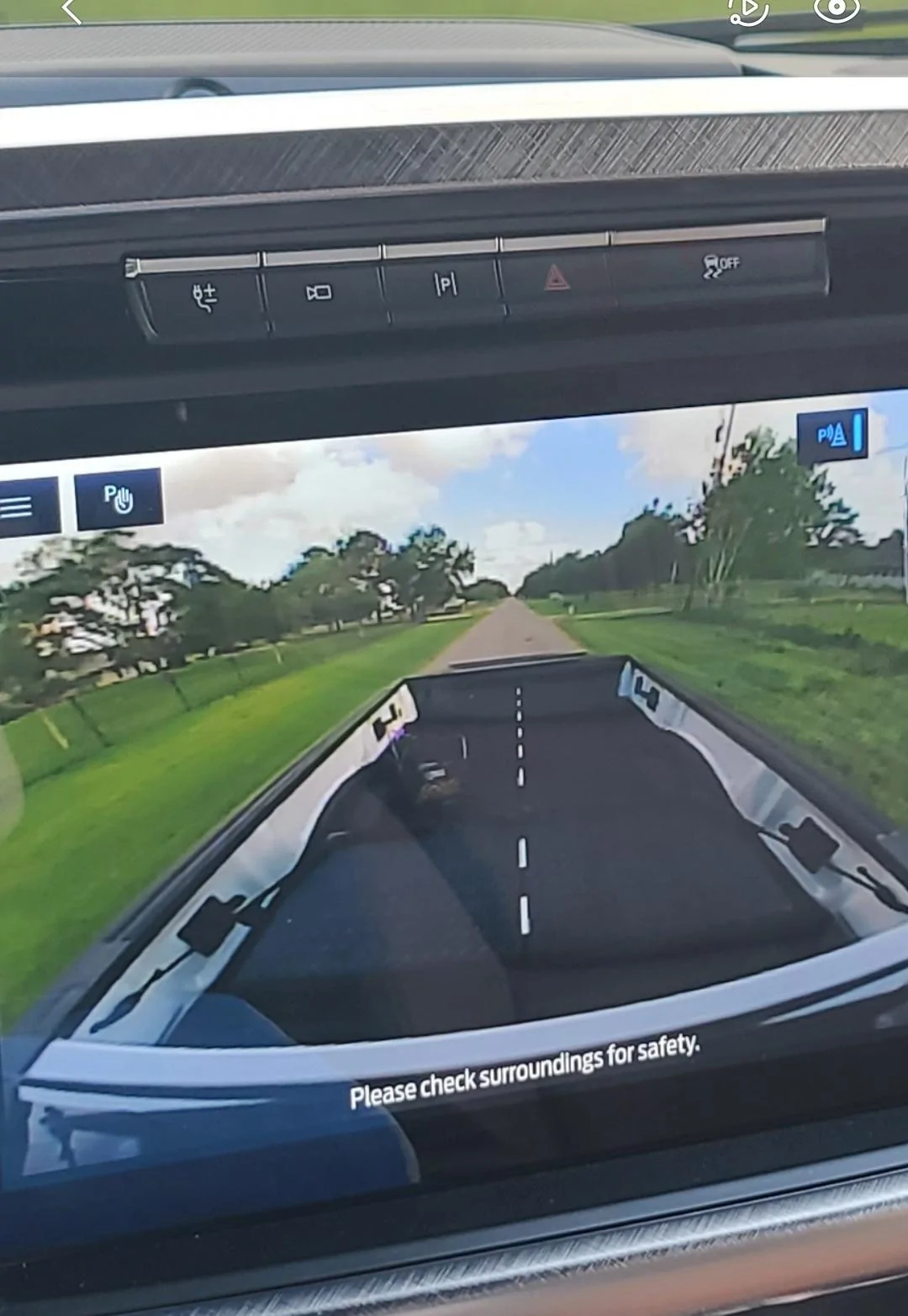

That was the button I was asking you about earlier @Snakebitten. To me you have everything BUT your programming for Park Assist isnt enable for it. SO Id be curious what happened if you did enable the programming.
There are no extra modules for park assist. Its the sensors and the IPMA. So I really would love to see what the heck the reason for cutting it out is. The sensors are there. THe park assist button is there. THe programming is off though.. I would understand if the sensors were gone but there arent. Really curious to me.
@Jesse-Infotainment
This is the result of hitting the P
Note: I don't know what it should be if Park Assist wasn't deleted

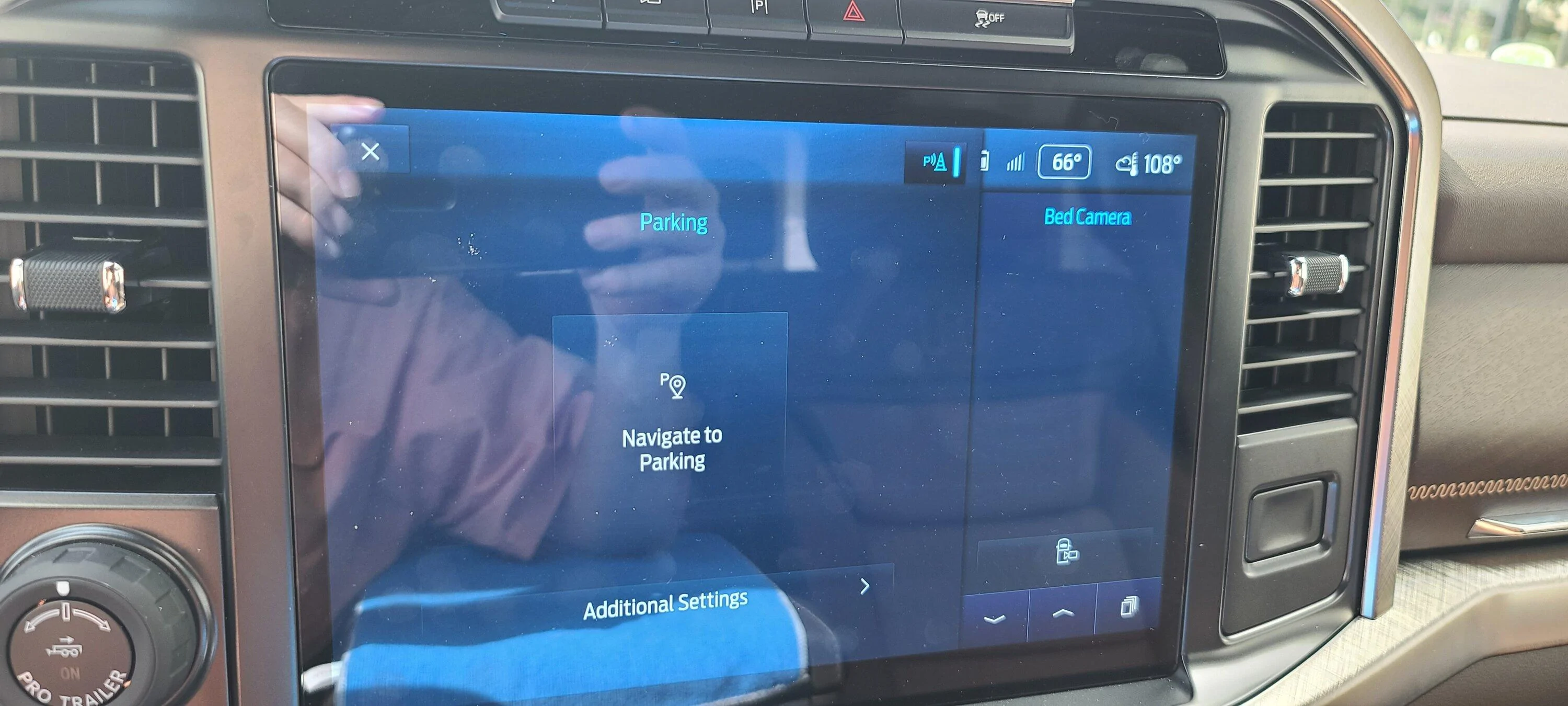

This is what "Additional Settings" gets you
Ford F-150 Front parking sensors. 20220612_164811

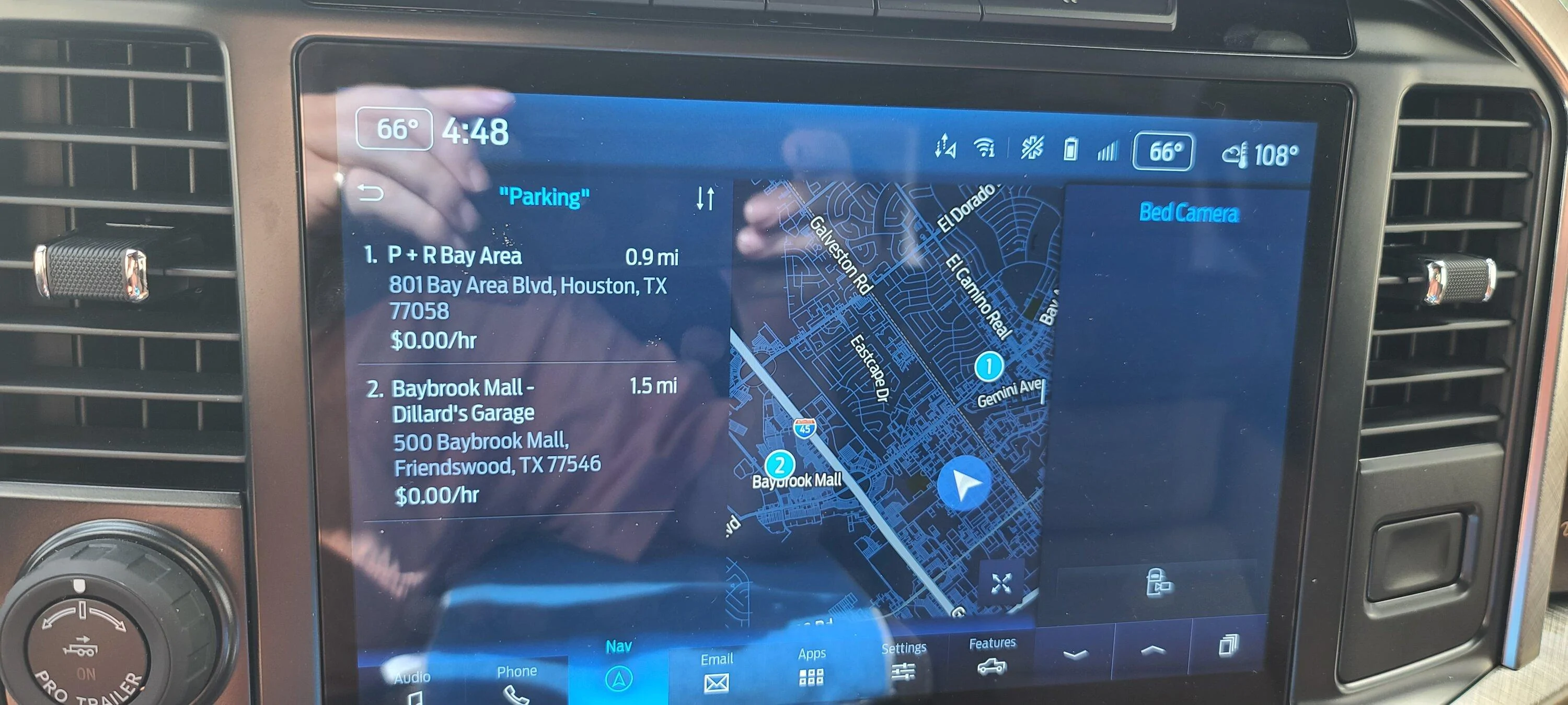

This is what you get if you "Navigate To Park" (basically map based data)
Ford F-150 Front parking sensors. 20220612_164838
