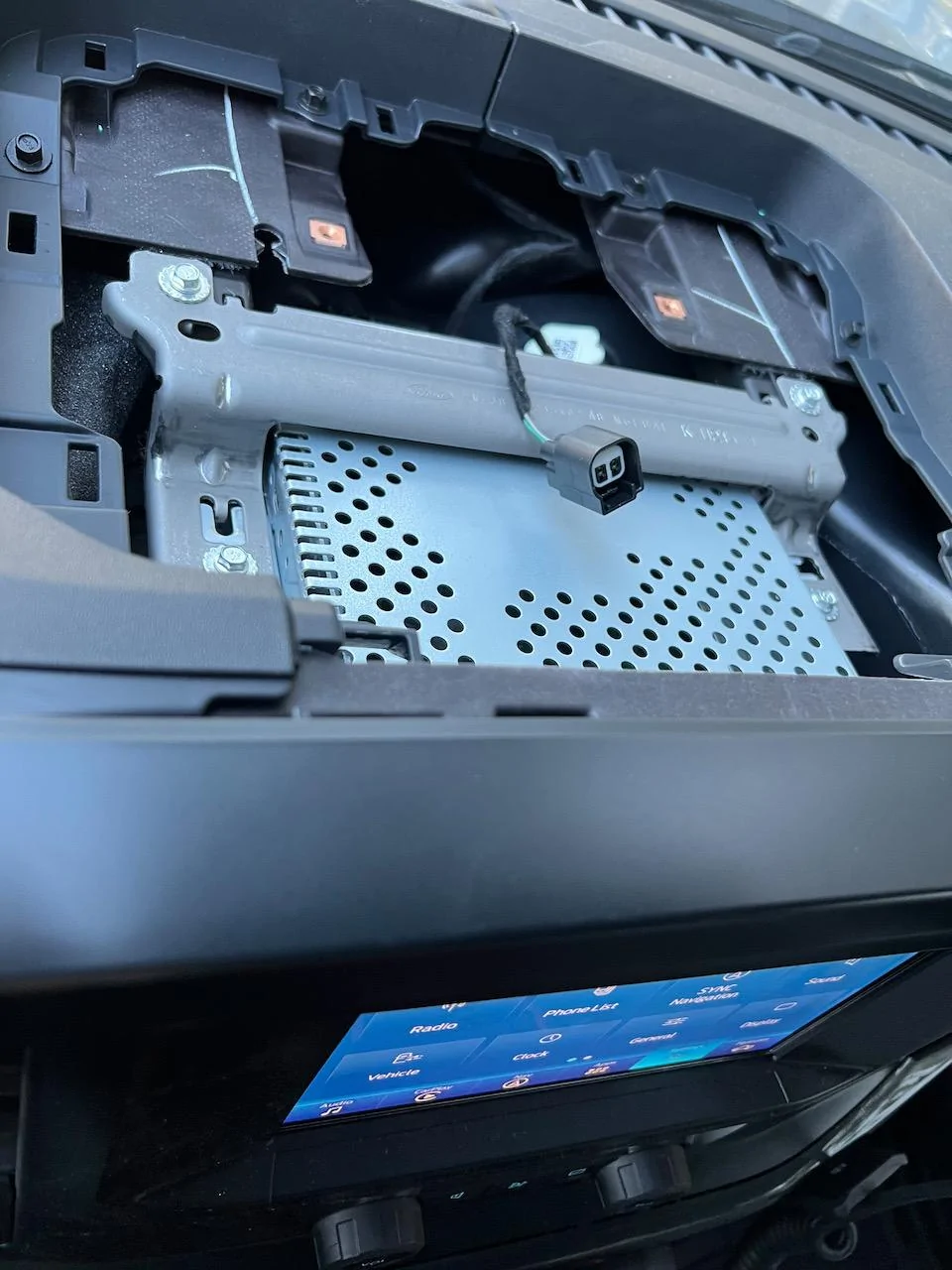

in my 2022 STX Found a plug under center dashboard tray. Not sure what it does.
is it power or sound ? If anyone knows

It's sound. There's a small speaker that gets bolted down to those copper coloured threaded inserts. Not sure if yours was supposed to come with a speaker and it was forgotten, or if it's limited to certain trims.

I am wondering if my base model 8 inch sync 4 would produce sound through it. I guess only one way to know
thanks!

My XLT has the speaker and I had the 8”
I am defiantly going to find a used center speaker to test this out. Thanks for the heads up

I wouldn't bother adding that speaker as many actually choose to unplug it. Since it is not stereo, it doesn't improve imaging and only slightly increases the overall volume. You would be better served replacing the door speakers and A-pillar tweeters with something like the OE69C-FD from PowerBass if you are interested in upgrading your factory audio.

My B&O sound system has a speaker in that position
Yea from what I researched it does. I will find out this week if it works on the 8 inch screen and if anything else is needed.
