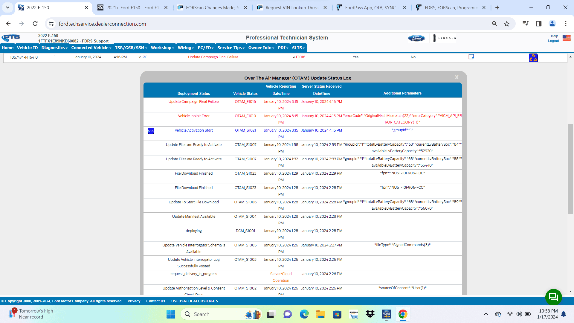

The reason the update failed is below. The VICM did not successfully put your truck into inhibit mode for the update install and it failed. I have never seen the "original hash mismatch" verbiage before and do not know what that means. I have seen updates fail many times due to VICM/API errors but not sure what the that term means.
Vehicle Inhibit ErrorOTAM_E1010January 10, 2024 3:15 PMJanuary 10, 2024 4:15 PM"errorCode":"OriginalHashMismatch(22)""errorCategory":"VICM_API_ERROR_CATEGORY(11)"
Likely file hash, so just some speculation on what it is doing.
It downloaded files, generated hash and compared to what it is supposed to have, that failed to pass because somehow file was corrupted when it downloaded.
I would think it would do a check on files before inhibit process starts but perhaps not.

OTA failed to an error I only started seeing recently. Not sure what it means. Battery seems to be ok, but it failed to go into inhibit mode.
