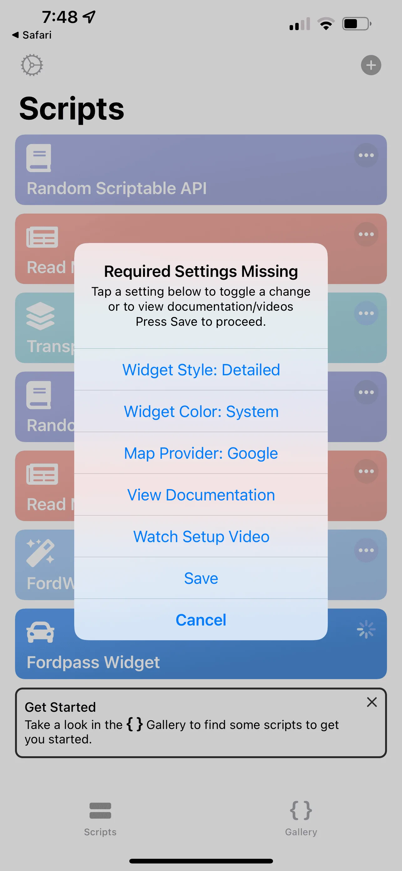

Okay, I must still be doing something wrong here. On this latest update, I no longer get the error I posted about previously, but I'm not getting prompted for login credentials. In the install video, it shows the FordPass username/password login prompts at the top of the "Required settings missing' popup that comes up once the widget is installed. I get that popup, but it doesn't have the username/password fields (see attached screenshot). So the widget is not working for me. I've uninstalled and reinstalled Scriptable, the "FordWidgetTool," and the widget script itself. I never get the login fields, and so the widget isn't working for me. What am I doing wrong?
I have the exact same issue. In fact, having this installed now triggers an email about every 30 minutes, telling me my account has been locked.

Well, crap, if this widget might lock me out of my account, perhaps I'll stop trying. I don't want to lose access to the functionality I do have through the FordPass app.. @tonesto7 , any luck fixing the login token issues? Also, how can I start completely fresh? I've uninstalled/reinstalled already, but there's still no user/pass fields.

Logins are fixed. To clear everything open the FordWidgetTool > Reset > Tap on the instance listed

Still not working for me. I can reset the instance, and I can now enter my FordPass login credentials, but when I tap the "Region" field, I get the same error as in my original post in this thread. If I don't tap the "Region" field (it's pre-populated with "NA"--is that "Not Available", or "North America"?--it's unclear), and just tap "Get Vehicles", it doesn't find my VIN. When I manually enter the VIN in the resulting "Supported Vehicles List" pop-up and tap "Save VIN", I get the standard "Required Settings Missing" sheet. I then hit "Save", the progress indicator spins for a bit then stops, and it seems all is well. But when I add and configure a widget to my Home Screen, it stays blank, with the default "Scriptable" artwork displayed. No FordPass data.
What am I doing wrong? If it helps, I can enable debugging and send you the logs. And at this point, if I can get this working on my phone, I'd be more than happy to buy you a 6-pack of your favorite beverage!
