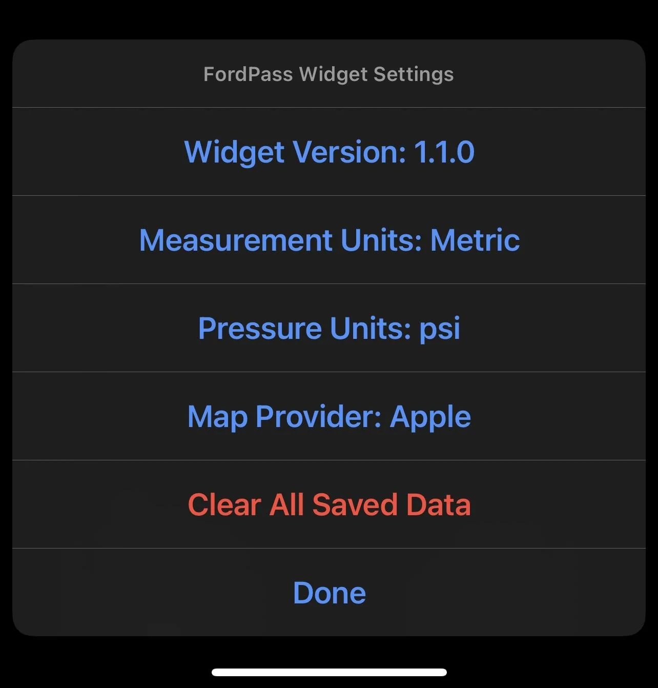

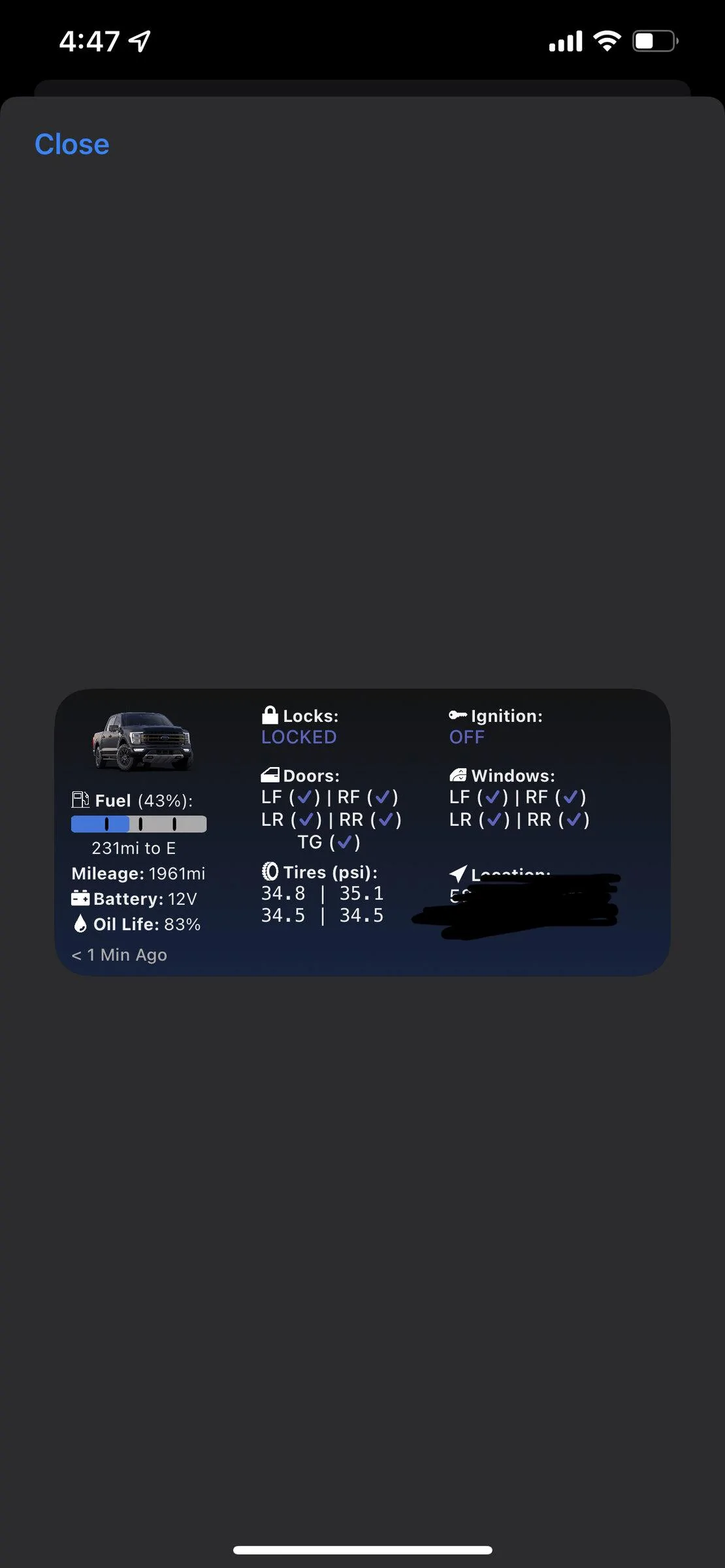

Is there a way to have the mileage in metric (I’m Canadian so need the kms) but still have the tire pressures in PSI?
when I change to metric it forces the tire
Pressures into kpa even though the settings say psi
Yes, tap on the widget, and when it opens the scriptable app and shows the menu. Tap on widget settings you will see the setting there
yes I have the settings as metric and psi. But it still shows as kpa on the widget
Ok. I can duplicate. Will be fixed in the next release
