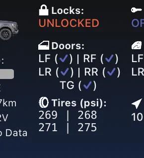

This is amazing, thank you so much for the effort!
The only thing in noticed in mine is that the tire pressures show up wrong. I am using the ‘METRIC’ option though so maybe it’s something messed up with that portion of the coding? Everything else appears correct.
Forgive me for my ignorance... Do you metric users view pressure in PSI? Because the tire pressure data from ford is Kpa.

I like psi for pressure but yes, Ford uses kPa. I wish there was a way to change the values on the instrument cluster to be all metric with the exception of tire pressure and boost…nobody actually uses kPa lol.
I was more stating that the widget says it’s psi but appears to show the value in kPa.
Thanks for pointing that out... The release I'll be releasing later today will show correctly and will also allow you to use metric but set the tire pressure as PSI
