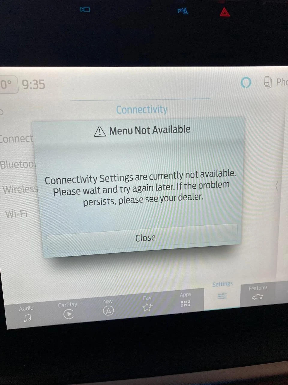

Can someone tell me what I am doing wrong?
I have a 23 King Ranch that the Ford Pass worked a couple days. then seemed to freeze. I added the truck on day one and all seemed well, although the remote functions never worked.
So, I deleted the app on my iphone , re downloaded , logged back in, re-added the truck twice now.
did a factory reset on the truck system , twice.
when I try to activate it still just times out. I never get a pop up on the truck screen.
I am connected to wifi at my house in the truck, carplay works, sync nav works.
when I go to the connectivity screen it shows "not available" and cycles back to the previous screen.
Sync 4, Software Version 22230_PRODUCT
Revision 546
Ford Motor Company
Software Updates 78:55:cd:6d:d6:5f,28:38:5c:4a:0f:00

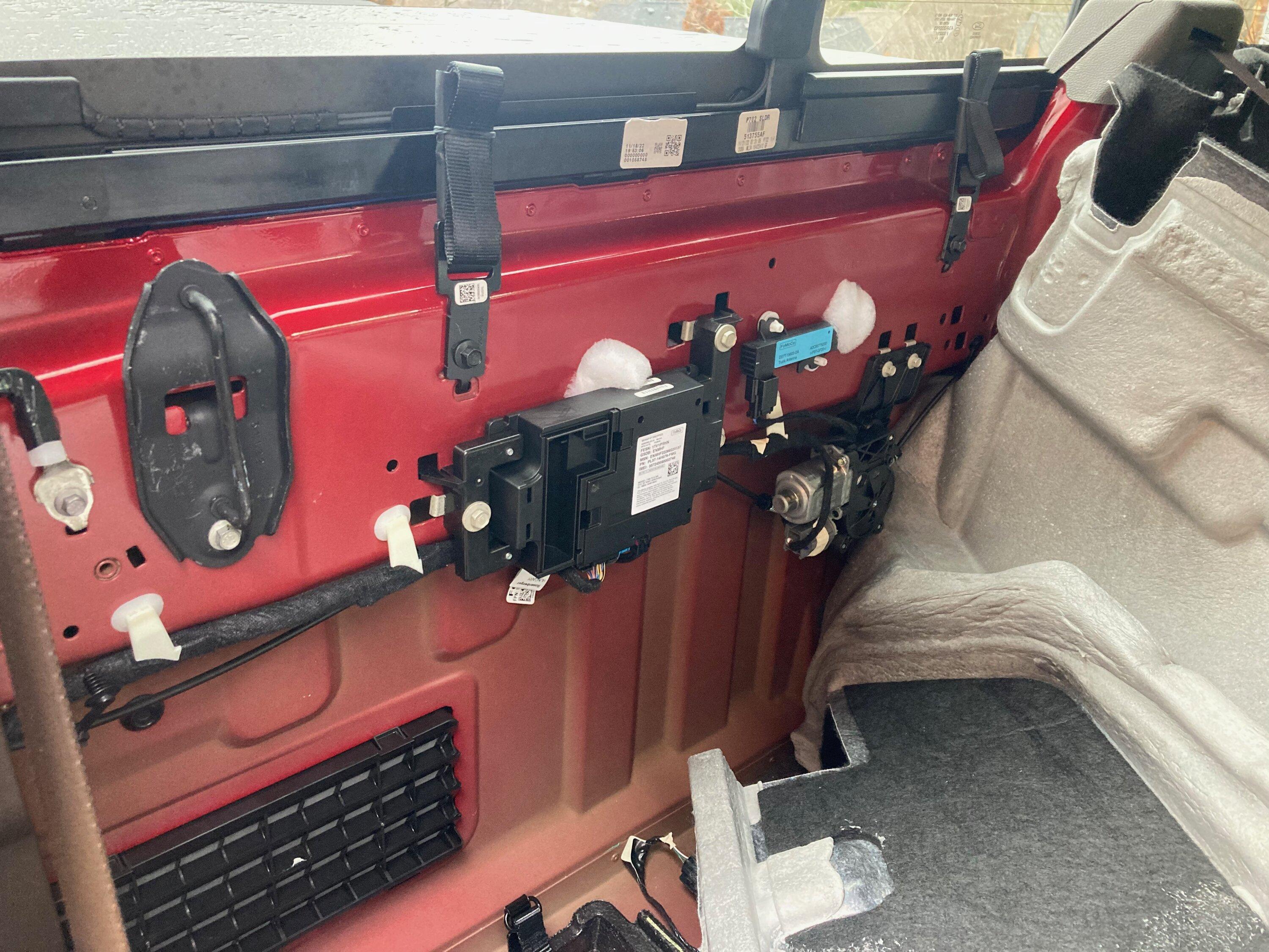

Your TCU is locked up. If you unplug it overnight it should reset. It’s on the back wall behind the passenger seat. Unplug the largest connector closest to the rear passenger door.

There's a number of 2023s (F150s and Broncos) with this issue, it stems from a glitch with enabling OTA updates. I pulled the TCU power plug then once reconnected I re-added on Fordpass and it started working. Dealer advised an OTA update is on the way to correct this in late January or early February.

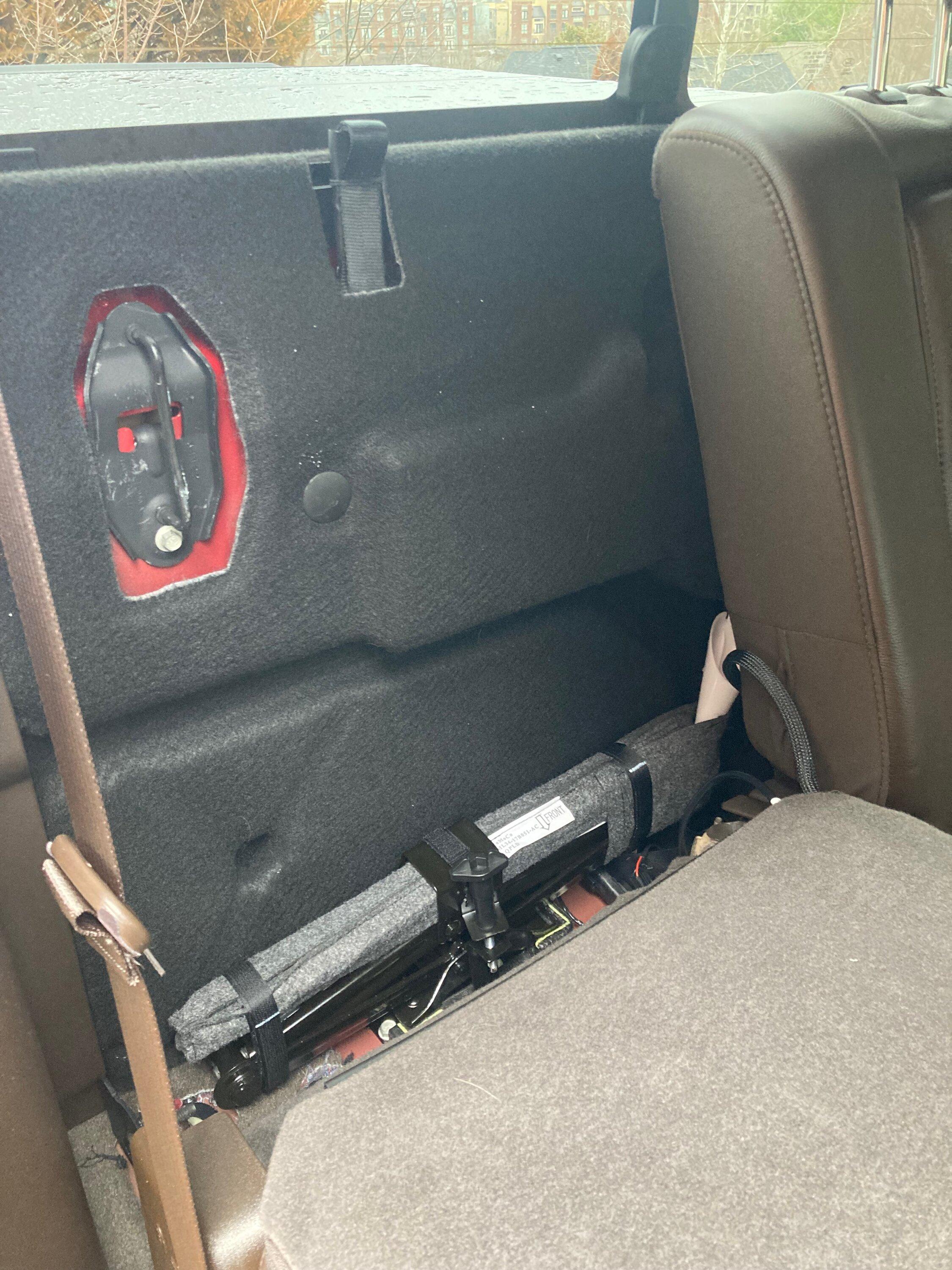

there is only a jack on the pass side. I even pulled up the black "carpet" back there and its not hiding under it
I am going to look again..
Behind here.

You can pull the upholstery away from the wall.

you guys are great!! thanks!! once I lowered both seats and pulled all the black insulating fabric off I found it.
unplugged the biggest plug and will let it stew for a few hours. if that doesnt work, then overnight
