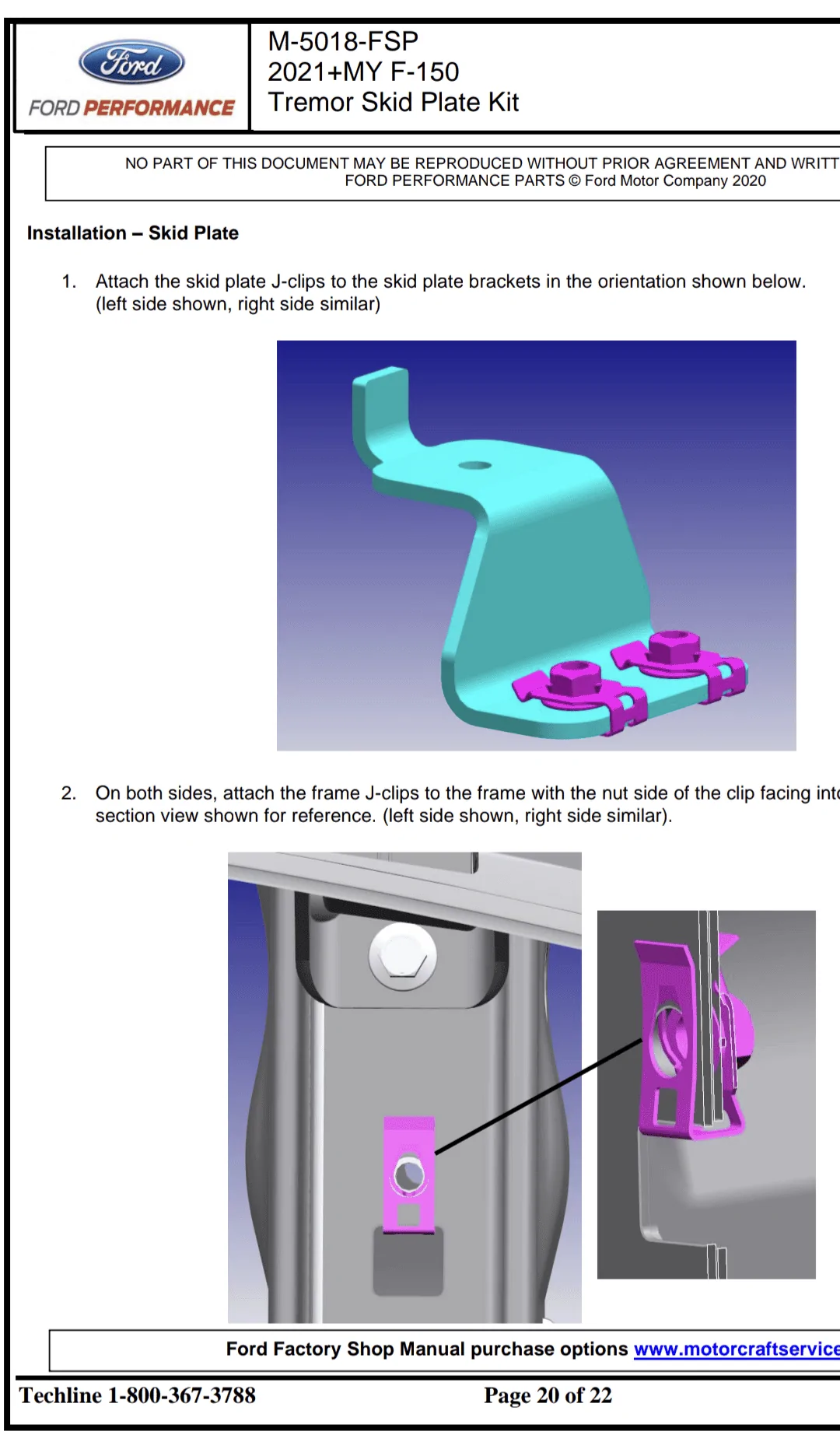

Someone pointed out in the other thread the skid plate brackets fit in the front hole, not the rear where intercooler mounts.
Look at the instructions and it appears to be correct. It shows using the front holes behind the tow hooks.

I'm thinking the kit uses the front set of holes (closest to the bumper). With my truck being an EcoBoost the rear set hold the radiator or intercooler.
Page 20 of instructions shows using the front holes for the front brackets. Good luck with the project. :)
