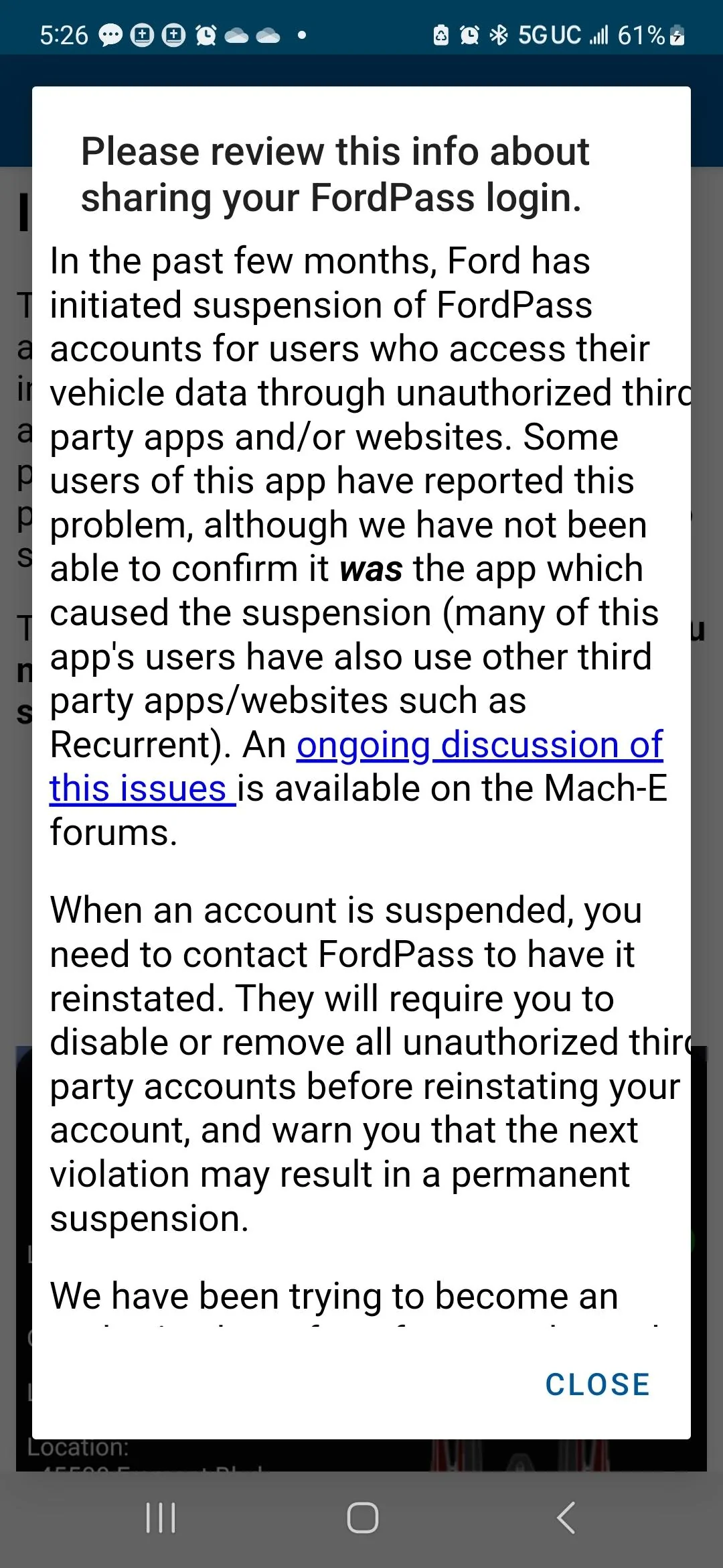

For those using the Ford Pass Widget:
Ford F-150 Ford Pass not updating/working. Screenshot_20230323_172635_Ford Status Widget
