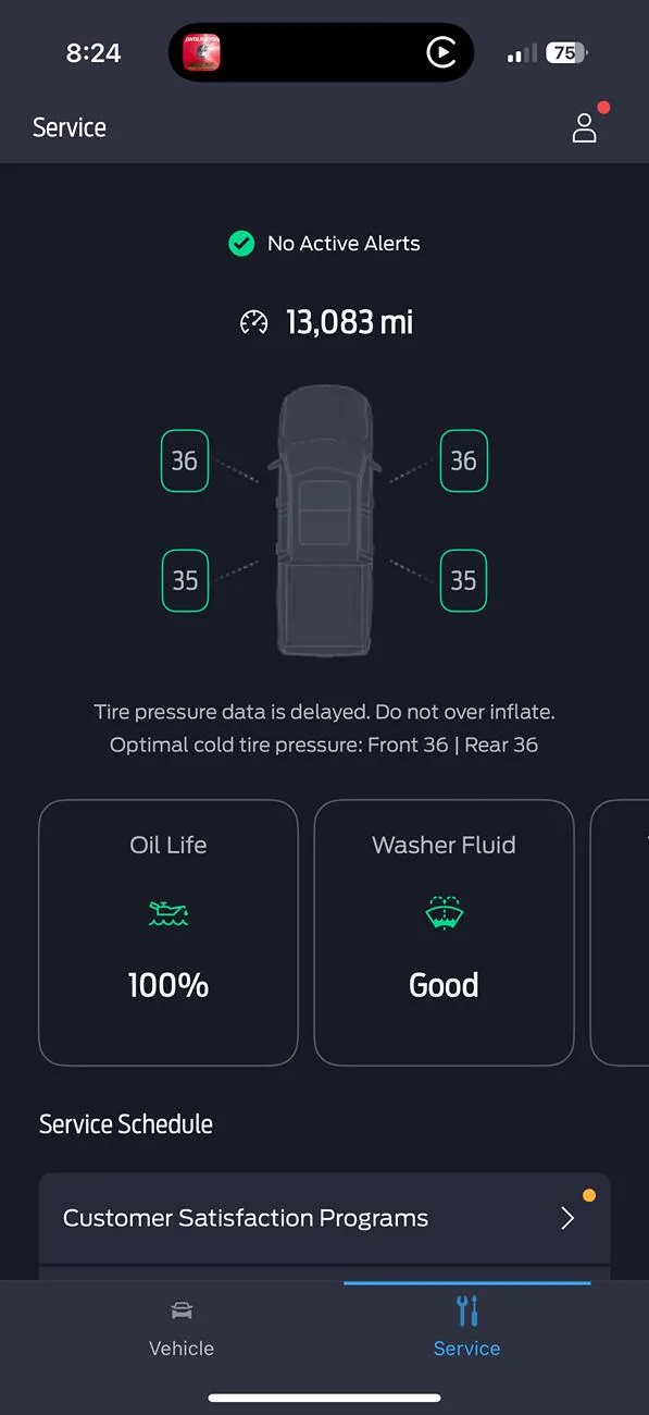

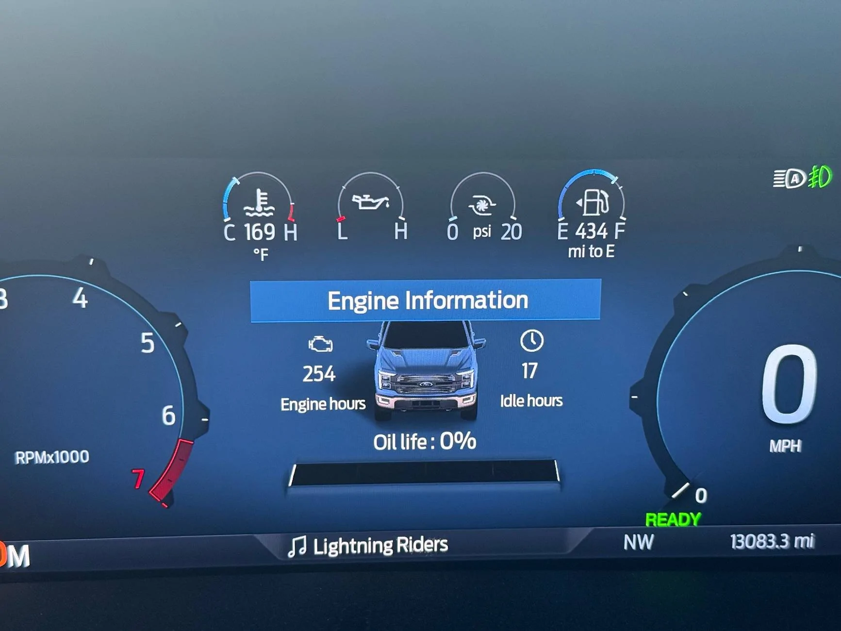

I am having the same issue. Just had the oil changed a couple weeks ago and last week it dropped from 91% remaining to 0% remaining from one start to the next. The FP app showed the correct 91% remaining. I waited a day then reset the oil life to 100%. Today it dropped from 100% to 0%. FP still shows 100%.
