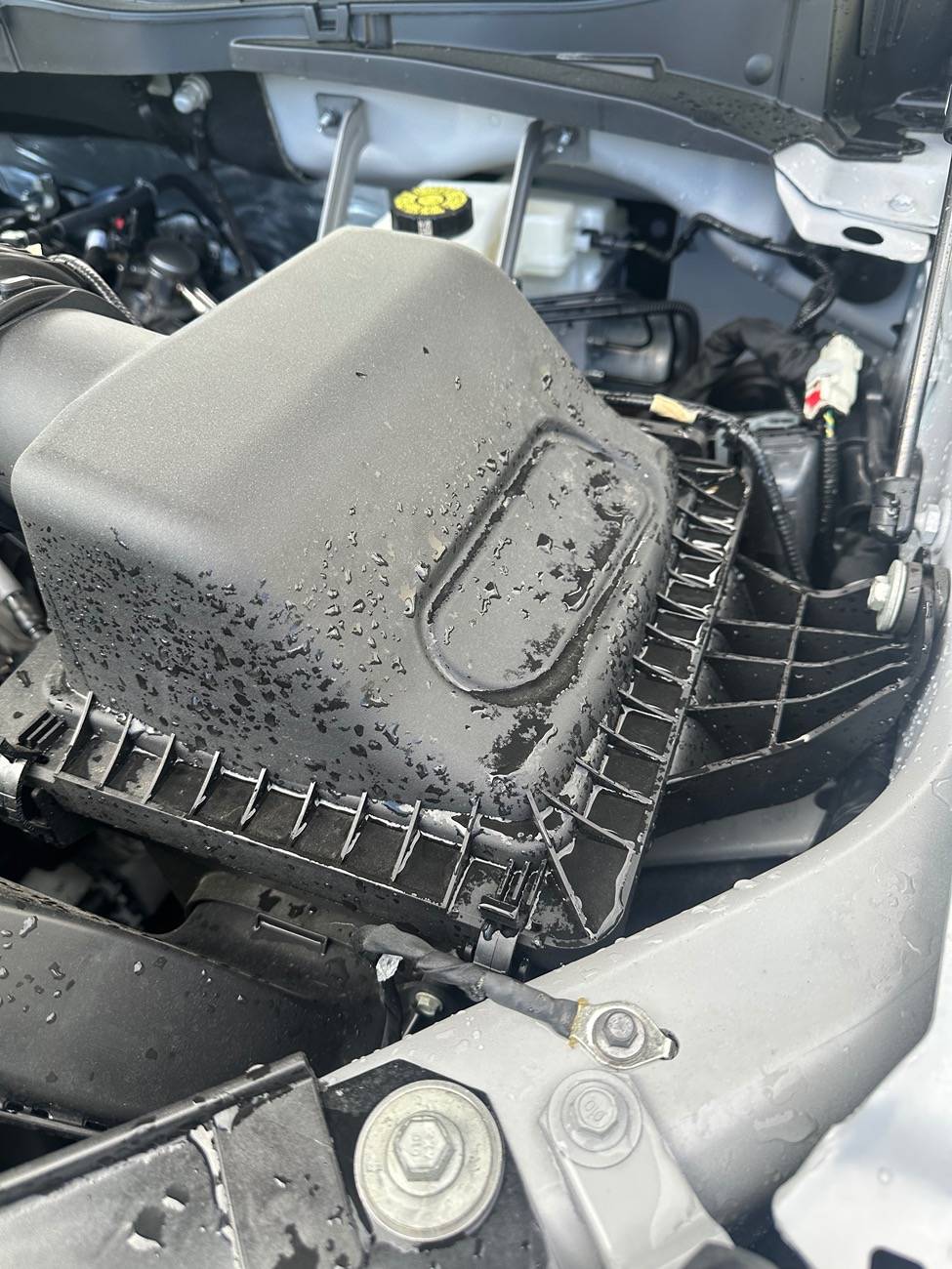

…shouldn’t a closed box be ran to avoid water from saturating your filter and potentially causing damage?
I just washed my truck and there is quite a bit of water sitting on the OEM box. See attachment for picture.
I wanted to run an open box because, you know, more sound. But seeing the amount of water it would be sucking up has me rethinking. But a heavy rainstorm would introduce a lot through the inlet anyways. I dk?

CAIs are mostly closed systems, so you can pick a system you feel comfortable with. While not as loud as an open air filter element, they use shorter and larger diameter intake tubes resulting in altered throttle body sound. I will say they aren't that much louder than stock, but you'll notice it.
I'm more curious how that much water go under your hood just by washing it. ?

All CAI systems are of the closed box design, as you were referring to. Any open style, like what you’re alluding to, is not an actual cold air intake system.

Not sure, it’s a Tremor so possibly the hood vents let more in

U would need total coverage of the intake diameter to suck in any kind of water...as in submerging it underwater...a couple of drops from rain or washing will probably not even make it past the filter
