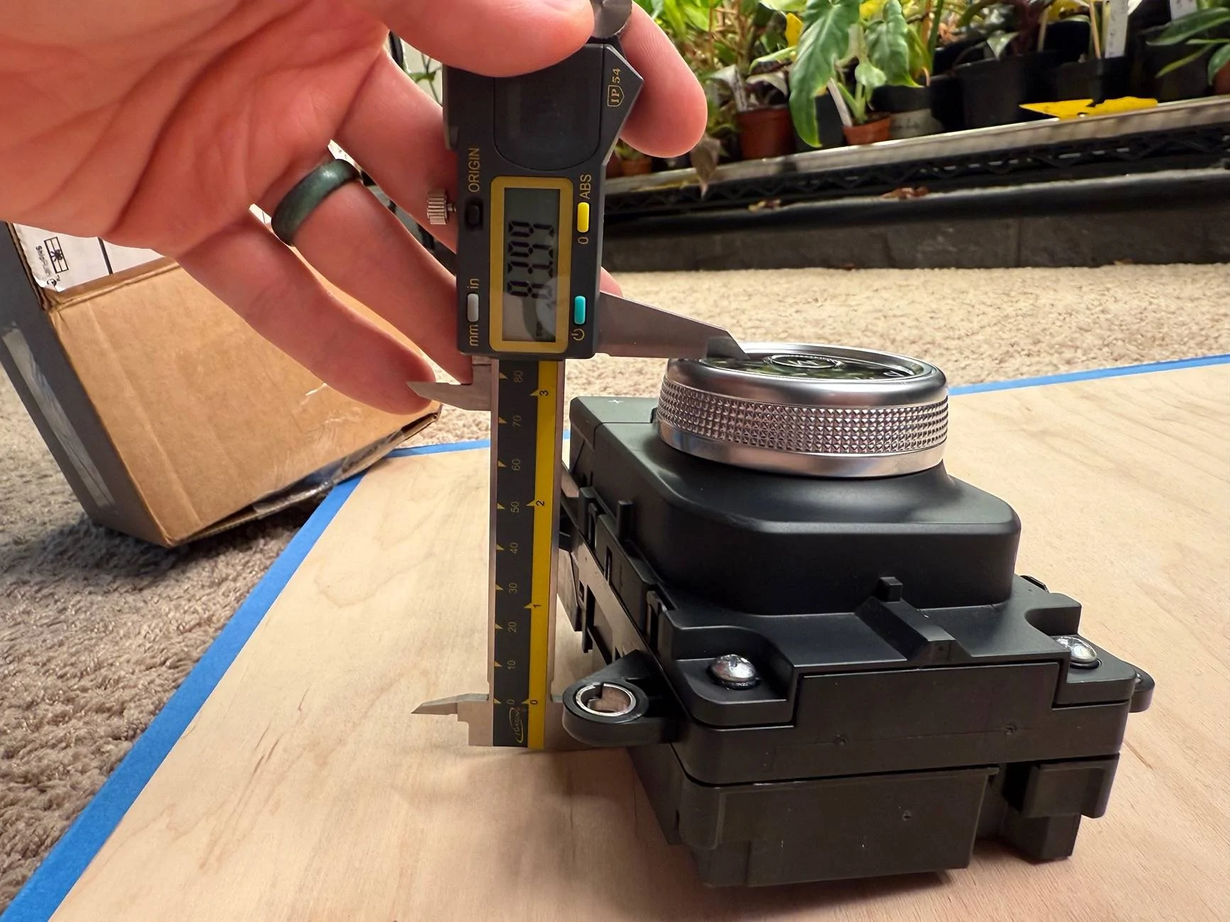

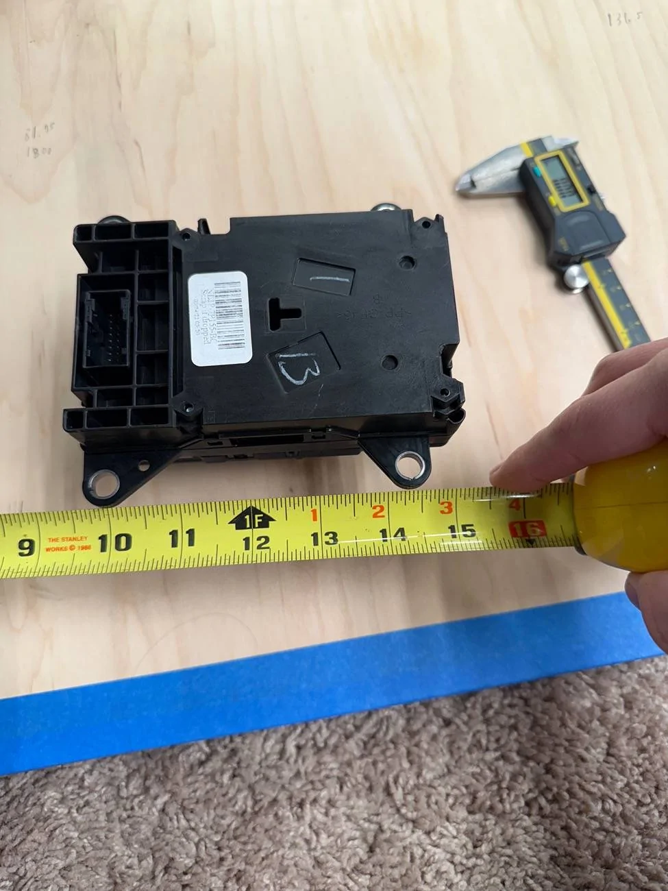

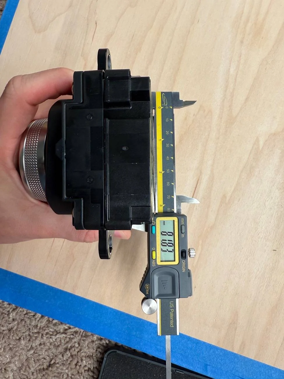

trying to find my adult calipers, overall case length is roughly 136mm
I can measure anything else you want too
We mainly need the 4 mounting holes center to center (left to right and top to bottom) and the length and width looking from the top. Trying to ensure it will fit inside the already-designed 3D cubby.

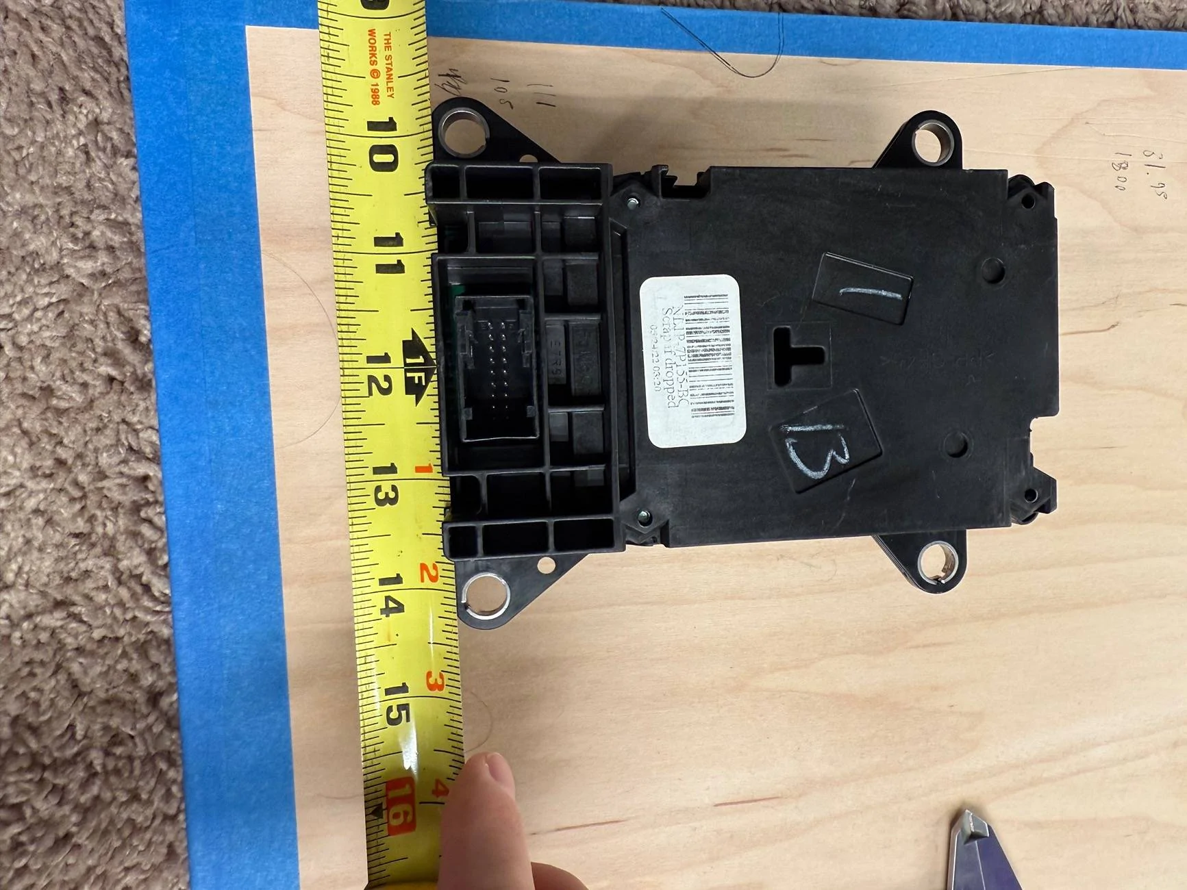

Center to center mounting approximate
width 105mm
Length 111mm
It might require a complete rework of the cad file. Looks like the opneing is 85mm wide x 100mm long.

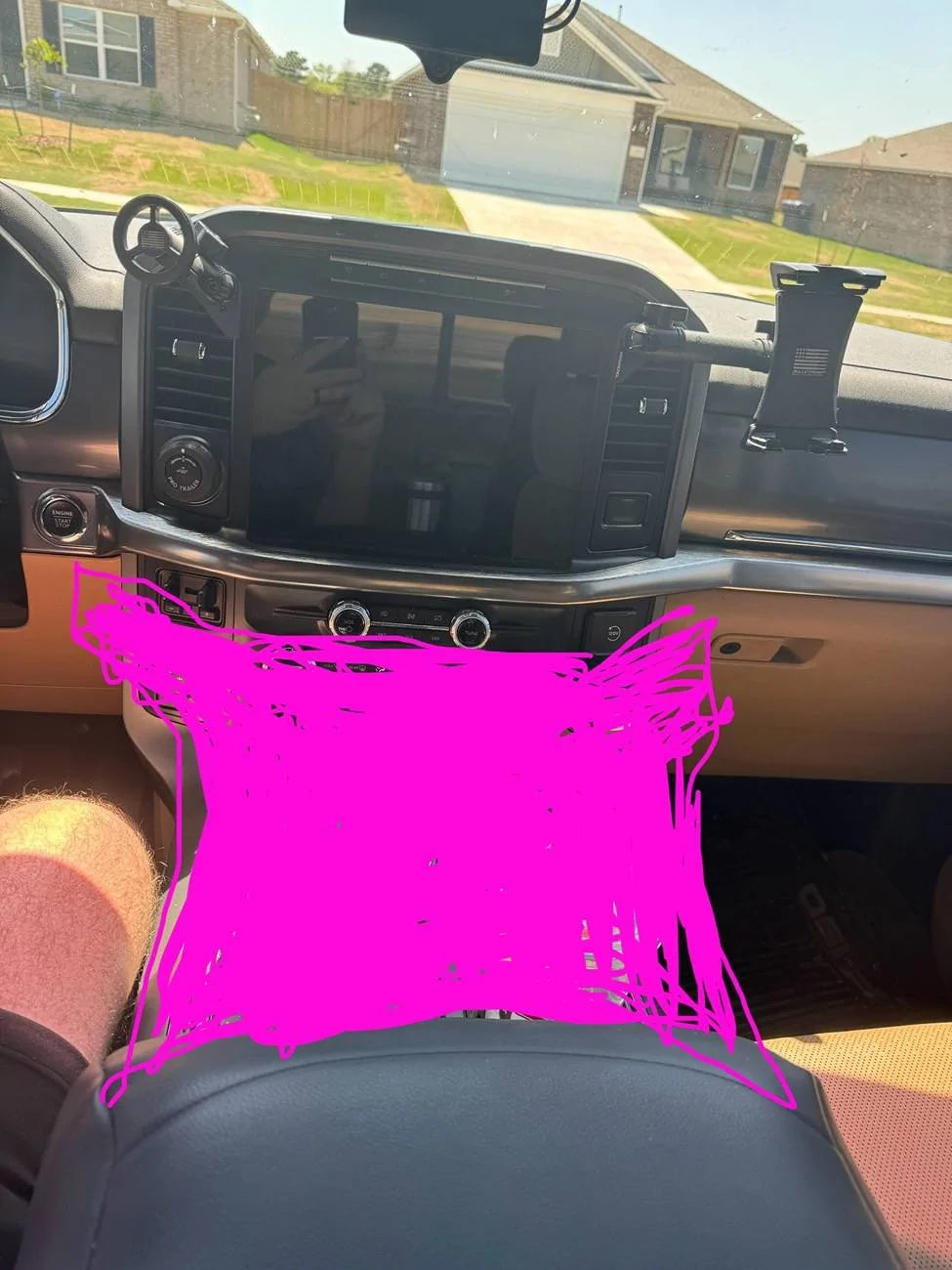

Makes sense as to why it wouldn’t fit there
now I kinda want a tray that would go across the bottom of the screen with inserts fit for fast food condiments and drinks / tray space with cup holders expanded / flat inserts for the cup holder (make a really nice large mouse pad with the console lid as arm support)
(as my truck doesn’t have the work surface I could be happy having it go forward and expand out over my leg some)
Idea being that if the gear shifter could be on a tray mechanism so it can sit down low there in the pocket of the GSM, or it could be lifted out and put into the side of the large platform easily.. (pardon my chicken scratch hot pink coloring trying to show what it could sorta look like) (and covering the temp sensors wouldn’t be an issue with unreal theme on screen)
