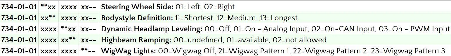

The FORscan spreadsheet provides this for line 734-01-01:
Ford F-150 First tow and my auto leveling lights were blinding 1738882229301-ra
Pay attention to 734-01-01 ***-0201-***
If the FORscan sheet is correct, that shows my Dynamic Headlamp Leveling is set to "CAN Input" with High Beam Ramping set to "available"

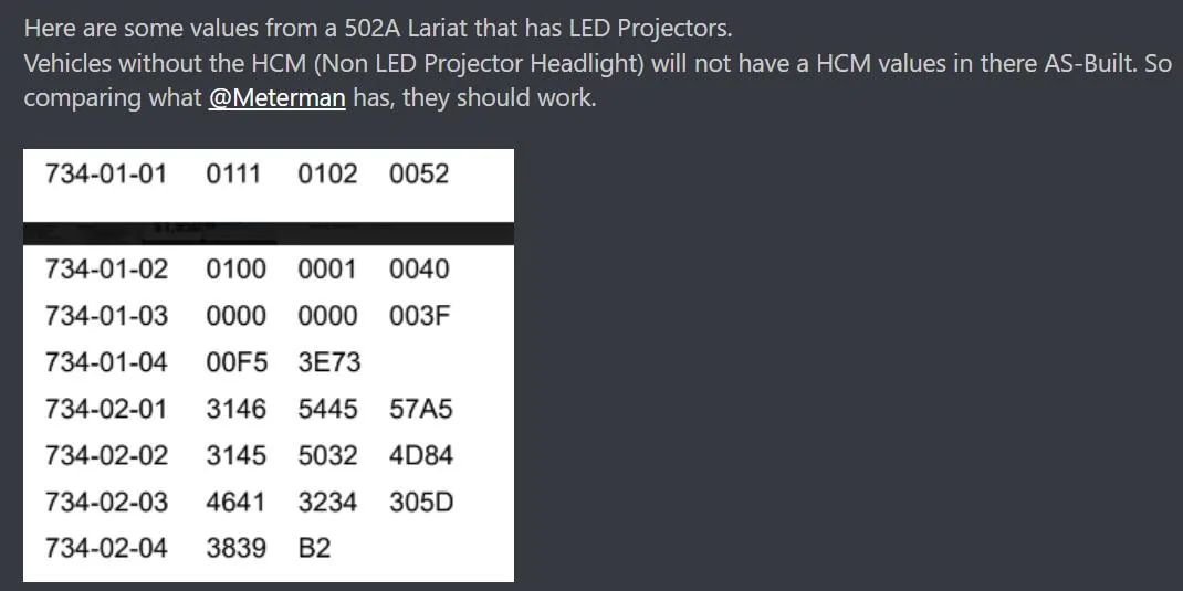

Now look at what another member posted in this thread here for another 502a Lariat:
LINK TO POST HCM AS BUILT 502A
Ford F-150 First tow and my auto leveling lights were blinding 1738882417339-zs
Notice that 734-01-01 reads ***-0102-*** which I guess references "Analog Input" and high beam ramping set to "not allowed" The question here is, not sure if that 502a truck referenced as CCD or not.

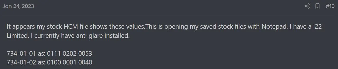

In that same thread referenced in the above link, there is one person with a Limited truck that chimed in. My understanding is all Limited trucks have CCD:
Ford F-150 First tow and my auto leveling lights were blinding 1738883069973-wq
Their line reads 734-01-01 ***-0202-*** which according to the FORscan sheet means it set to "CAN INPUT" like mine, but High Beam Ramping "not allowed".
So what is the deal here? Does having CCD set the headlamp leveling on with "CAN INPUT" like my truck and the Limited truck show? The non-CCD truck have "analog input"? However, whatever Highbeam ramping my truck is set to "available" and the other trucks referenced are not allowed.
