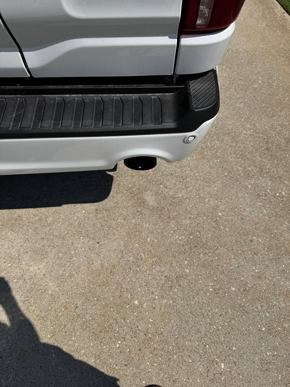

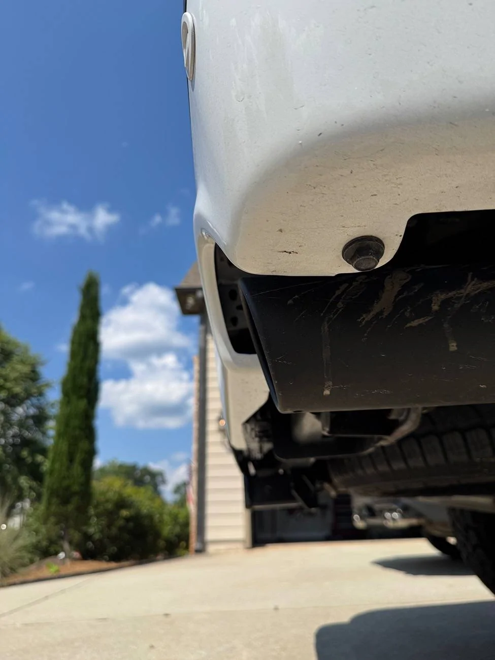

Hey all: 2025 Powerboost with the factory dual exhaust. The factory tips are recessed up under bumper much more than my liking. See pictures. I really want to get them adjusted so that the tip sticks out further in the cutout. I see where the black tips are bolted to the tailpipe, but it looks like a flared fitting and I don’t see any adjustment. Has anyone been able to adjust their tips further out? Do others have this same condition? I’m not afraid to start wrenching on it, just figured I would check with the masses first before I waste time trying to get an adjustment that isn’t possible.

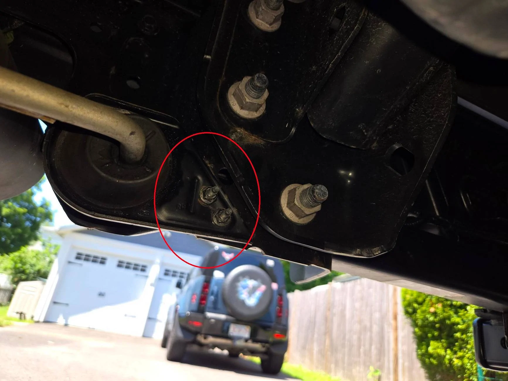

This is the tailpipe bracket people think you can get a lot of movement out of.
The circled 10mm bolts allow MAYBE 1/2" of side to side movement of the tailpipe, even less up and down. This does not allow for depth adjustment of the tailpipes.
Tony, you stated it better than my message - moving only one tip is not possible I think ...
