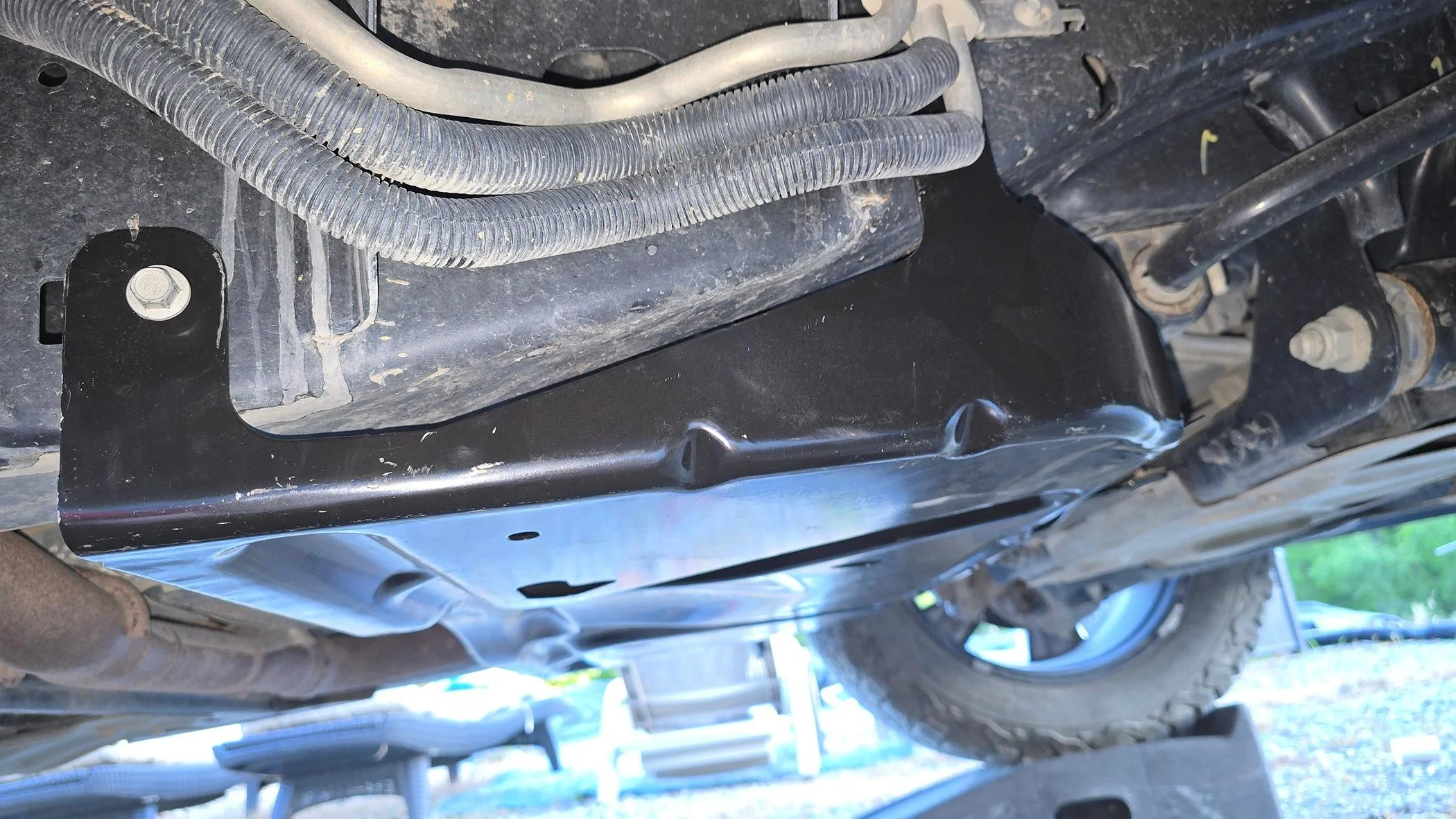

So I installed this today on my 21 Powerboost. The front passenger side is nearly impossible due to the coolant lines and crash bar. I unbolted about 3 of the coolant line clips and it gave me some play to where I could get the bolt in there, but could not thread it in enough by hand to get my self enough room to get a socket and wratchet on it.
I ended up just removing it all together and just have the skid plate bolted on with 3 of the large bolts and the two 8mm up front. Its penty stable.
So for those of you with a PB, I would just skip the front right side. This could have been a 30-minute job and I spent about 1.5hrs just messing with this one corner.

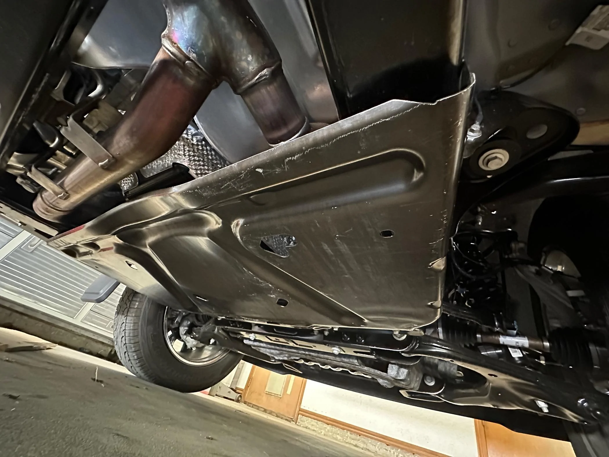

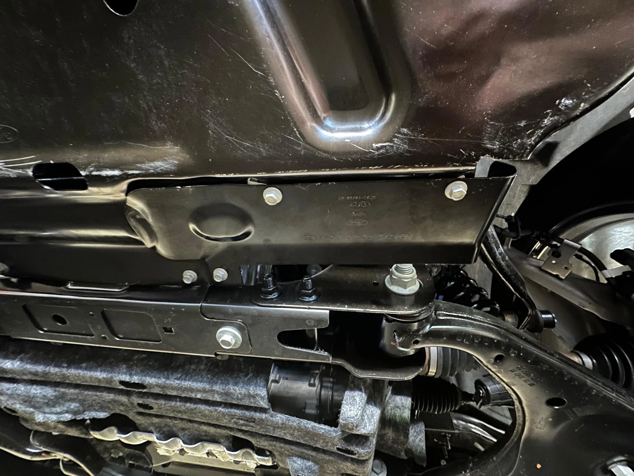

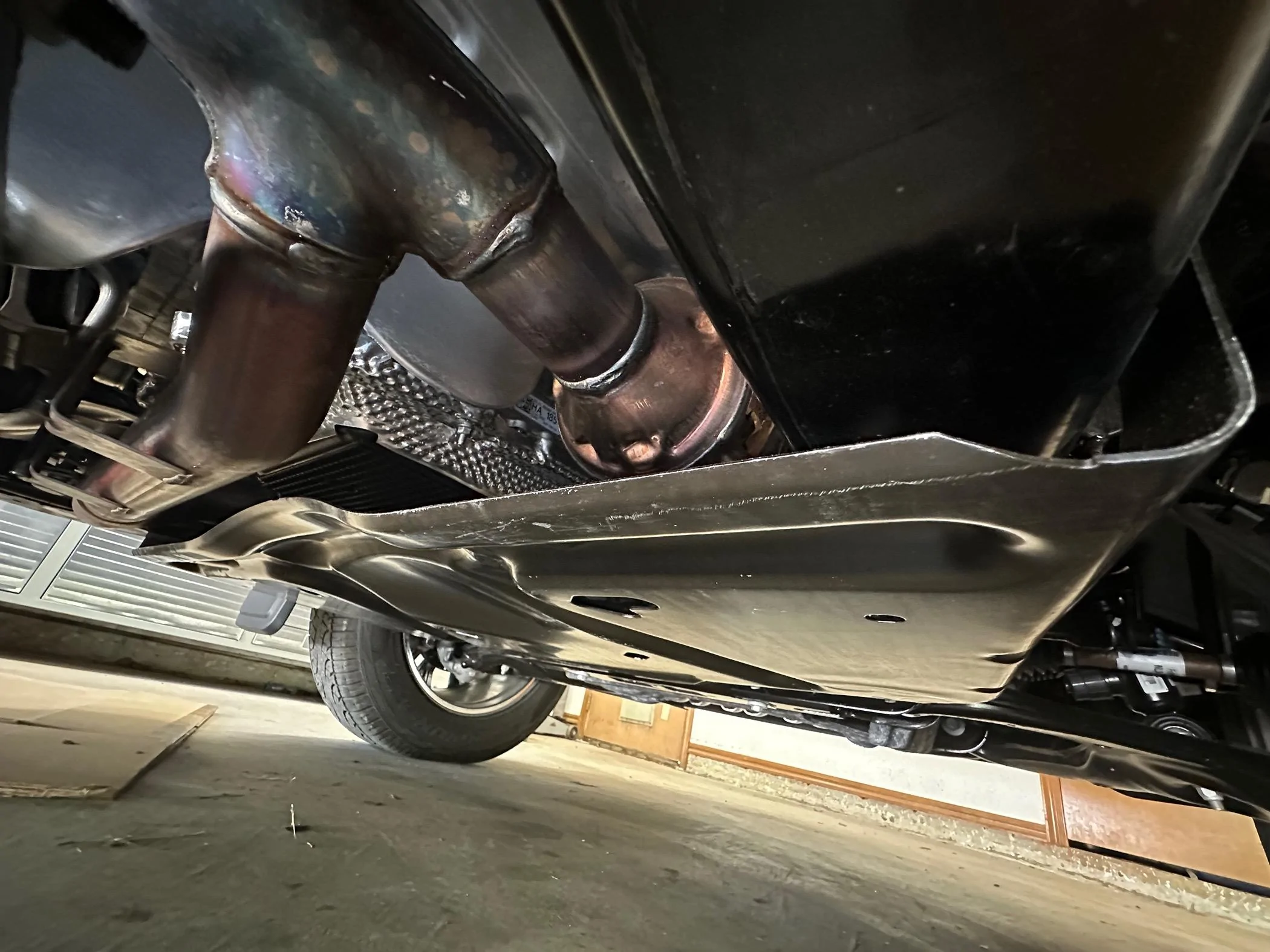

My 2024 did not come with anything covering the transmission pan or cats. I installed the Ford metal plate & oil access cover…will help with peace of mind in the event I encounter road debris. The Ford plate is certainly solid and sturdy.
