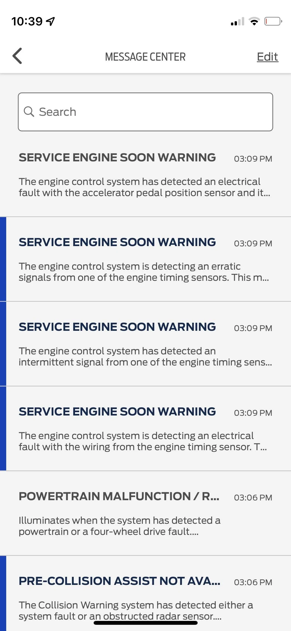

Has any one gotten this error my new 2022 f150 lariat stalled and gave me a bunch of electrical/ engine Errors. I’ve only had the truck 25 days and it’s now with ford technician who don’t know what could be happening. Supposedly ford is send an engineer to look at it ? I haven’t gotten any other answers.
errors are powertrain malfunction/ reduce power, service engine aircondioner malfunction. Amongst others.

Wow it seems like it’s happing to a lot of people. My truck has been at ford now for over a week and they still don’t know what’s going on. The last update was that they are sending an engineer to determine the problem.

Yes they replace a module in the computer and the truck is now running great it was with ford for 10 days but they resolved it
