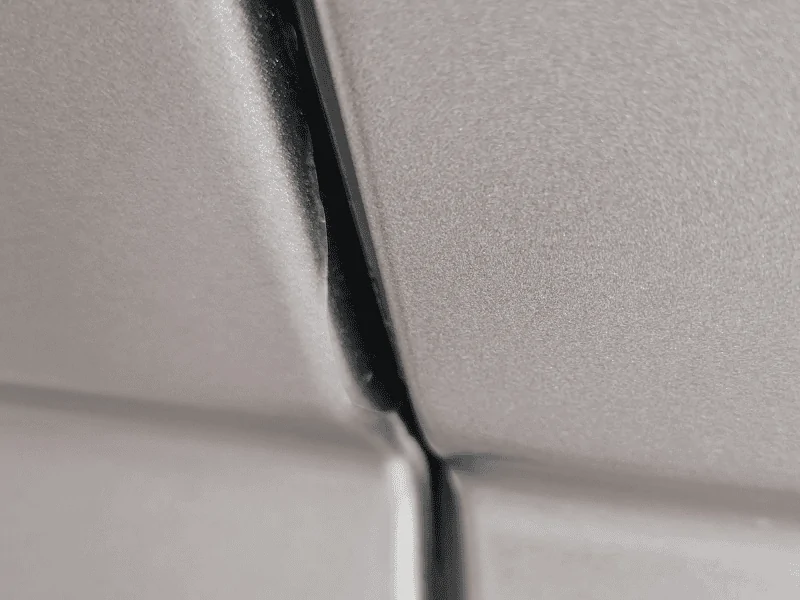

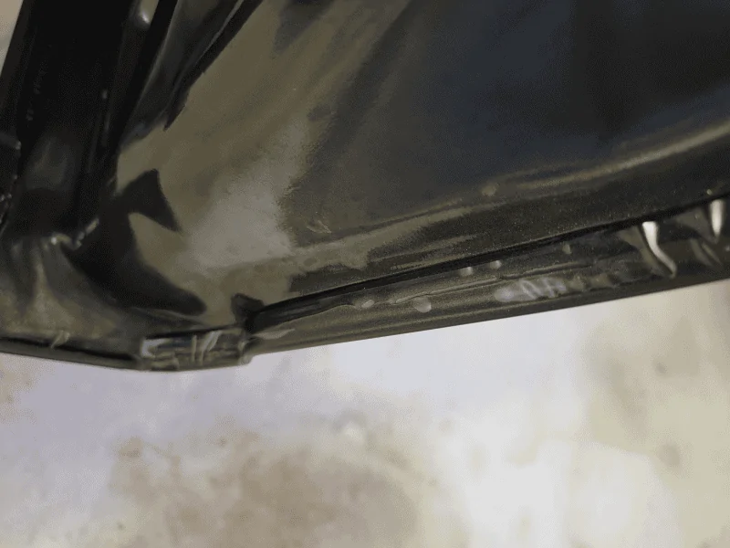

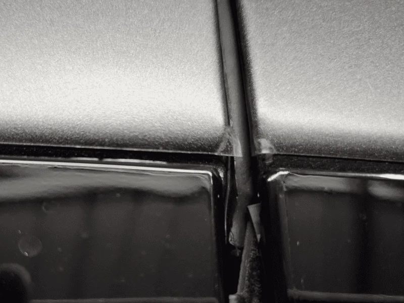

Figuring a complete PPF wrap seems to run $6,000-$8500 for an F150, what should someone expect on the finish. Would the following be tolerable or would you want the pieces repaired or replaced? There is some vinyl, but mostly matte PPF.

Oooh -I did some PPF wrapping myself- and I'm no pro but my edges don't look like that; I'd say you have a right to have those pieces replaced.

That's what I was thinking... and I have about 30 pics of different similar looking spots after they've had it twice for over a week. First to install it, then another time to fix issues. Yet, there are still numerous places with issues. I'm not sure they can get it right. Very concerned considering what I spent.

Pretty sure my installer would throw up looking at these. This looks downright unacceptable compared to the fit and finish of my job. When my truck was in for detailing, he offered to redo minor lifting under his own analysis and determination that was way more minor than what’s in these pictures.

Yeah... I said 30, but I just counted 40 pics I took over the last couple of days of issues... and one video of a larger issue. Bad cuts with jagged and peeling edges. I actually talked with the PPF manufacturer and they said if properly wrapped and glued, it won't peel. It's normal to have a spot here and there, but not this many, especially after already repairing about 50 spots, some of which are the same issue points.
I'm somewhat bummed out because I now have doubts that they are capable of fixing it.

Who did your PPF? Stevie Wonder? To me, that would be totally unacceptable. This was done by the same guy that told you that you were missing a piece in your roof channel?
I would've walked as soon as he said that.
When done right, you shouldn't even know it's there except for maybe a seam. Also looks like he did cutting on the truck.

A hack job of epic proportions. If you paid anywhere what you mentioned, first, I'd be sick, and second, hoping you paid with CC and pursuing a chargeback.

This is Not acceptable at all. I always cover all my vehicles with PPF and based on these pics, they have not done a good job. They need to fix it

Man, I am sorry to see this happened to you. This is complete hack work.
I would ask for a refund and removal. I would not want them to have a chance to fix it, a real professional shop wouldn't have made those mistakes nor let the vehicle leave looking like that, much less have it looking that way after a couple of returns. My concern is they have cut the underlying paint by cutting the film on the vehicle in places, something you may not see until the film is removed.
If the business waffles making it right, I would:
1) Tell them you will post it on all social media sites so that customers can see the work, and follow through
2) Call the film manufacturer and ask them to send a field rep out to review it, because you'll make sure to highlight this was a "certified installer of Kavaca" and that Kavaca didn't help make it right when made aware on every possible platform
3) Contact BBB, the local newspaper and news station saying you have a rip-off alert for an automotive business
4) Investigate a chargeback to the CC (I believe you would likely lose as this may be classified as a service)
I, too, had a hack job on my vehicle, upon removal I found they had cut the paint in multiple locations. The shop's insurance ended up paying to have ~$9k in repairs. Had they not turned it over to their insurance, I would have likely pursued it as a comprehensive claim through my own insurance (at my peril) while dragging them through the mud with the photos. Your photos are also very damning.
