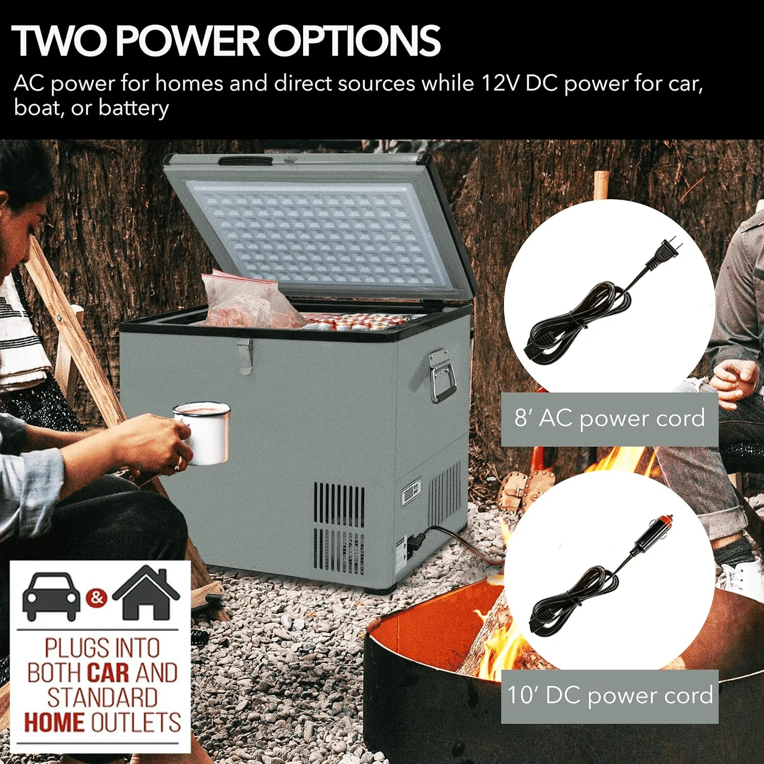

I have the Whynter 45l (FM-45G) fridge/freezer and it runs right out of a 12v receptacle. Using a 600w power station it can go for at least a day. Never have to touch my 2kw outlet in the bed. Has a 110v adapter, if needed. Bought the first one in mid-2022 for $325 (Amazon Warehouse), the second for $400 in early 2023 (Warehouse, too); new, it's $500 on Amazon (so the price has been holding). Go here if interested: https://www.amazon.com/gp/product/B002W8BLUG
Here's the Whynter:
Ford F-150 Electric Fridge in F150? 1708608027166

The Change Moore works pretty well, but we like the Whynter much more. Yes, the Whynter is more expensive and is heavier. But it's built like a tank and - wow - does it do its thing! And the optional cover is great.
If we need both a fridge and a freezer we use both Whynters (the Change Moore is riding the bench for "just in case"/back-up purposes).
Doesn't quite answer the OP's question, but thought it might be useful info....
Cheers.

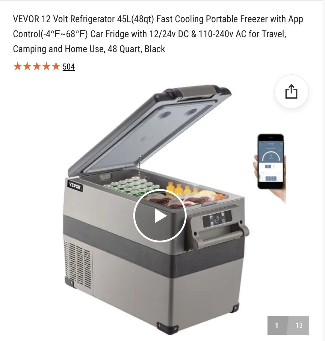

This is what I’ve been using for camping and overnight trips. Operates either as a fridge or as a freezer. When camping , it runs on the trucks pro power to freeze ice for the coolers, so it’s set it the lowest temp. At night, I switch it over to a 12 volt 18 amp lithium battery. For the most part it will operate around 10 hours on the battery but it depends on the air temperature inside the truck. I recharge the battery with the truck during the day. Very happy with the unit. Although I would suggest a larger battery .
