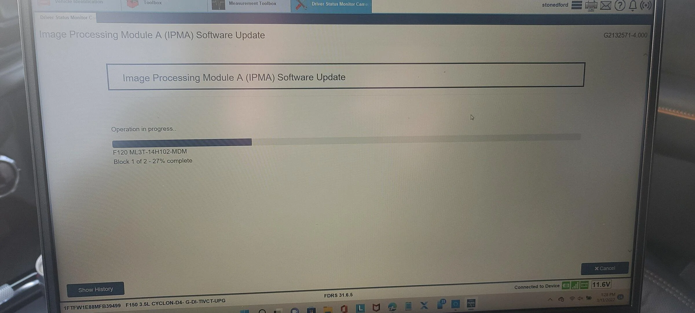

Also, do you have a charger on that battery? Look at your voltage! If your charger supports 20 amps switch it now!
Yes I have it on power supply. I just switched to charge at 20amps.
Which charger do you have? The recommended one and if so, you had it on Power Supply mode and not charge mode?

I have the reccomended one and yes I had it on power supply. Is that wrong

Its bouncing back and forth between 11.5 and 11.6. I have it on agm 12v 20amp
No. If your charger has a power supply mode, that’s what you want. The name of the game is to maintain constant voltage when flash programming. Unfortunately, battery chargers are designed to keep amps fixed but vary voltage. Power supplies do the opposite—they keep voltage fixed and allow amps to vary. So, if you have a power supply mode on your charger, use it! If you don’t, make sure you start your programming session with a fully-charged battery. Don’t rush the process.
What's the charge reading? You won't get to 100% and your voltage will come up slowly as your charge comes up....

Im now at 11.7 with it on power supply
Power Supply mode is not maintaining the voltage, switching to 20 amp charge will get him back to where he needs to be. 11.6v is dangerously low...
