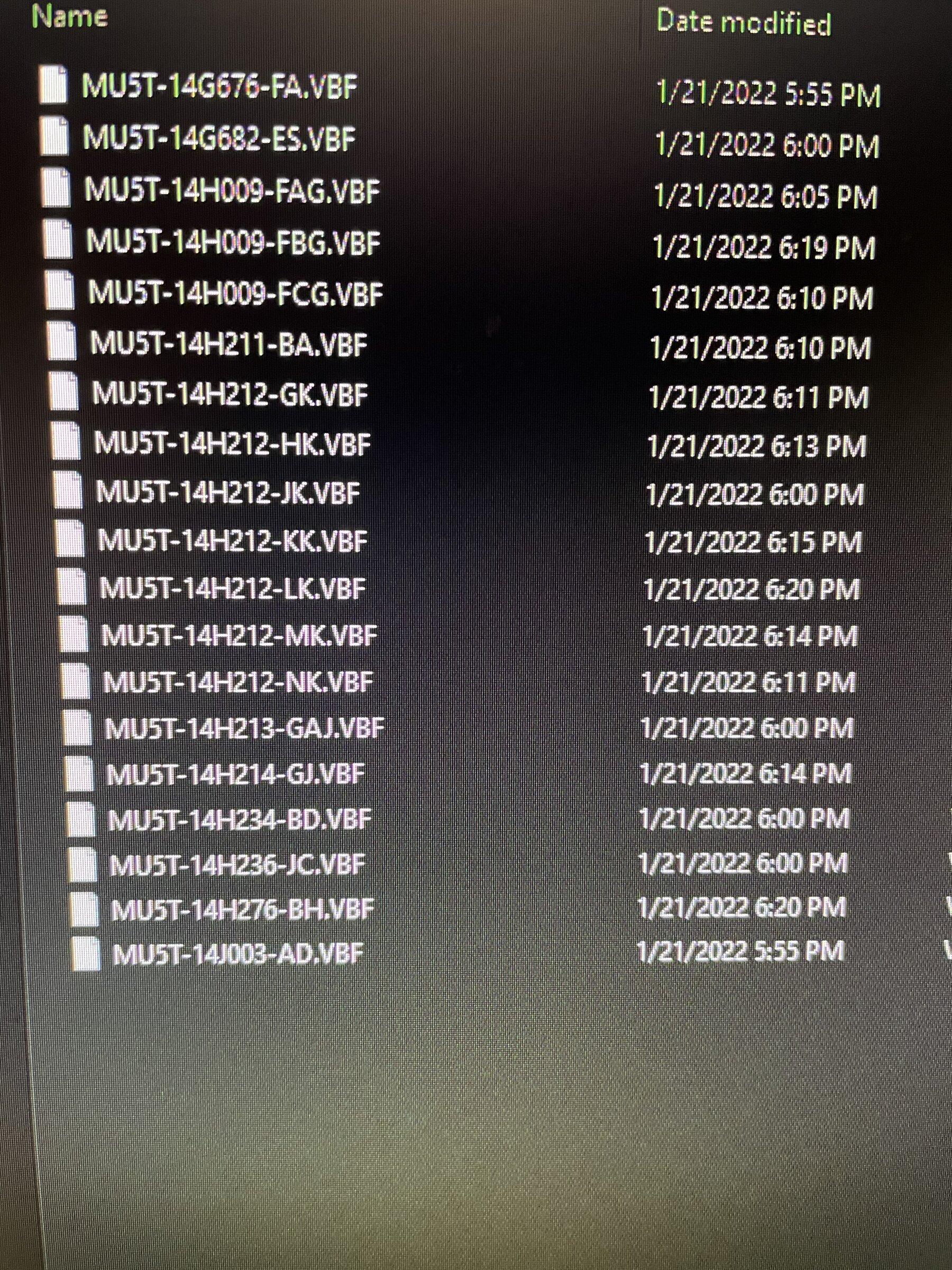

One question I do have is within FDRS my APIM update won’t run either… nothing displays on the screen… not even the “Do Not Remove the USB” warning screen your supposed to get. Not even after 1 hour of the vehicle running.
I did get update 1.6, then 1.4 automatically via the FordPass app notification about a month ago. I believe the 1.7.1 failure applies to me with not being able to select auto update or schedule updates etc.
What were the file names in your USB key made from FDRS? Mine have “14” in the name. Is this supposed to reference like ver. 1.4 in all of them??

I noticed that your APIM update has a little bit different file manifest than mine. I would assume since FRDS reads the onboard APIM first, and then downloads the proper Payload for the update, that your truck requires a bigger jump than mine?
My truck had received the 2.1 OTA before I did the FRDS. I might have successfully gotten the 2.3 OTA if I were patient enough?
