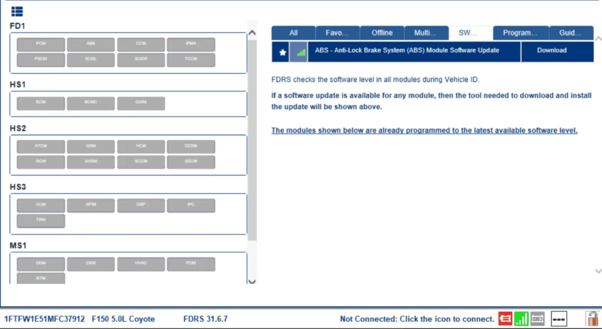

Last week I installed the ABS update successfully. Why I am getting it again?
Ford F-150 ECU module programming guide using FDRS 75042ABA-E800-4A95-8B28-093EB13EB795
TJSparky
Oct 18, 2021
525
473
WA
The ABS and GSM modules appear to be stuck in the SW updates page after they have ran. Hopefully Ford will realize this and fix FDRS to clear them out. If you ran them that’s what matters.

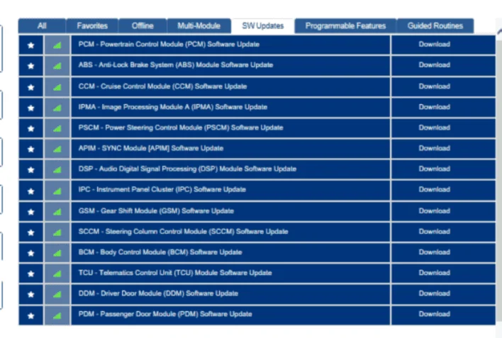

So for 302A owners that recently got the new updates did you all get to 22095? I'm still stuck at 22087 with no further APIM update showing... ?‍♂ (8" cluster, yes 360, no adaptive cruise)
TJSparky
Oct 18, 2021
525
473
WA
yup…. I am at 22087 as well.

Looks like they tried to update the APIM yesterday and it failed. But they did apply some other updates in the previous days (TCU May 2nd, a lot on April 28th (DDM, DSM, PDM, IPC, TRM, SCCM, GWM) so it's not like nothing was happening.
