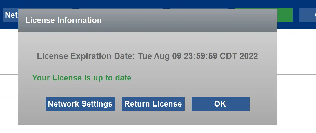

Be carful with your FDRS licensing as well. It is tied to a specific machine I believe and if you’re changing laptops you need to first remove the license from your laptop and put it back on the cloud. FDRS is only allowed to be activated on one machine at a time, To manage your license go through the license management tool in FDRS. I’m not sure if uninstalling/reinstalling will also mess with the licensing but if it does and you didn’t move your license first you will need to call Rotunda support for them to free up your license so you can reactivate your FDRS.
@abd79 great point... you must return the license before removing and reinstalling FDRS. This is also same with Forscan and IDS. Each installation creates a hardware signature that is unique to that install and is never the same with sequential reinstallations. I learned the hard way with using IDS many years ago when I updated my laptop from windows 8 to 7 Pro.
Thank you for that! Didnt know that its tied to the machine. You probably saved me another massive headache in all of this! Thanks!
THere is a release license in the FDRS when it asks you to log in.. Select release license and in 15 mins it will be available for another machine.. THis was a good catch though and glad someone mentioned it. If you didnt do it prior to erasing FDRS then reinstall and then do it
