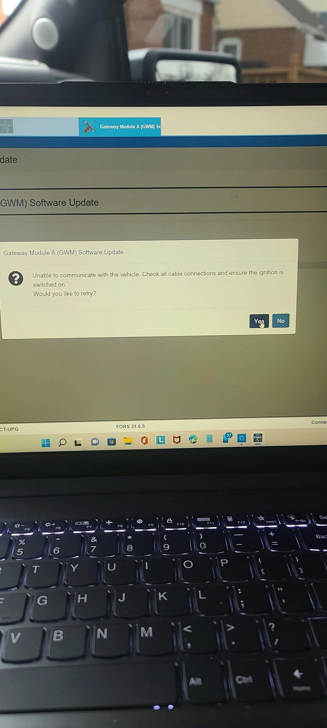

Anyone know why this keeps happening? GWM does this too. I updated the IMPA, PSCM, and GSM And they went through but they won’t leave the list either. Just stay there with a green Run button next to them.
Typically if an update involves multiple modules and fdrs doesn’t run through them all sequentially it claims the update ended in an error state because the other updates didn’t run
Not sure if what I said made any sense
People are also NOT paying attention to the posts in this thread where some modules like posted by @Platinum Peasant will still show up even after a successful update. I am personally getting hammered via Conversations from many and they're thinking a PMI is going to resolve the issue.
