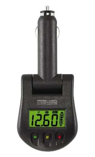

My first bet with any newer vehicles would be the battery. If all these modules aren’t seeing 12V at most times, all kinds of electronic gremlins will begin to appear.
I use one of these for quick diagnostics and to check battery health on startup:
Ford F-150 ECU Failure 534E584C-930A-4831-B5C1-E094E39BF4F2
Many have experienced loose connectors and crimped wires too.
