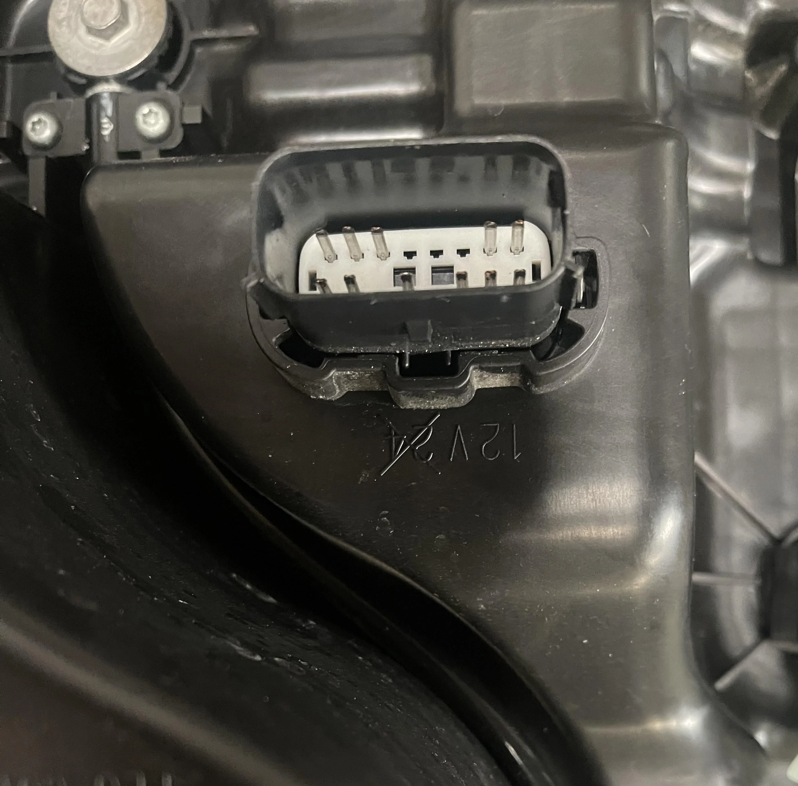

2021 Lariat. Looking for pin out information for Dynamic LED Headlight. Have seen some schematic diagrams showing some of the wiring. But nothing showing pin connector terminal wiring.

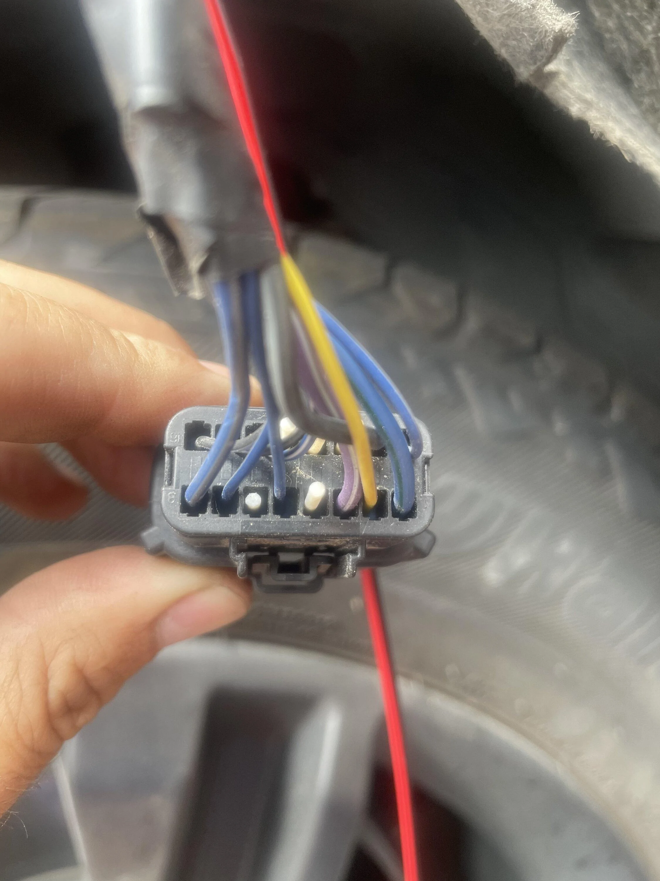

I’m looking for the write on this too. I’m trying to install some side vent lights. Supposed to tap into the side marker lights and ground. But I have no idea which is which.

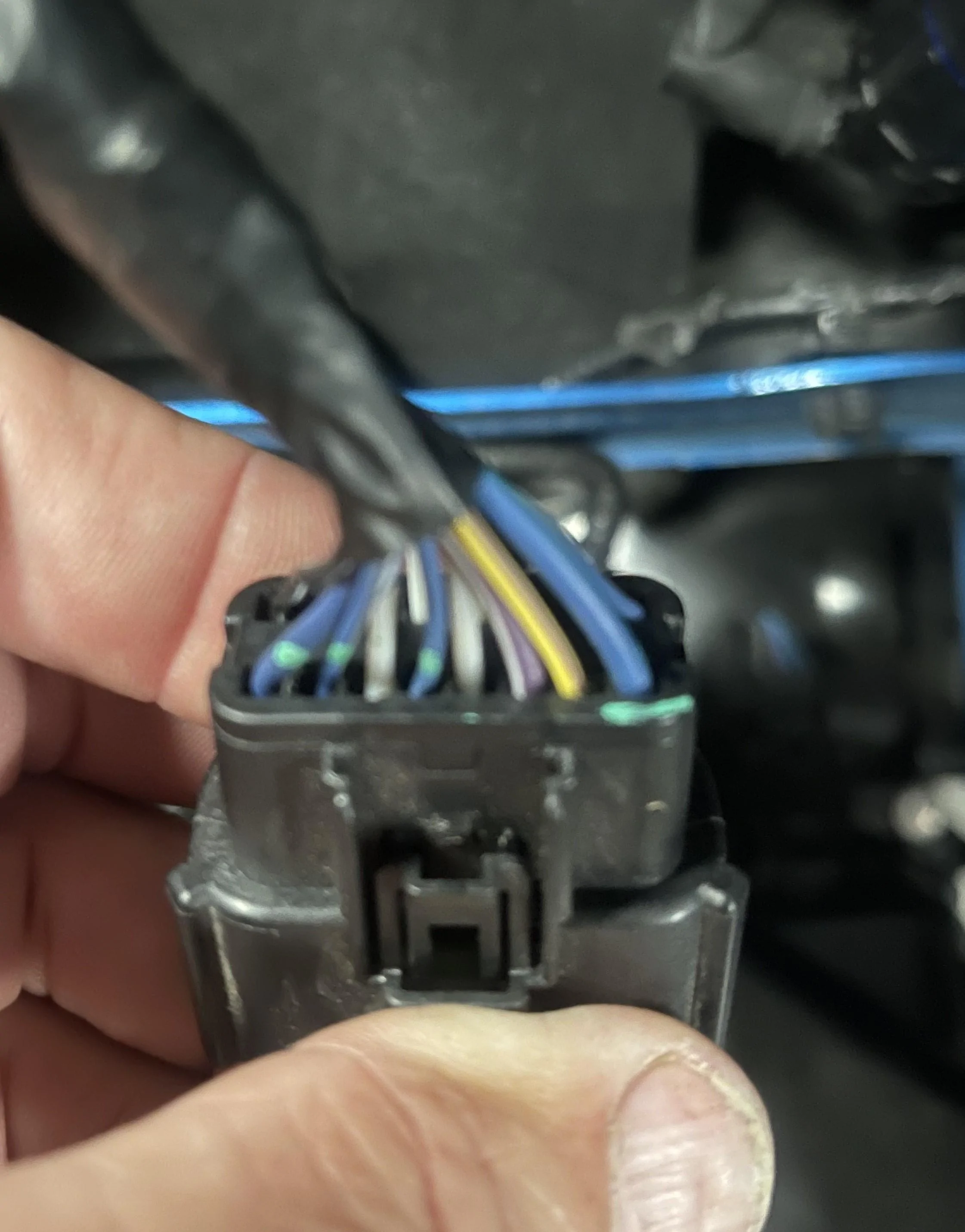

Your wiring appears much the same as mine, as it should be being same the same model.
Having not had any response from asking the same information on a few forums. Ended up pinning out what I could.
Left hand headlamp female connector.
Ford F-150 Dynamic LED headlights pin out diagram 1660073593342
1. Blue (large) 12v switched on low beam and high beam.
2. yellow/brown (medium) 12v Indicator.
3. Violet/white (large) 12v switched on park lights (side) + 12v on LB & HB.
4. Not used.
5. Blue (green dot on mine).
6. Not used.
7. Blue/white (green dot on mine) 12v switched on park lights + LB. Times out on auto light position after a number of seconds.
8. Blue/white (green dot on mine) (medium gage wire) 12v switched on park lights + LB. Times out on auto light position after number of seconds.
9. Blue Not powered ( yours should be) lights up centre amber bar on headlight.( I am in UK disconnected for construction and use).
10. Black/grey (large) - Earth.
11. Not used.
12. Not used.
13. Not Used.
14. Black/White.
15. Black/White - Earth.
16. Black/White -Earth.
Not sure on 5. and 14. Possibly to do with CANBUS so was reluctant to power test Headlight side with 12V for possibly causing damage. 15. and 16. may be CANBUS Earths.
Need to check feed to DRL in fog light to see where it connects a circuit with any of above to work out between park and DRL.
The above is only a guide to assist with anybody checking their own wiring at their own risk.

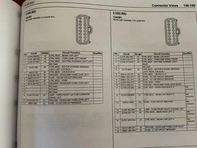

Since posting the above pin out. I have acquired the 700+ page wiring Bible for the 2021. This may help more. On my sketch the pin numbering is different to that below. Using below the turn signal is No 2 for both LH and RH.
