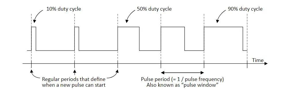

Nah, it's aesthetics. The overall light on the projectors is slightly smaller housing, the XL/XLT/Tremor is a bit smaller still. The DRLs are going to behave in the same manner. The interesting part is that my understanding is that the BCM FET controls the brightness by its frequency so not sure why the DRLs burn out unless the module on the bottom is actually handling it. I haven't scoped the DRL line from the BCM to see if it's controlling it directly or not. All other dimming lights is done by the BCM via PWM unless it's controlled via LIN. As the light fades out you'll see the flicker, where brightness is achieved by turning the power on/off fast creating a dimming effect.

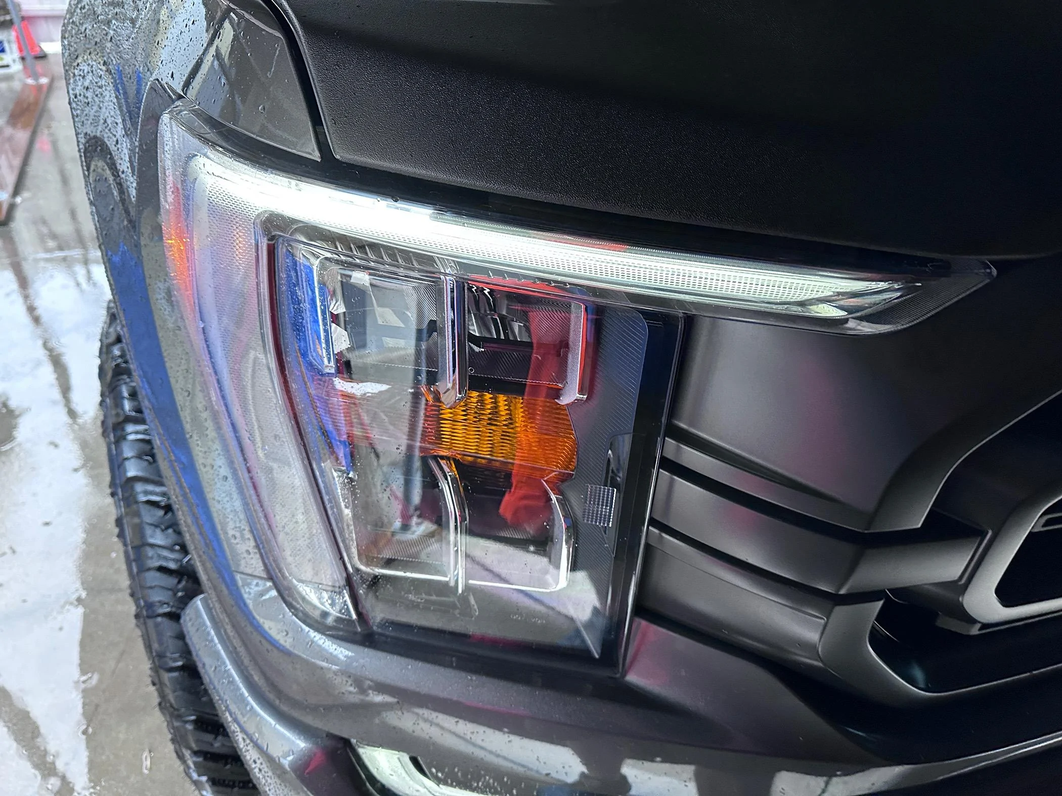

It happened to mine too,it’s at the dealer right now but I still under warranty so they are changing it for free.
