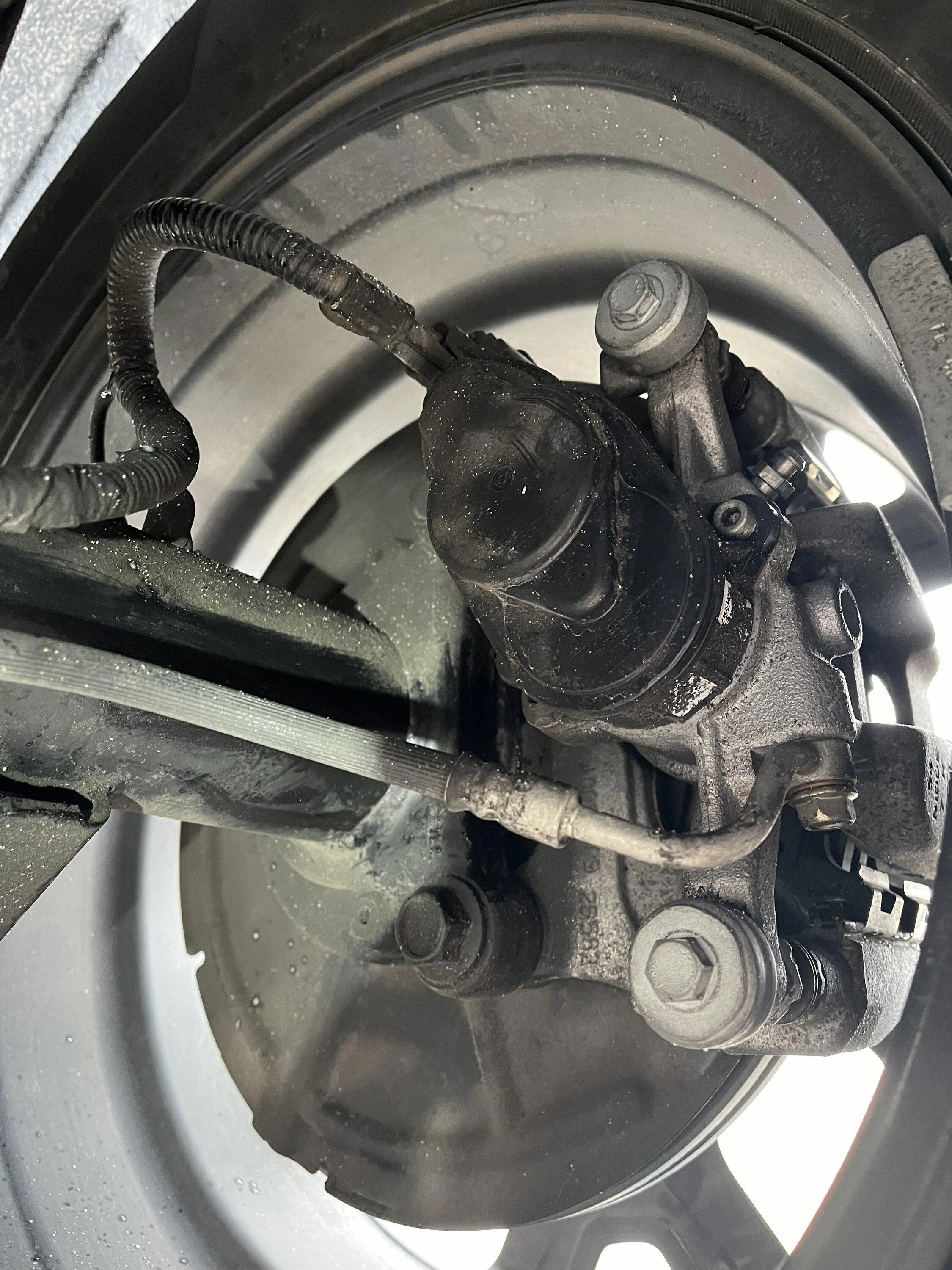

Well I got my truck back and the passenger rear caliper clearly has been cleaned with brake cleaner suggesting they flushed from the corner (see first pic) that caliper is also now missing the top rubber/plastic cap on the top of the caliper. Do I need to get that cap replaced? Is it a problem that it’s missing?

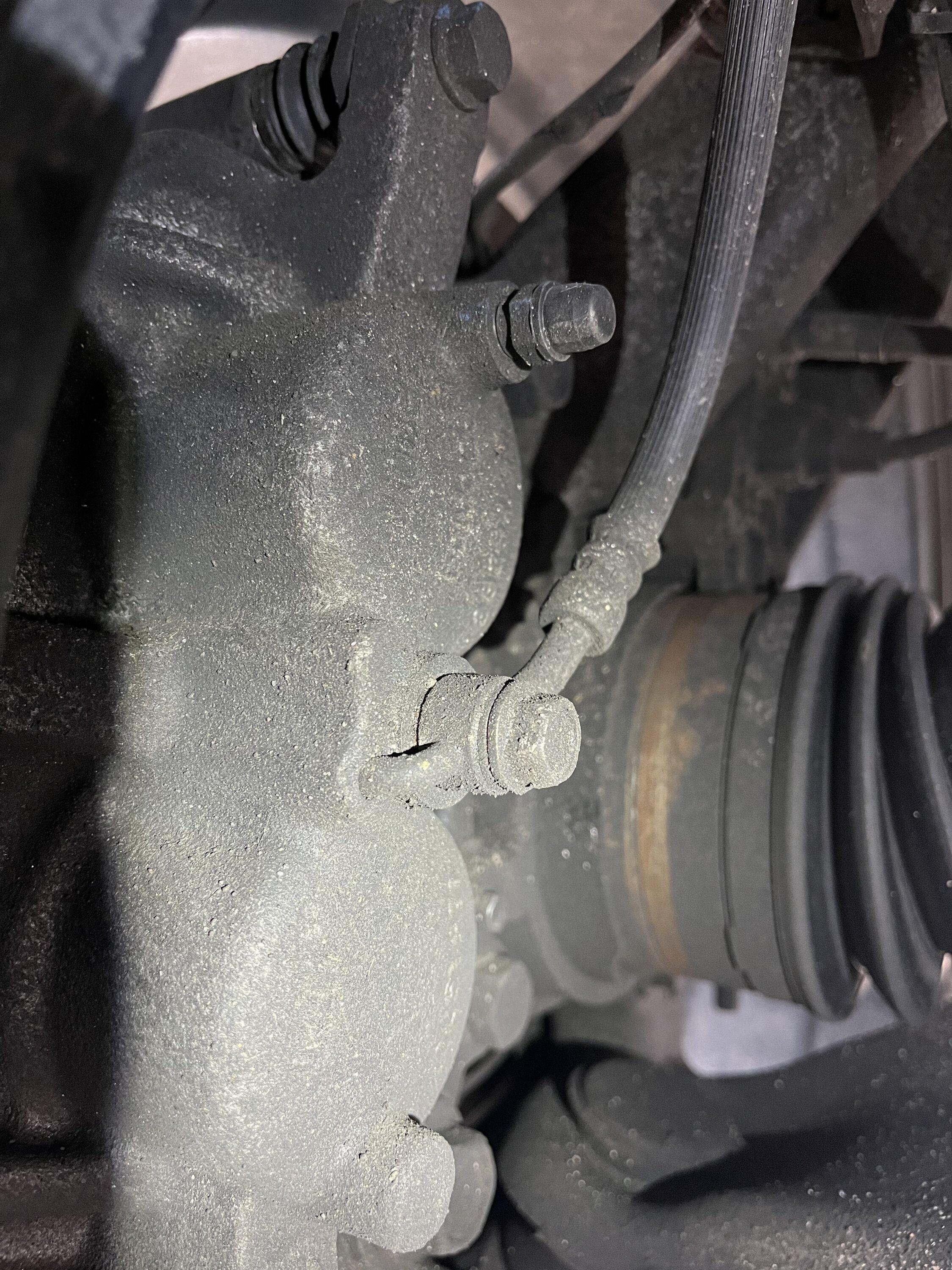

also, attached are photos of the other 3 calipers… they clearly never touched them meaning they didn’t drain the brake fluid out of any of the other lines. This is a problem right? Just looking for some feedback before I demand them to redo their work.
my vehicle has fluid film on it so it’s very dirty, but also very easy to see if something has been touched.
12 years from now that will have become an issue. Lazy, but easily fixed.
This is not preferred; they probably did replace 80% of the fluid by draining the caliper farthest from the reservoir but you definitely got jipped if they didn't do the other three wheels. Good on you for checking.

IMO, a clean caliper does not mean they flushed the fluid.

I wouldn't go so far as to say they didn't do the work, especially given one of the dust covers is missing.
I didn't say they did not do it, I just said it can't be a proof that they did ?

yea you’re right man, it’s not proof they did it for sure, but what it appears happened is they drained from the passenger rear, but not any of the other 3 calipers

Update: I spoke with the advisor and tech and they said they used a pressure bleeder and it connects to the bleed port (the ones with the caps up top), and that they did all 4 corners. The furthest one just looks clean because they spilled a bit on that one and cleaned it up. They’re also gonna give me a new cap for that one that never got put back on. Hopefully this helps other people wondering! I was expecting to see marks on the screw, but they didn’t use the screws just the bleeder ports up top so that’s why the others looked untouched.

When I bleed my brakes, I used a closed wrench, it does not leave marks and you don't round the bleeder. The bleeders only need ~10ftlbs to close them.
Hard to tell, but based on the lack of witness marks, I'm not seeing it. Your pictures aren't really up to inspection quality, but they did all 4 corners and didn't have even a tiny amount of weeping around the threads of the bleeder on the other 3 wheels, while also being able to keep the dust on the caps having both removed and reinstalled them?
that is a good point, I may try to bleed one of them myself and see what color the fluid is
